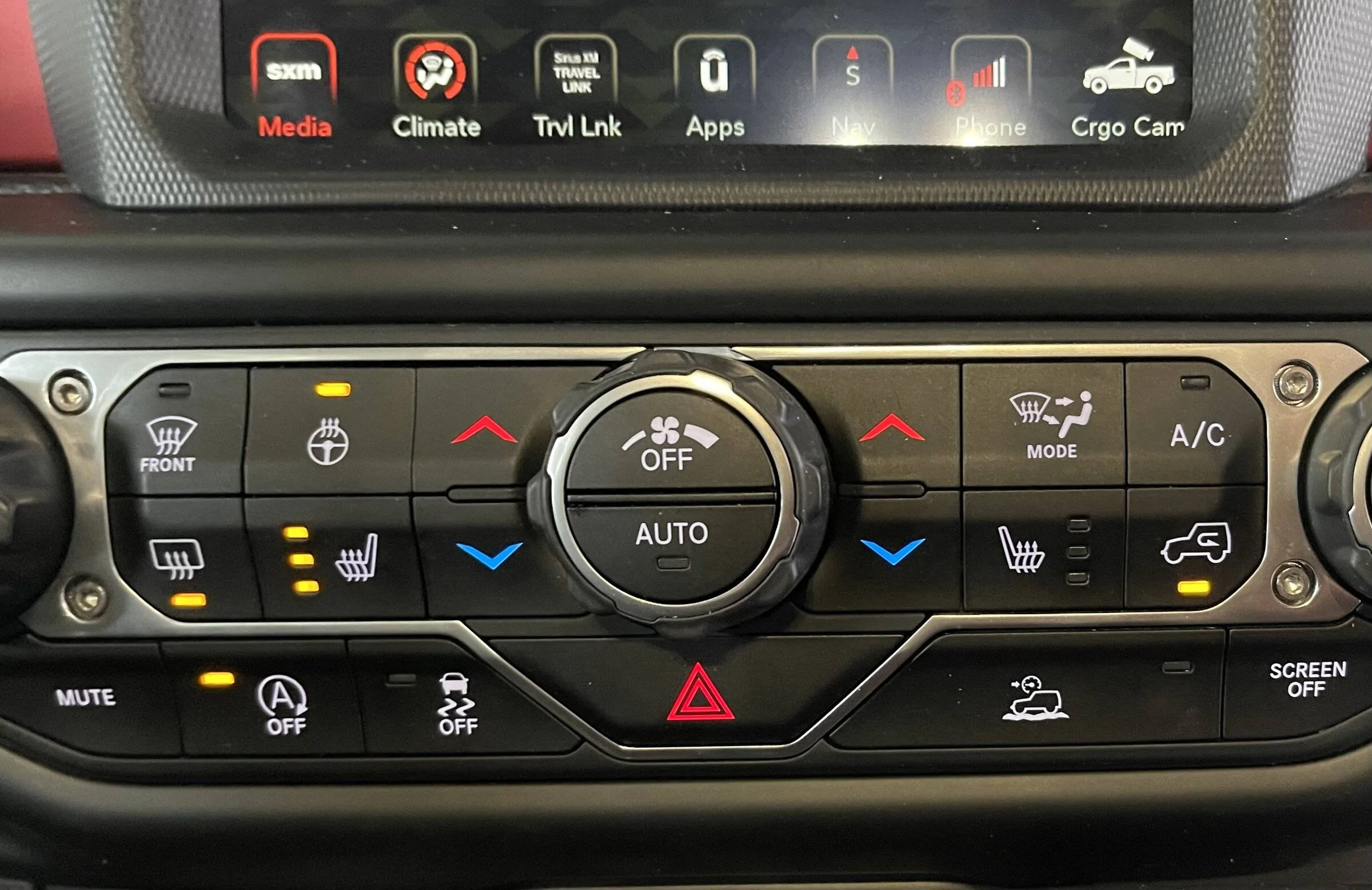

Cold morning here. Good, but not good enough.
The Wrangler's cold weather routine (which does some mild heating on cold mornings) slightly interferes with my own routine. When both activate, I've still got full heat going, full fan, and I'm recirculating air. But the heat is coming out from the floor and the windshield, which seems less useful than when it comes out of the main passenger vents.
Jeep Wrangler JL JEEP HACKING CAN-C / CAN-IHS / UDS ! (Reverse Engineering) IMG_1397
Unfortunately, this makes a 20F cabin interior just a little more than 65F before the engine shuts off. It needs to be better. Now that I understand more of UDS, what I need to be doing is directly setting the conditions I want in the HVAC module (instead of simulating a person pressing the buttons I want). It's going to be quicker, and it's less susceptible to pre-existing changes in state.
Time for me to move on to version 2.0 of the remote-start HVAC controller which uses UDS messages instead of CAN messages.
I would let it heat to the windshield instead of the dash. As the Jeep slowly warms the glass it won’t break due to sudden change of temperature. Had a rock chip in my blazer for a few years. Had my dash vents blowing during Remote start. Windshield started to fog up put on the defroster and heard a pop. Cost me a windshield.
A few minutes ago, I replied to your message... a reply that is now deleted. It took an extra minute or two for the significance of your story to sink in. Here's a better reply:
I unhooked my HVAC code, hopped into the Wrangler, and remote started it from the front seat. (Beforehand, I had my HVAC controls set to main vents, medium speed, 76F.) Instantly, it went to the windshield, full fan, full heat. Six minutes later (nothing had changed), I pressed the ignition button (telling the vehicle I'm actually here), and the HVAC returned to my previous settings.
You know what? I think you've given me a much better perspective on what's happening and why. If the HVAC never comes on when you remote start the Wrangler, except in one particular known case (below 40F), then it must be doing this for a very specific reason, and it isn't creature comforts. You've driven home a very solid reason, so I need to respect that. When the windshield is cold enough, you have to prep it with heat if you want to reduce the chance of cracks forming.
As my code stands now, the way it acts (in combination with the Wrangler's low-temperature windshield heating) is the same as factory behavior, except it splits part of the air to the floor, and it turns on air recirculation. That should be good enough (and way better than my original plan of going to passenger vents). In other circumstances when it's cold (but not cold enough to trigger the Wrangler's windshield heater), then my code will blow full-blast on the cabin. (And the same during hot weather, except, with A/C.)
What I'm seeing the Wrangler doing is coming together with what I learned from your story, and now this all makes sense. Thank you! Windshield prep will continue. (And this serves as a personal reminder not to write things off as "crazy behavior" just because I don't understand it.)
