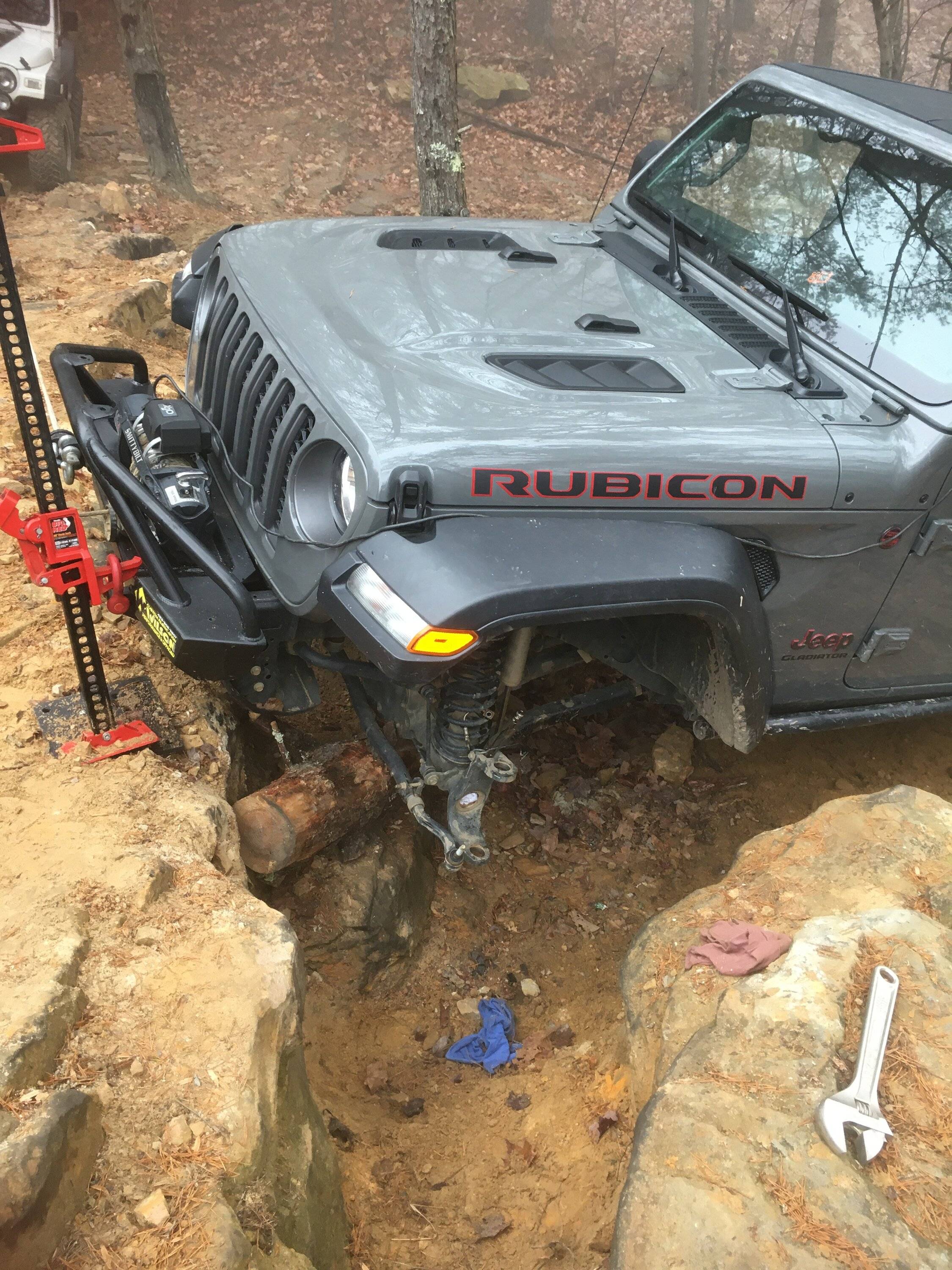

I feel like there's a story here.....
Trying to climb the ledge and got left front wedged in an undercut section. Popped the u-joint. Tried to keep driving 3WD, and the axle shaft yokes bound up and popped out the ball joints. Had a ball joint press delivered and made the repair. I was stupid for trying to keep driving, but fortunate enough to be close enough to town that I could get the press delivered to the trail.

it was a reference to an earlier post in this thread that Remorseless made which refers to the front axle U-joint size. OEM JL/JT is 1310 size and the Dana chromoly axles for the JL/JT D44 have 1410 size U-joints. Basically, 1 ton axle U-joints. But you got me on the PSL acronym.

No doors, loaded with passengers, noob driver, dangerous obstacle, inadequate parts, alcohol…This could have been horrific. Years from now the driver will appreciate how much of a bargain this lesson was.
