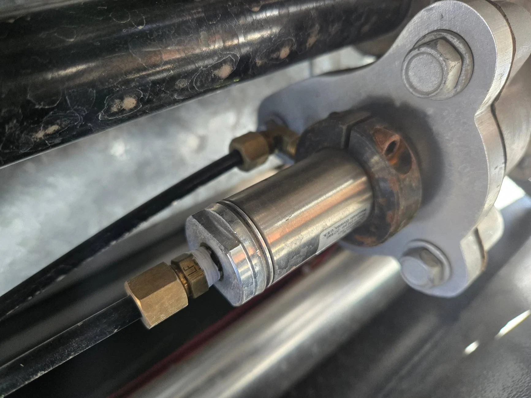

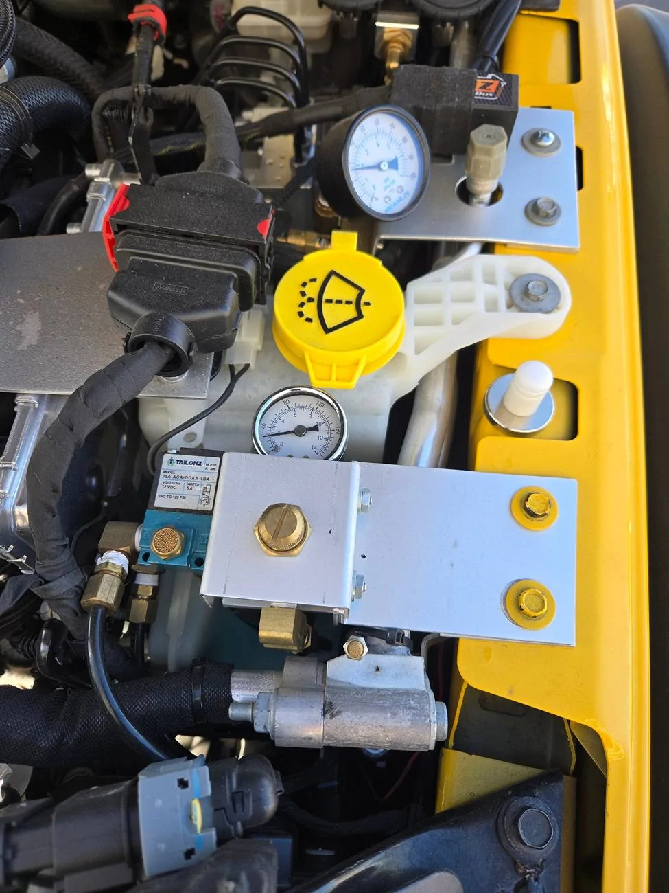

Looks like the $100 one is gone put here are 3 between $300 to $500.
I got mine at a 4x4 shop for $300.
Make sure you take it apart and clean and re-grease.
Because I went pneumatic and can regulate the air pressure I added a stronger return spring.
I think I am running about 60 psi.
I did a bench test to find out what psi would disconnect the sway bar.
https://www.facebook.com/marketplac...wse_serp:8fe2af6b-193b-4b63-a9e5-2ee819aecd0f
3TV
Jan 7, 2018
42
1,427
3,100
Southwest USA
2022 JLUR XR 392
Great photos!!! Glad yall made it out to the secret camp on green river!
I have friends that run anti-rock and autolynx.. for overall convenience to price ratio autolynx is the way.. most folks that run Mojave have them these days as their first upgrade.. anti-rock does incorporate a bit more sway, but does have the convenience of being able to go from trail to highway without getting out… Since you’re in California and off-road worthy that might be worthy enough for you to invest in… I have a Rubicon and am considering autolynx because the electric disconnect sometimes does not do the job when you want it to. It’s convenient enough to disengage/engage them when I’m airing down or up.
We have an Autolynx on our Mojave. I think an Autolynx on a Rubicon would be nice. It would effectivly do away with the annoying reconnecting of the electronic sway bar every time speed got 1 mph too high.
Willys41
Larry
Nov 2, 2021
1,047
1,072
Pleasanton Ca.
2020 Jeep Willys
Can you send me a link to where you saw one for $100? I have family that live up that way so maybe they could go grab it for me.
Here are some of the parts I used to make the disconnect.
I made my own plate and extension rod.
On the cylinder one port will be to extend the rod and the other will be a vent that needs a hose up into the engine compartment with a filter.
A double acting cylinder is much easier to vent than the single acting one I chose.
https://www.amazon.com/dp/B07N2DZ5FP?ref_=ppx_hzsearch_conn_dt_b_fed_asin_title_33&th=1
https://www.ebay.com/p/23012077228
https://www.zoro.com/watts-pressure...MI___K49fDjAMVwR-tBh3jfj0PEAQYCiABEgIQi_D_BwE
https://www.amazon.com/Heschen-Stai...der&qid=1743952734&sr=8-32&xpid=ItJa2yfdHwiMv
