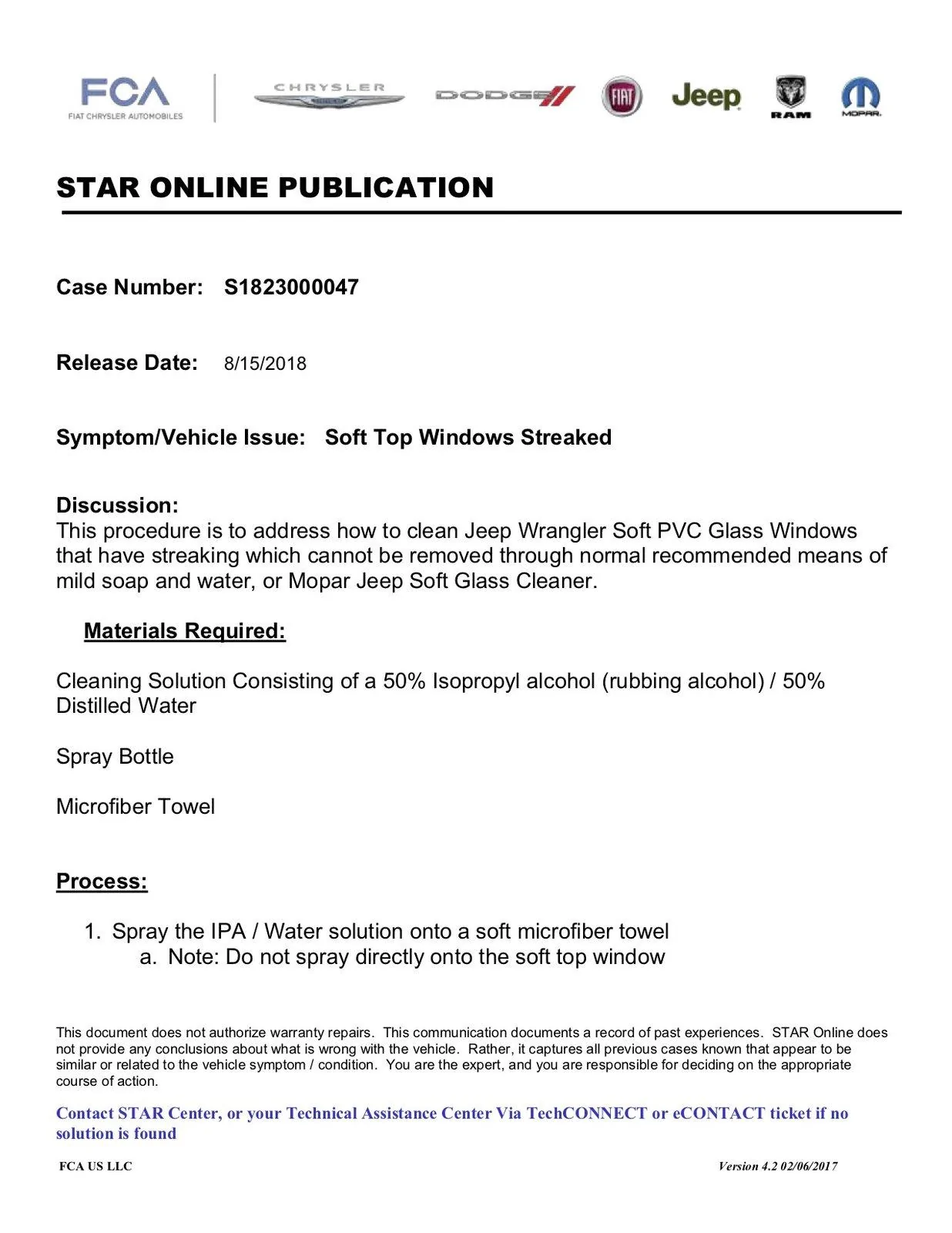

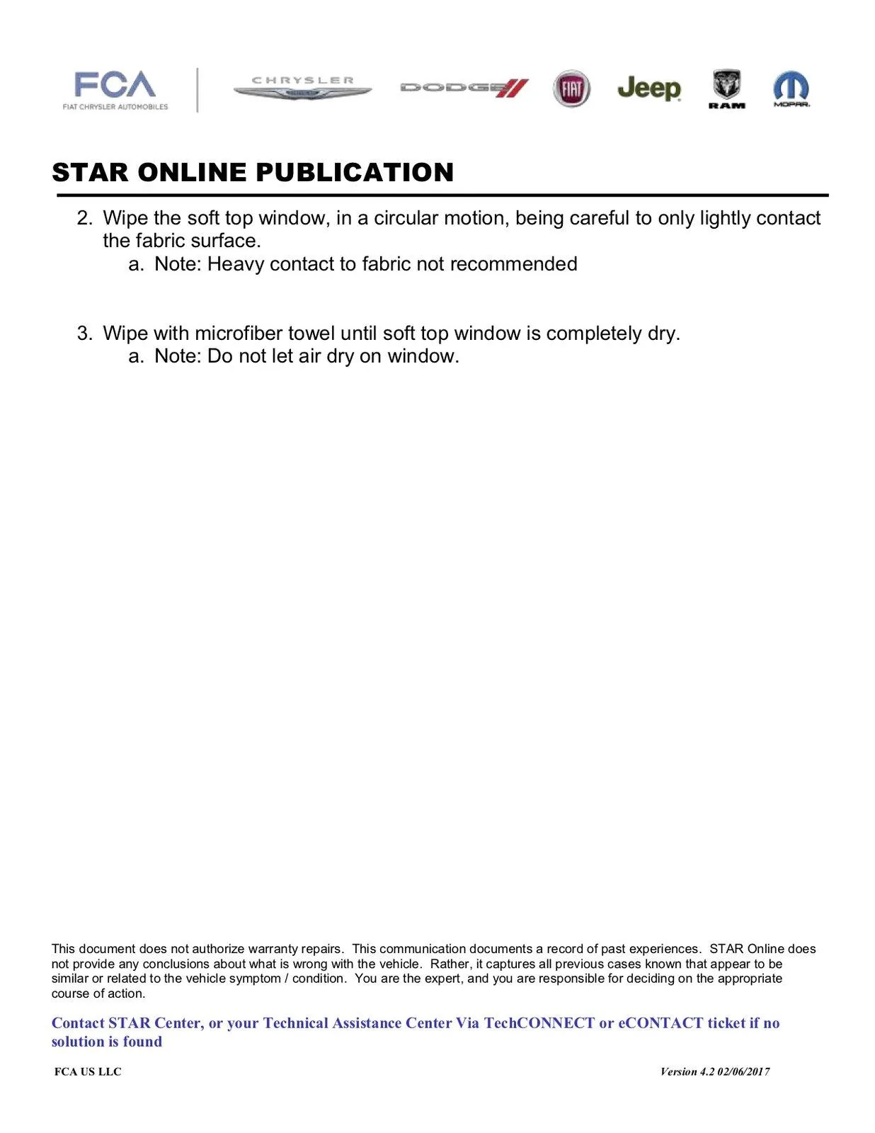

Thanks Rob for this information.Case Number: S1823000047
Hi Tony,I'm having this same issue with my 2018 Jeep with the premium soft top. Streaks are very visible/noticeable. I just took it to the dealer for the first time and they said they can clearly see the streaks, but their response was for me to buy a $16 bottle of cleaner to see if it helps. I was told they don't warranty or cover this part?
