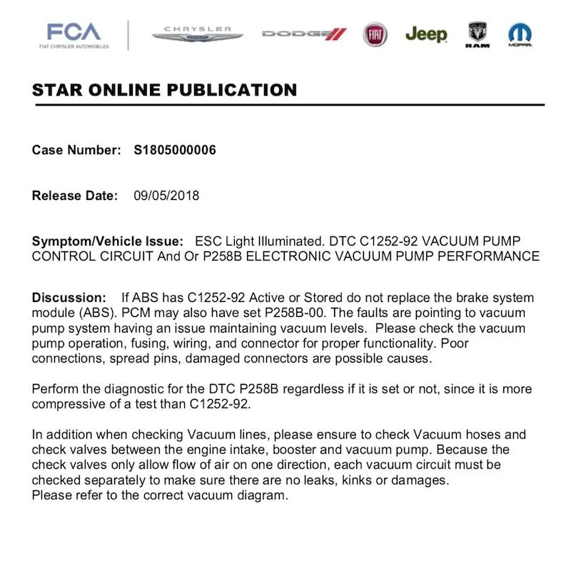

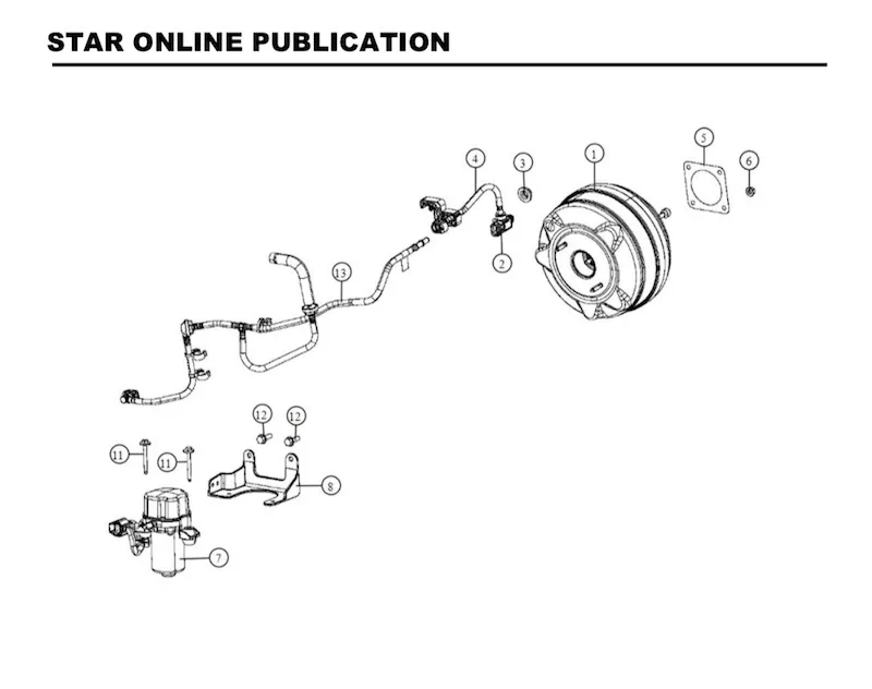

Could this be related to the Service ESC and Auto Start/Stop disabled light problem that I am having when I am in 4H? I have noticed it several times while on trails that after some time in 4H, both the Service ESC and Auto Start/Stop disabled lights come on. They will remain on until I shut the vehicle down and then upon restarting there are no more warning lights.
