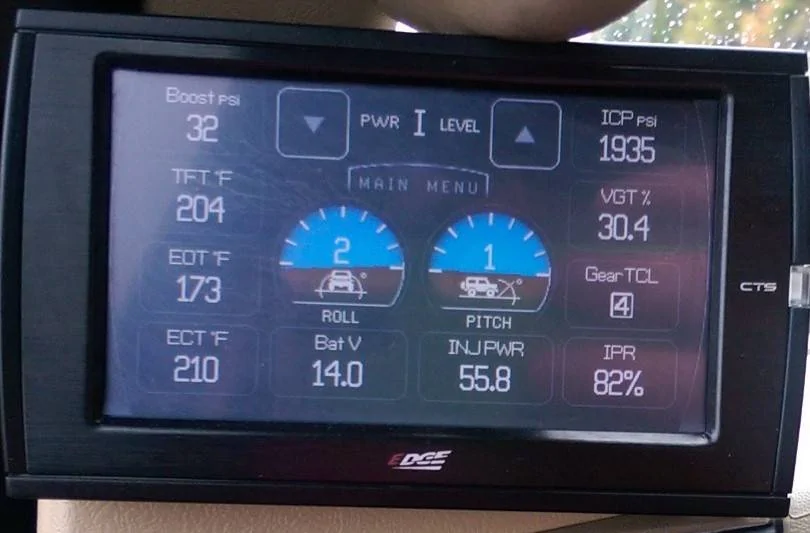

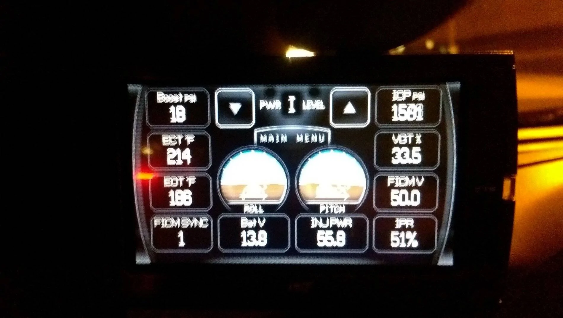

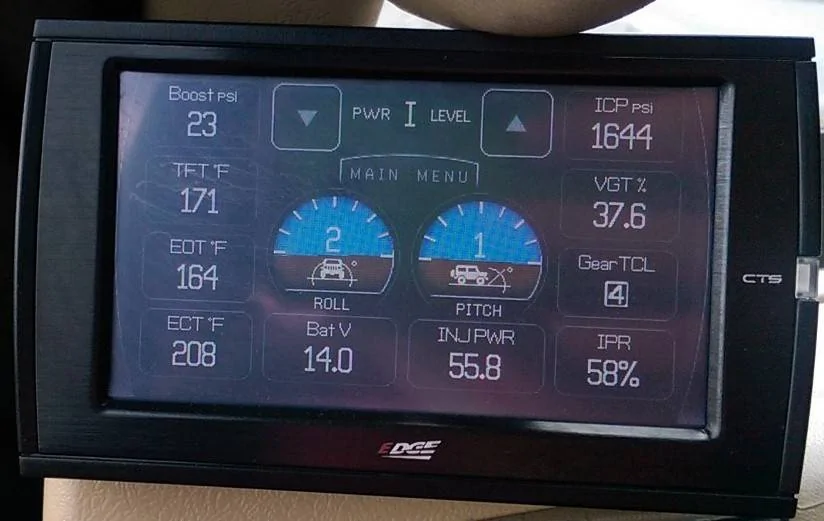

Here are how low I got my oil temps with my oversized cooler.
Normal Operation
Under load @ 1/2 loaded
Under load fully loaded in hot climate

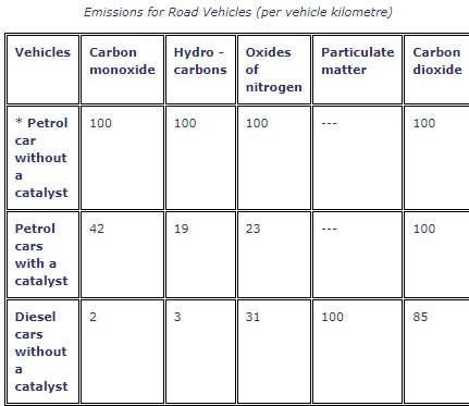

The ED yes is a Euro Spec high rev motor. That doesn't mean that we can't get the thermal temps back to lower safer specs. Planned Obsolescence has been a staple of European design for a lot longer than here. Not sure why we'd want or except that mentality from our manufacturers.
1st Gen common rail and Turbo diesels were only created in '89 for Cummins, '94.5 for the Powerstroke, and '01 for the Duramax. Heat was the enemy of my '04 V10 TDI, but that wasn't expected to haul and was pre emissions. Either way those are the mills we were competing with in the 2000's and the Cummins is still one of the premier choices even today. But by the end of the 2000's we were pushing common rail American diesels to 4000 Rpm or more on the performance aftermarket side.
Specifically to these new diesels the EcoDiesel and the LM2 by GM their torque curves drop off at 3000 Rpm so you don't want to be past that on a grade or incline anyways. The horsepower curves are more passenger or sports car like and that is where the driving characteristics are a blast driving unladen. Operating these diesels in that band while loaded is probably why we are having heat problems. On flat ground the majority of the resistance is at take off and getting up to speed so after 3000 Rpm losing torque is not an issue. But when loaded and on a grade that load and resistance is constant. On a grade like the Grape Vine that load needs to be maintained for over 30 minutes straight. I read a paper when I was young about how much energy that requires and it really set my mind as to why diesels will always be our #1 resource for hauling and the physics involved. Wish I had kept that. And hope that explains. For 80% of EcoDiesel owners that don't haul or do overlanding they will never even probably run into overheating issues.
Also I wish more people realized that NOx regulations for diesel were a handicap of their efficiency not a necessity. As this chart shows unregulated diesels only produced roughly 16% more NOx than regulated gas vehicles in 2001 when these statistics were formulated. The regulations called for them to cut NOx to 4 g/bhp·hr in 1994, 2.0 g/bhp·hr 2004, 0.050 g/bhp·hr from 2024 and to 0.02 g/bhp·hr from 2027. That is a 100% cut, on top of a 50% cut, on top of a 50% cut. By 2004 standards diesels were already producing less NOx than the cars that were being built in the 1990's. By the 1990's we had already cut auto emissions as a whole by 99%. So all the regulations and mandates are increasing the costs of our vehicles and shortening their life cycle to cut a fraction of 1%.
