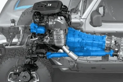

The Belt Starter/Generator itself is the motor you're thinking of with the ETorque. It replaces the alternator, and is used to start the engine and give a short torque boost to the gas engine in low RPMs.
The 4Xe has a much more robust electric motor in the Transmission that can propel the vehicle by itself, but requires a much bigger battery pack than the ETorque system.

Thats a pretty good video. I forgot the eTorque motor was just a small generator run off of a serpentine belt. For some reason I thought it was a pancake motor infront of the transmission. Your right that it would be pretty impossible to get that motor to do much more than it already is. You can only run so much torque through that serpentine belt. Actually I'm surprised at how much torque they are claiming it does add considering all the power passed through a belt. Really it all just reaffirms that its a system I don't want. I really hope they make it optional in 2022. But that seems unlikely.

The 4xe still has the etorque, it's probably required to immediately match engine RPM to the trans speed. It's amazing how smooth the motor to engine transition is in hybrid mode in the middle of driving, if it weren't for the tach, it'd be hard to tell.

They have to be able to operate independently to allow seperate drive modes, the etourqe setup seems to be perfectly taylored to the requirement. Of course it could be a different generator, but it's in the same spot. The big motor is in the trans.
