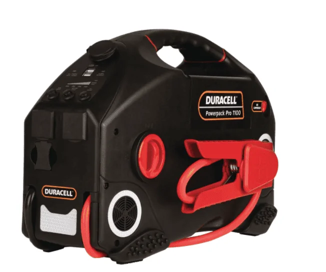

I've ordered one of these from Costco. I can't take a chance of this happening in the desert wilderness.
