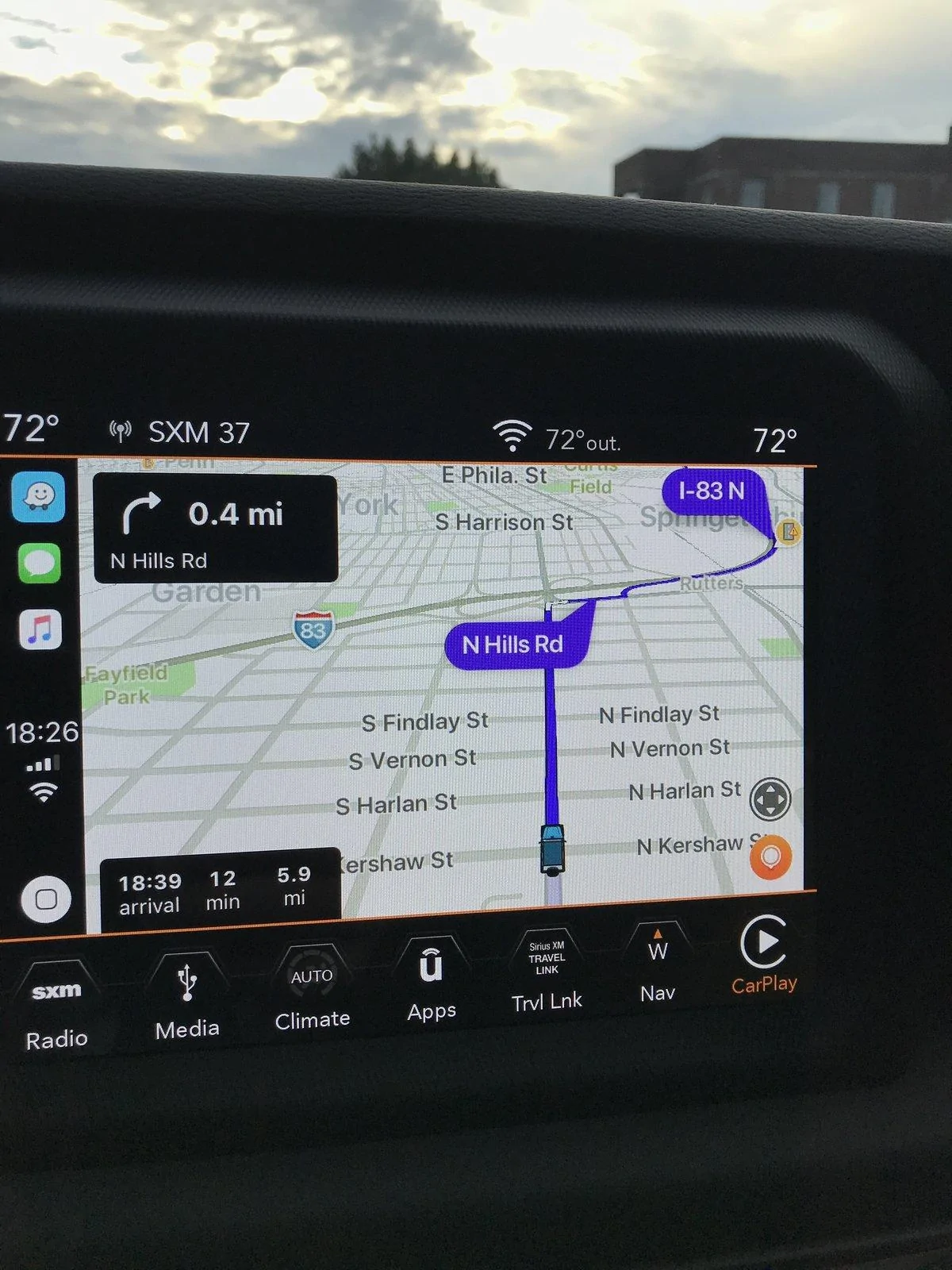

My CarPlay still hasn't updated to OS 12. Do you have to do something specific for it to update? I can't wait to see waze on there! Thx

CarPlay won’t update. You update your phone to iOS 12 and you’ll have access to the updated features.

Thank you! Just read in another thread how I needed to actually update the Waze app for it to show up. That worked. Thanks again!
