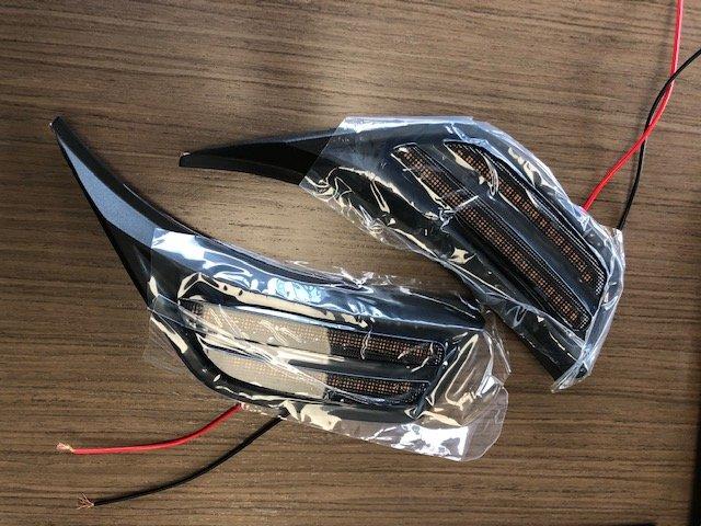

Anyone have any experience with installing these? I am not super mechanical, but saw these and ordered....now that I have them, wanted to see if any had had luck installing......should i have a installer do it, or is it a pretty simple DIY?

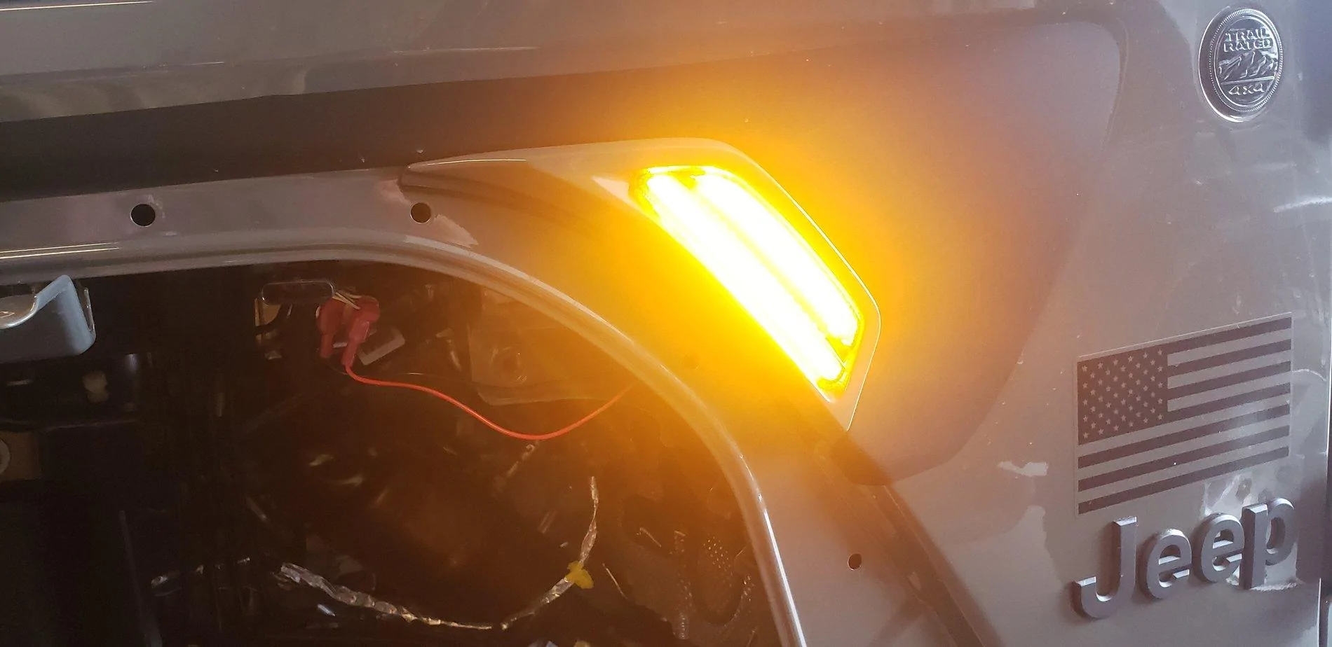

The white wire with the green tracer stripe is the turn signal indicator if anyone is interested. I just installed the Oracle Sidetracker light units. You're right, those push pins are a pain but after the first side install I realized you don't have to take all of them out! Fortunately Amazon sells bulk and assortment boxes so I have plenty (mostly for my 3 ATVs). It's amazing today that cars are assembled with snap clips and plastic pop rivets! At least no rust on those parts!

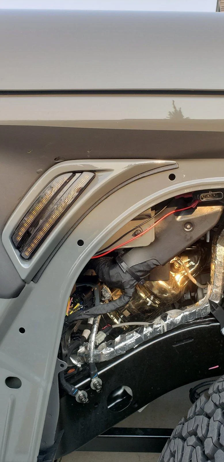

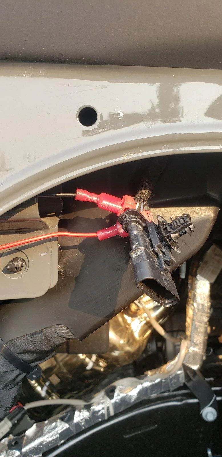

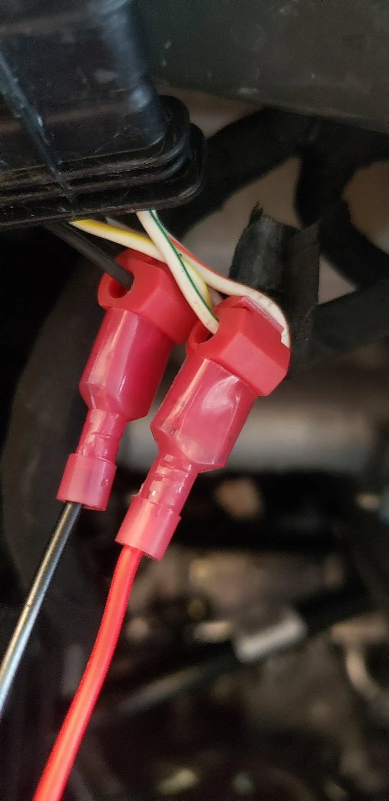

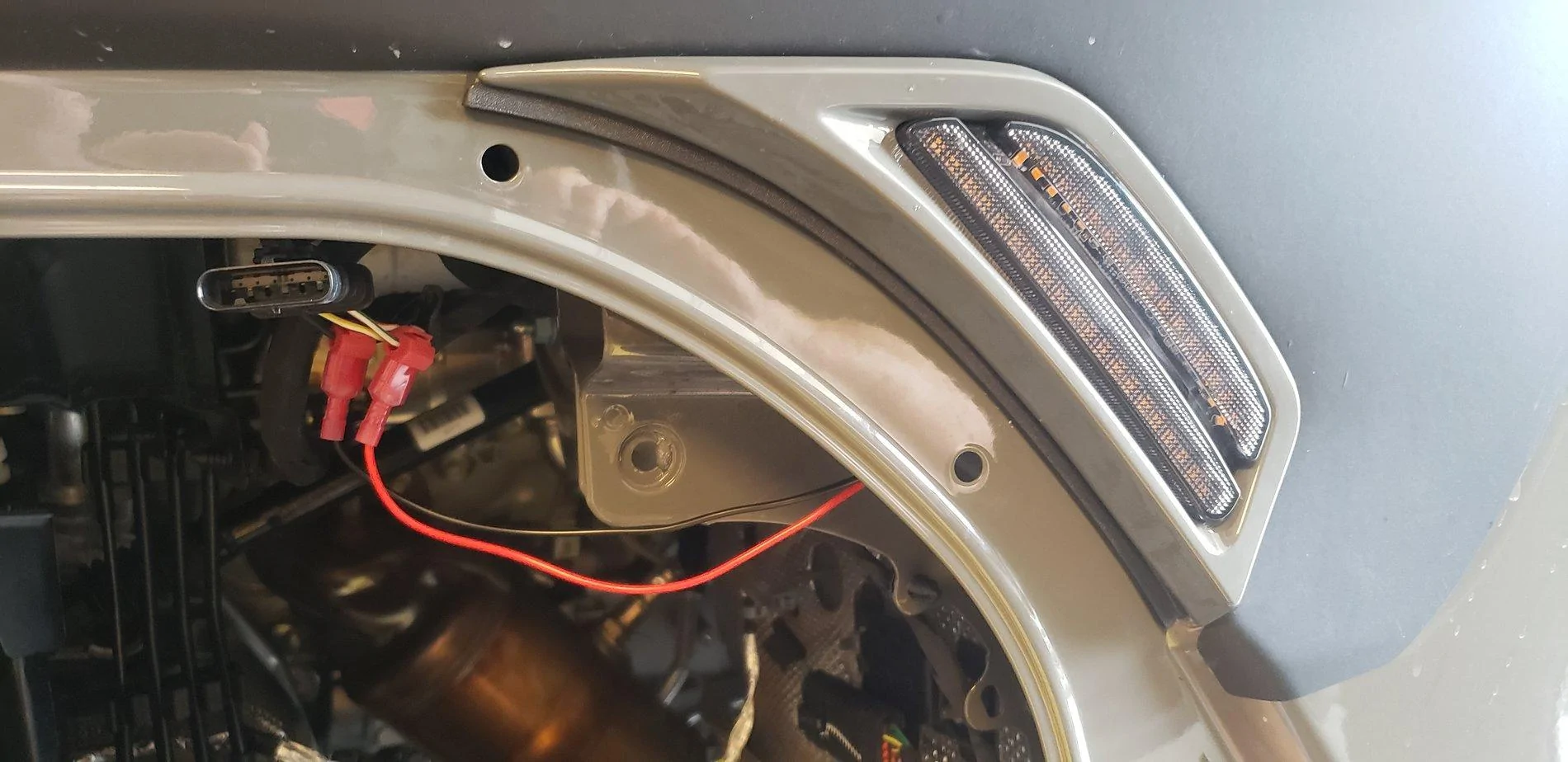

I figured it out with help from Sting. Here are the pictures.
Note the left and right sides have different color wires. Green/white on driver on my 2020 brown/white on the passenger.
