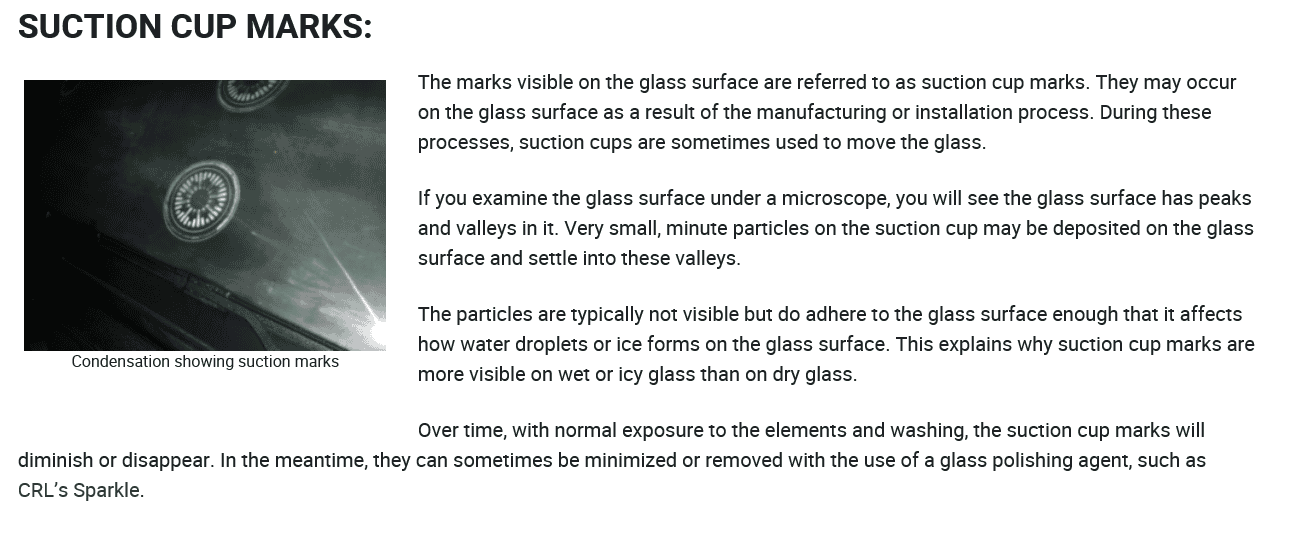

Found this today, not really a help, but a better explanation...

I don't know the "hack", but I was able to clean off the circular residue with car window cleaner from Home Depot, a non-scratch scrubbing tool, and A LOT of elbow grease.

I was going to suggest rubbing alcohol...
