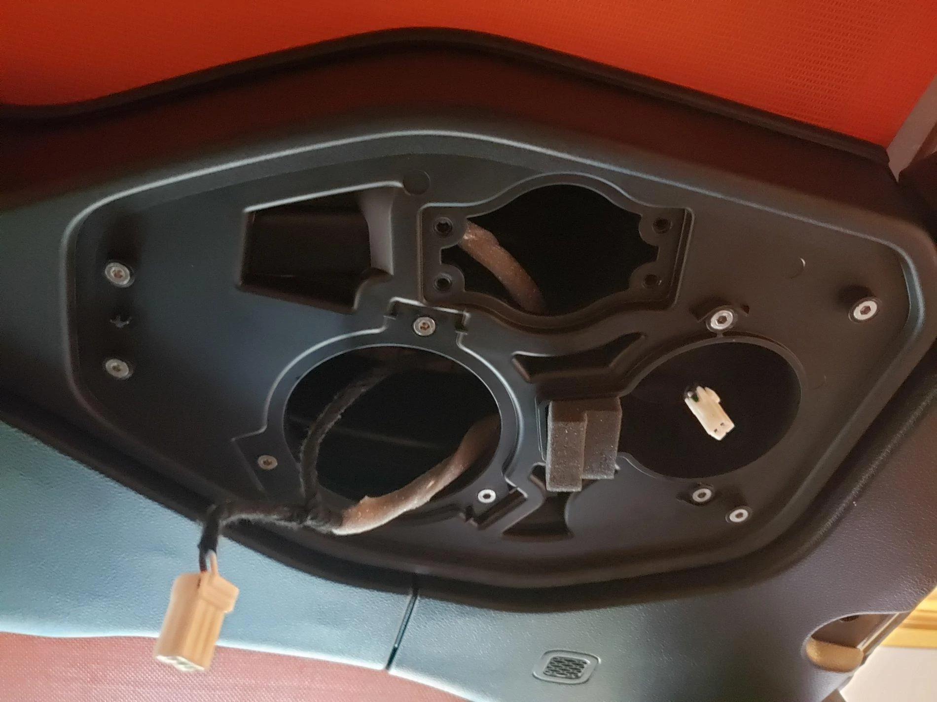

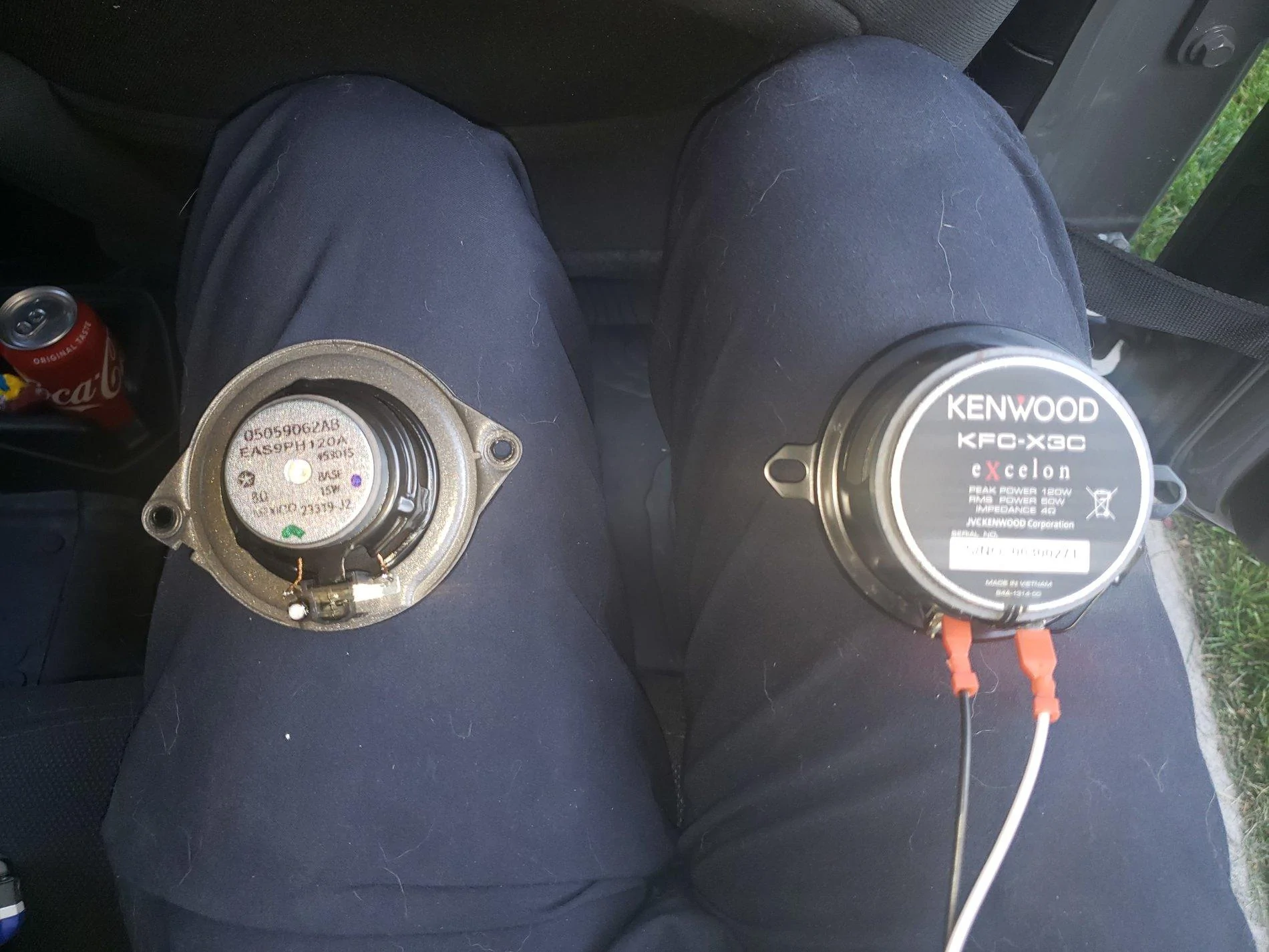

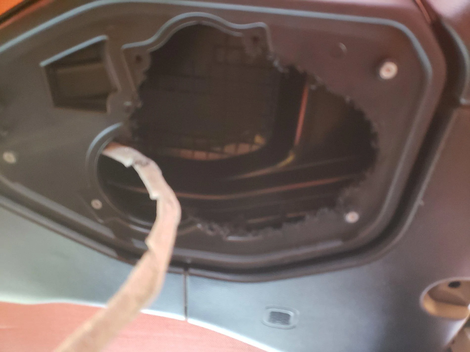

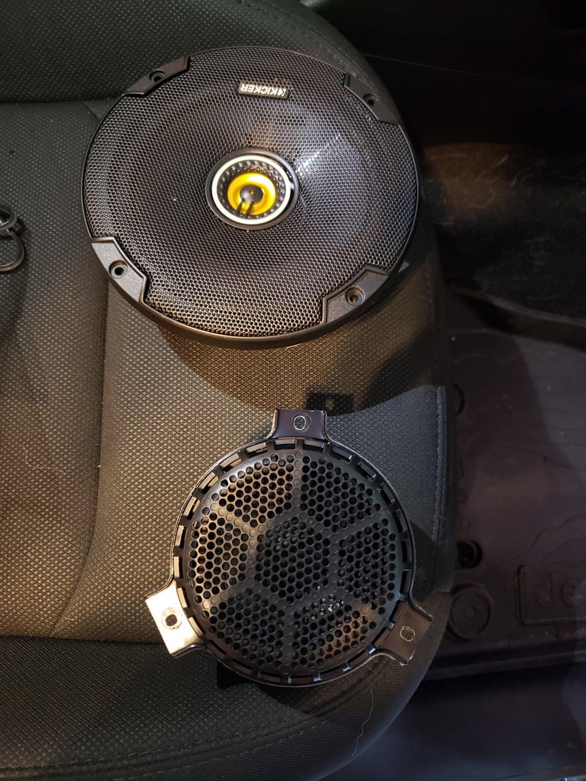

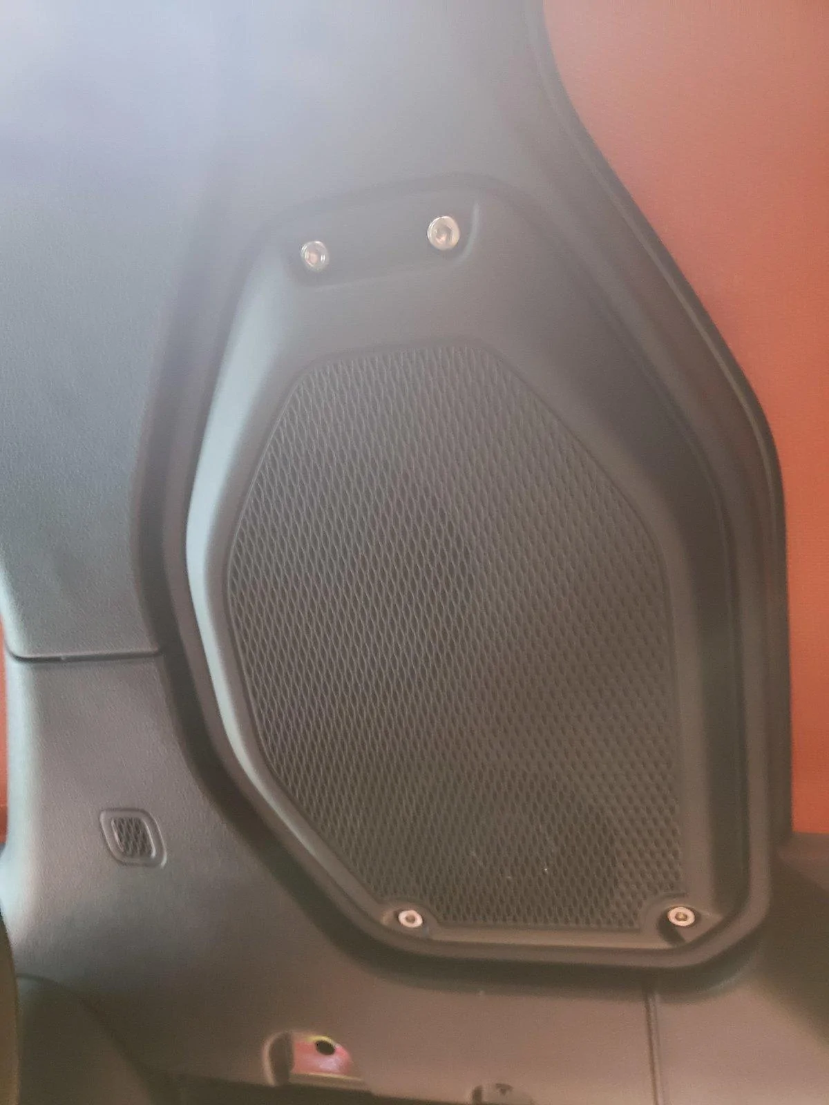

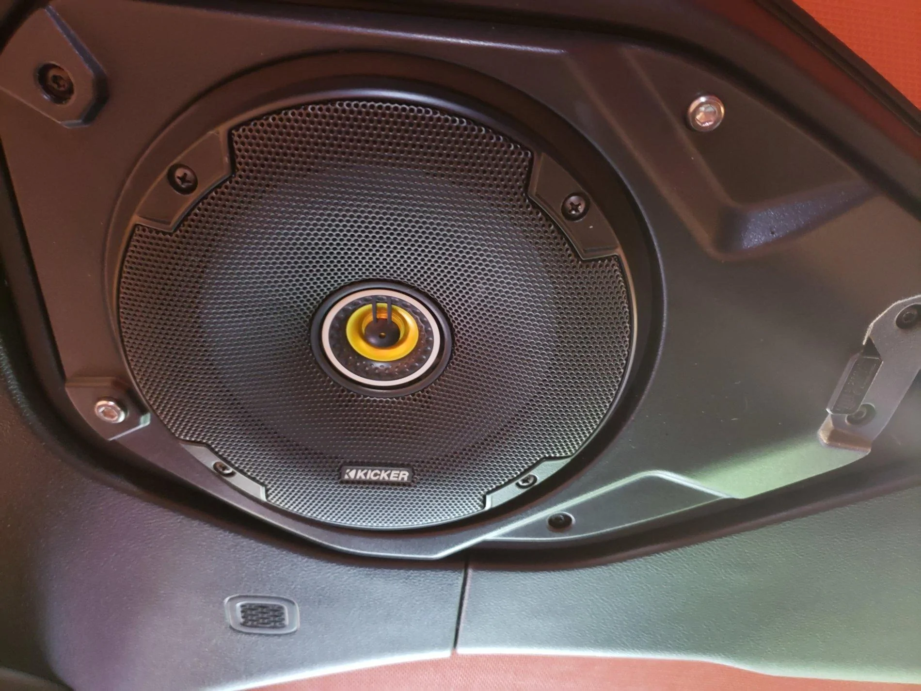

The stock audio in the Wrangler is beyond bad in my opinion. I recently went down a rabbit hole and spent entirely too much on a full upgrade, with headaches all along the way. The speaker's quality that comes stock is laughable. If we're spending this much on a modern vehicle, do better than this nonsense. Anyways...
Here are a few pics of my upgrades. I had to fully modify my soundbar and also filled it with poly-fil. I used a Dremel tool to cut away the plastic. I actually went back and redid these again with component speakers and made room for a 1" tweeter and Rockford Punch speakers. Also installed a DSR-1 and Rockford amp. Still needs a small sub to round out the sound, but at least I can hear the music somewhat with the top off.
