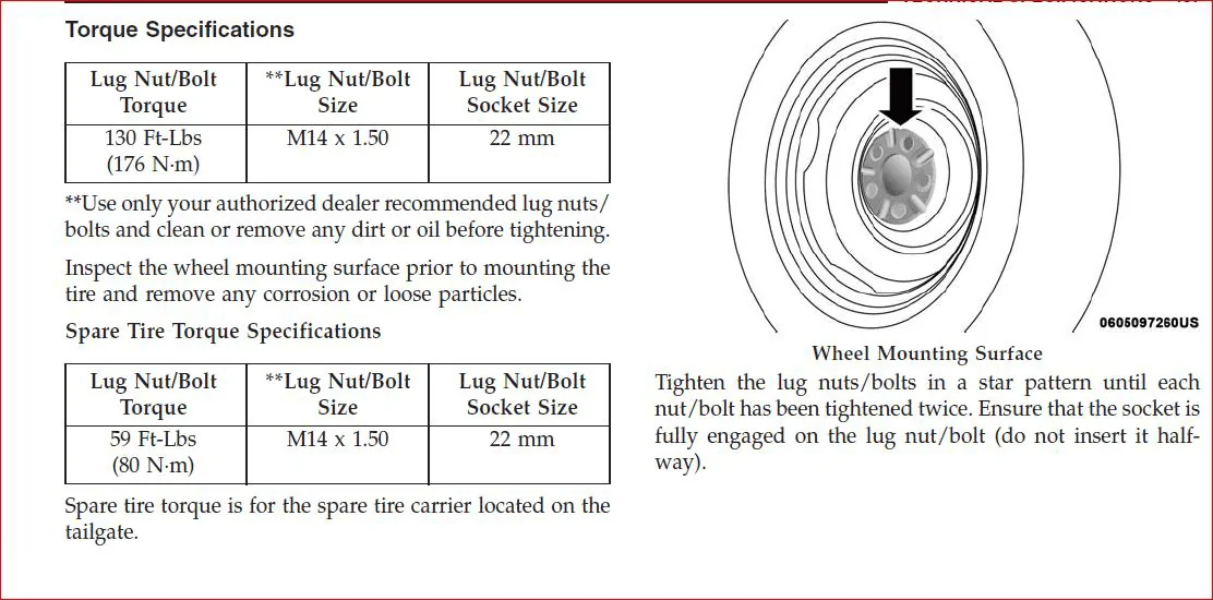

22mm lugs

That might depend on how many points your sockets are... metric sizes are from the manual.1/2" socket for your oil drain plug and 13/16" for your filter cap are tight fit, the metrics have some play, not a big deal on the oil cap since it's not very tight but best to have a perfect socket fit.
Similar to the LCA nuts, some have used 24mm and have had issues rounding the heads whereas 13/16 is the perfect fit. If you have both sockets on hand try the SAE sizes, I think you'll see a pretty noticeable difference. I always use 6pts FWIW.That might depend on how many points your sockets are... metric sizes are from the manual.
