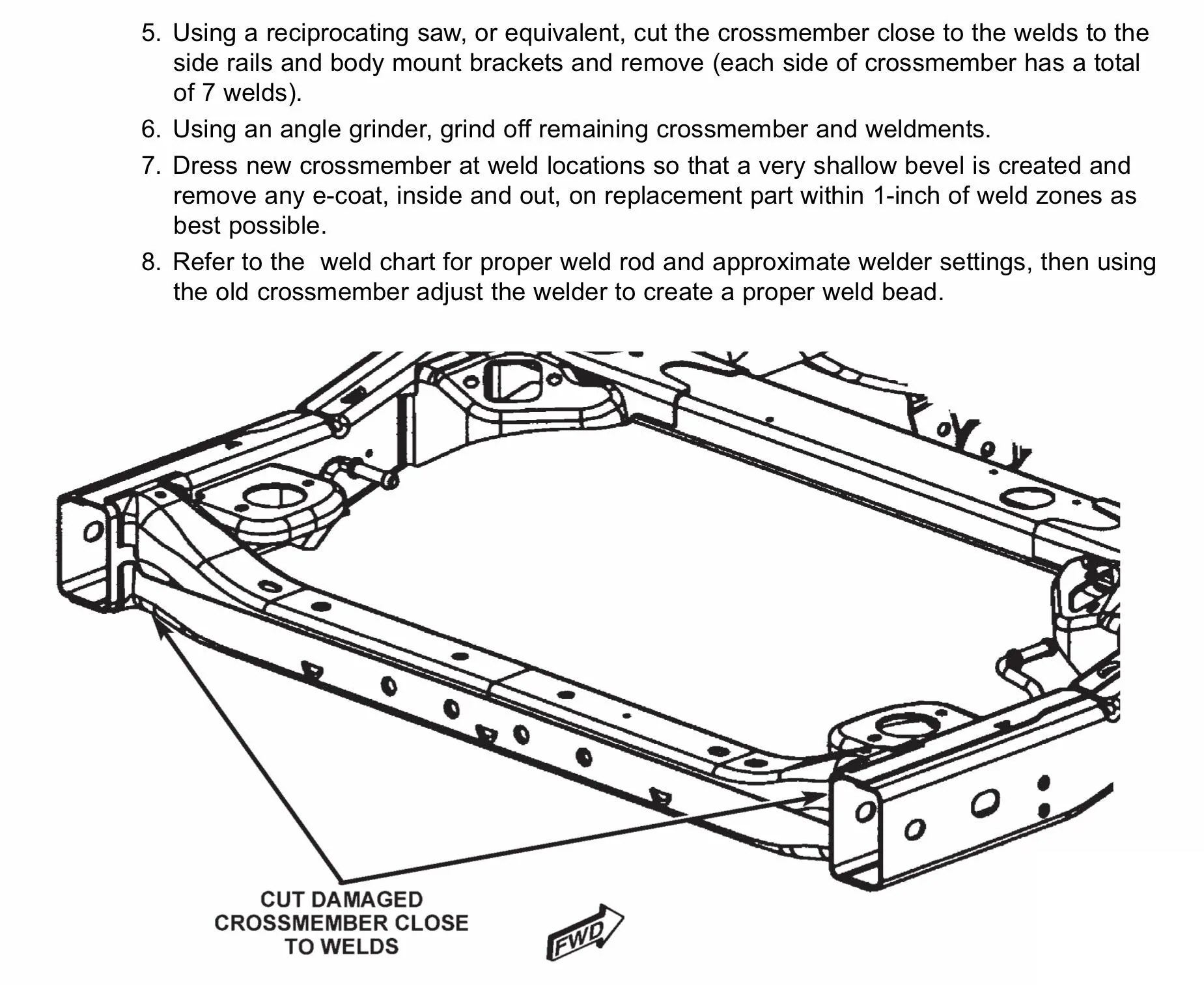

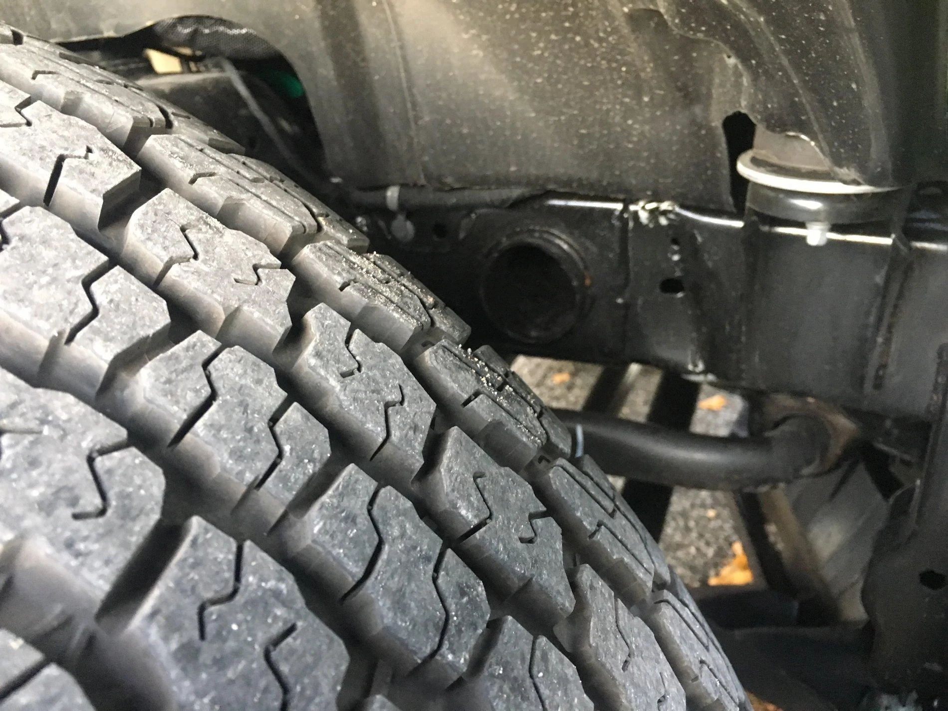

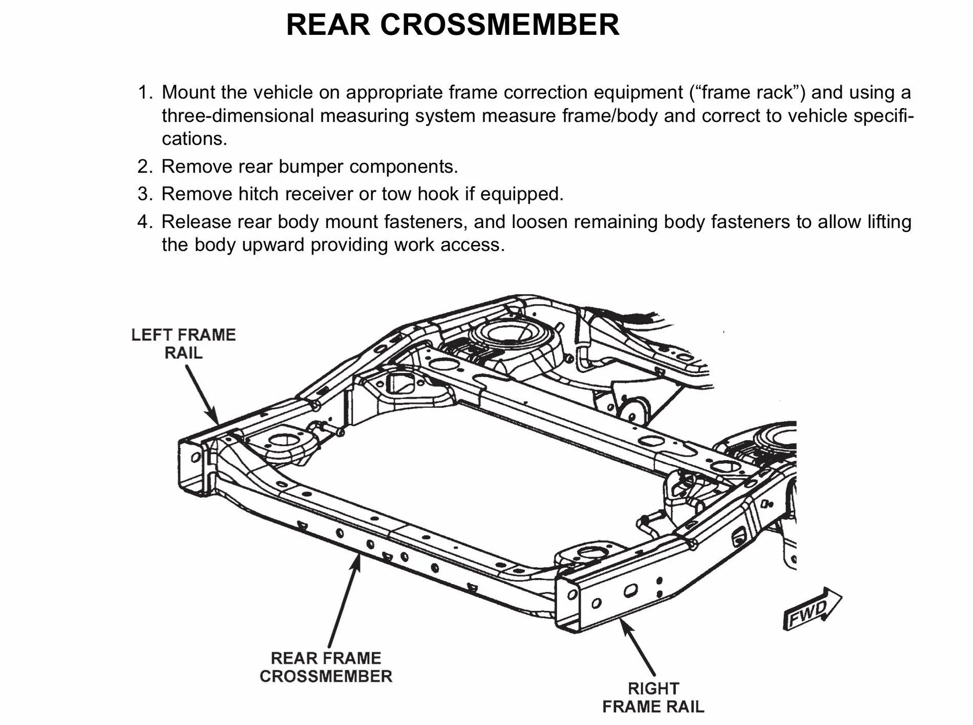

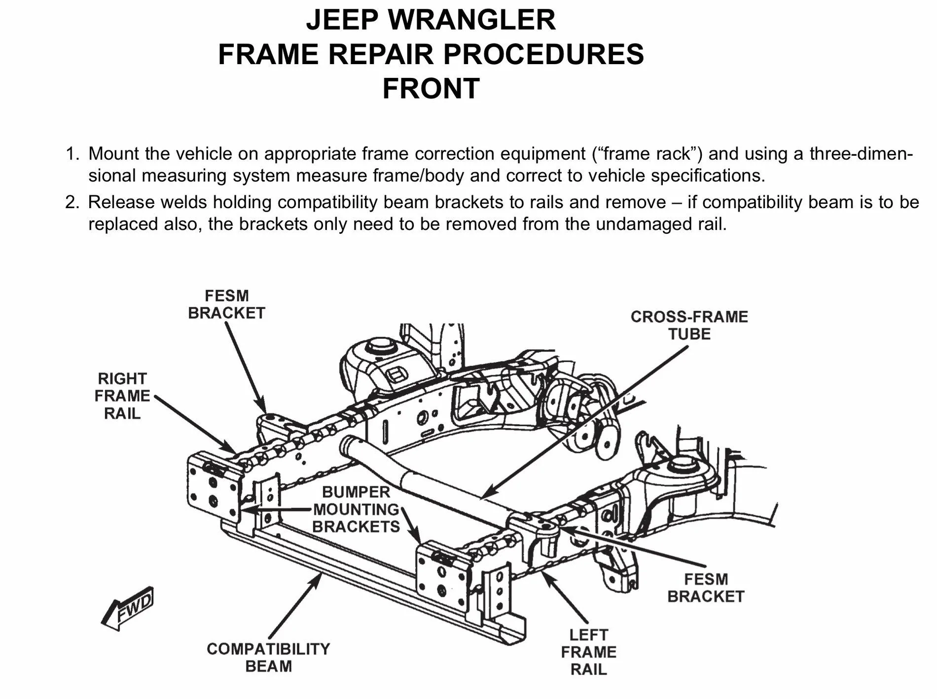

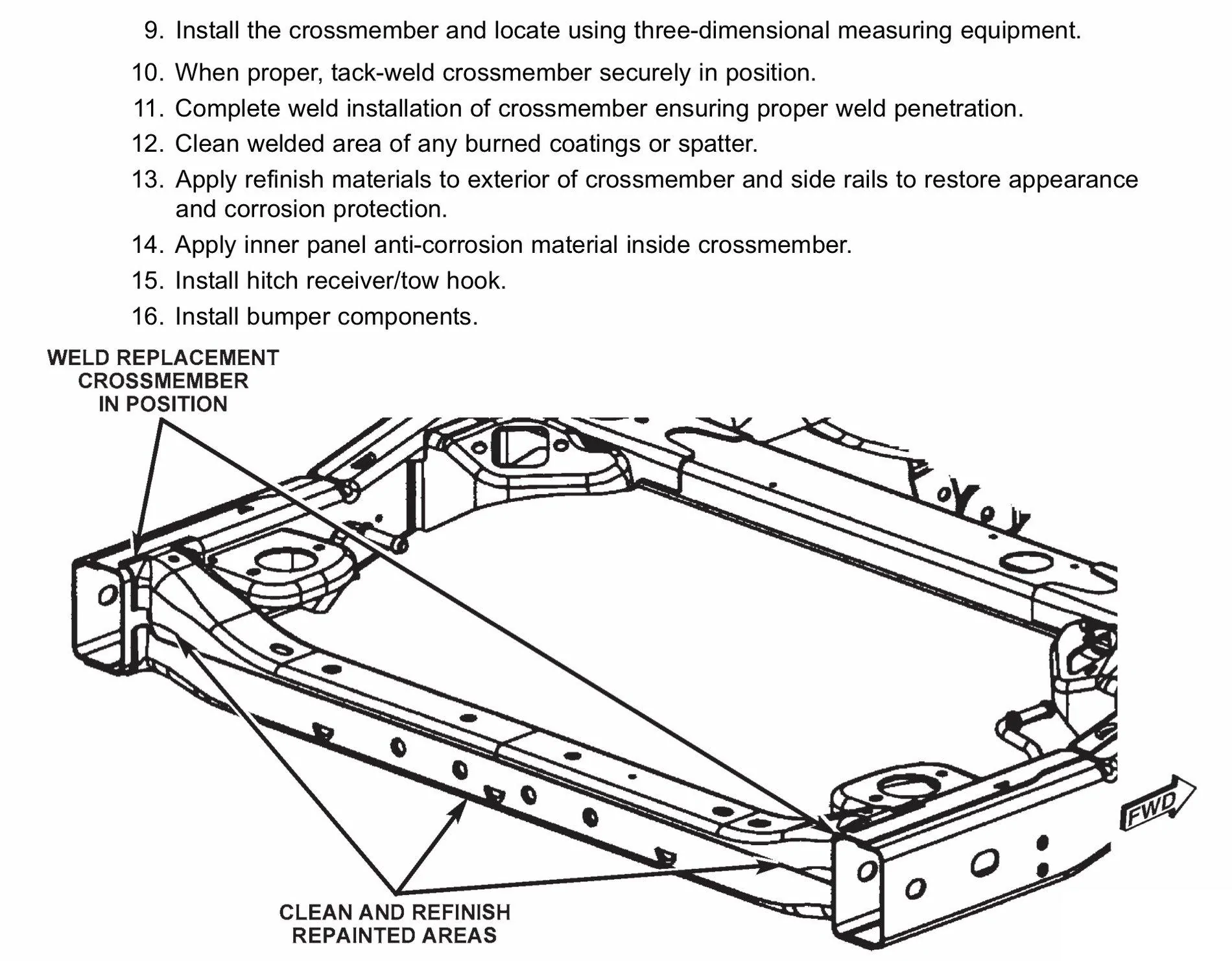

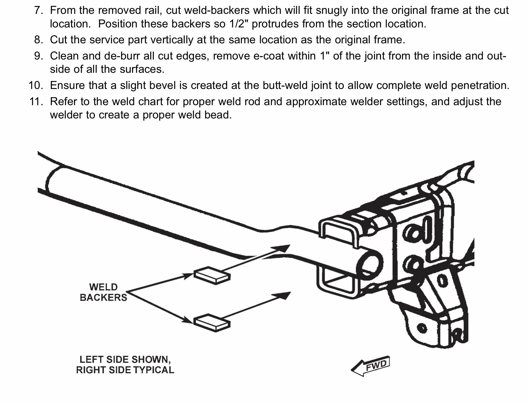

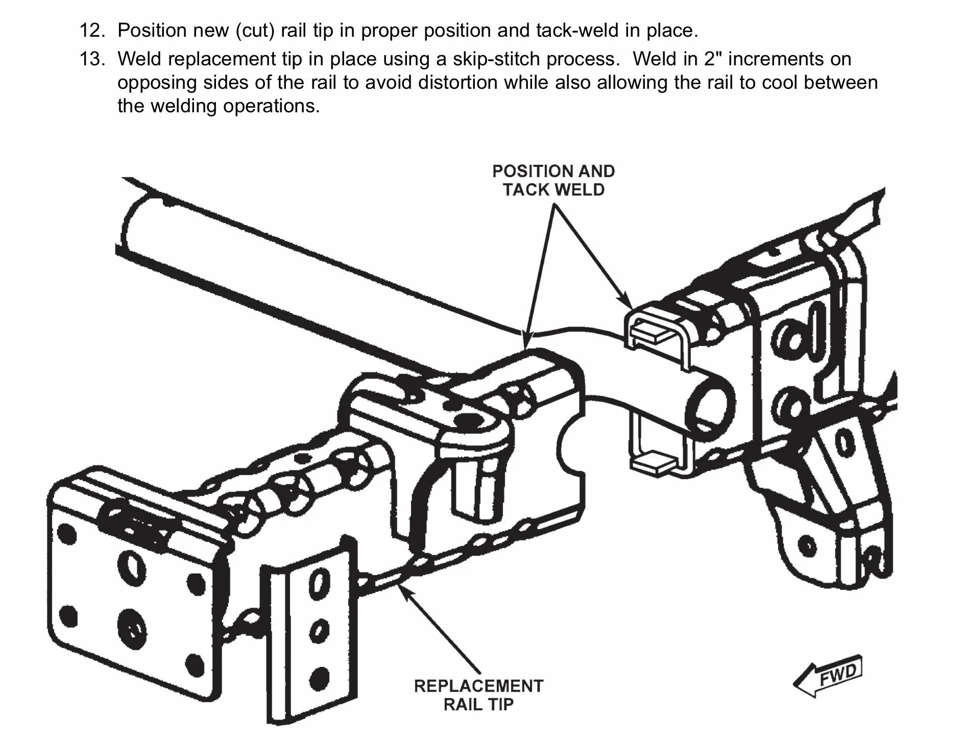

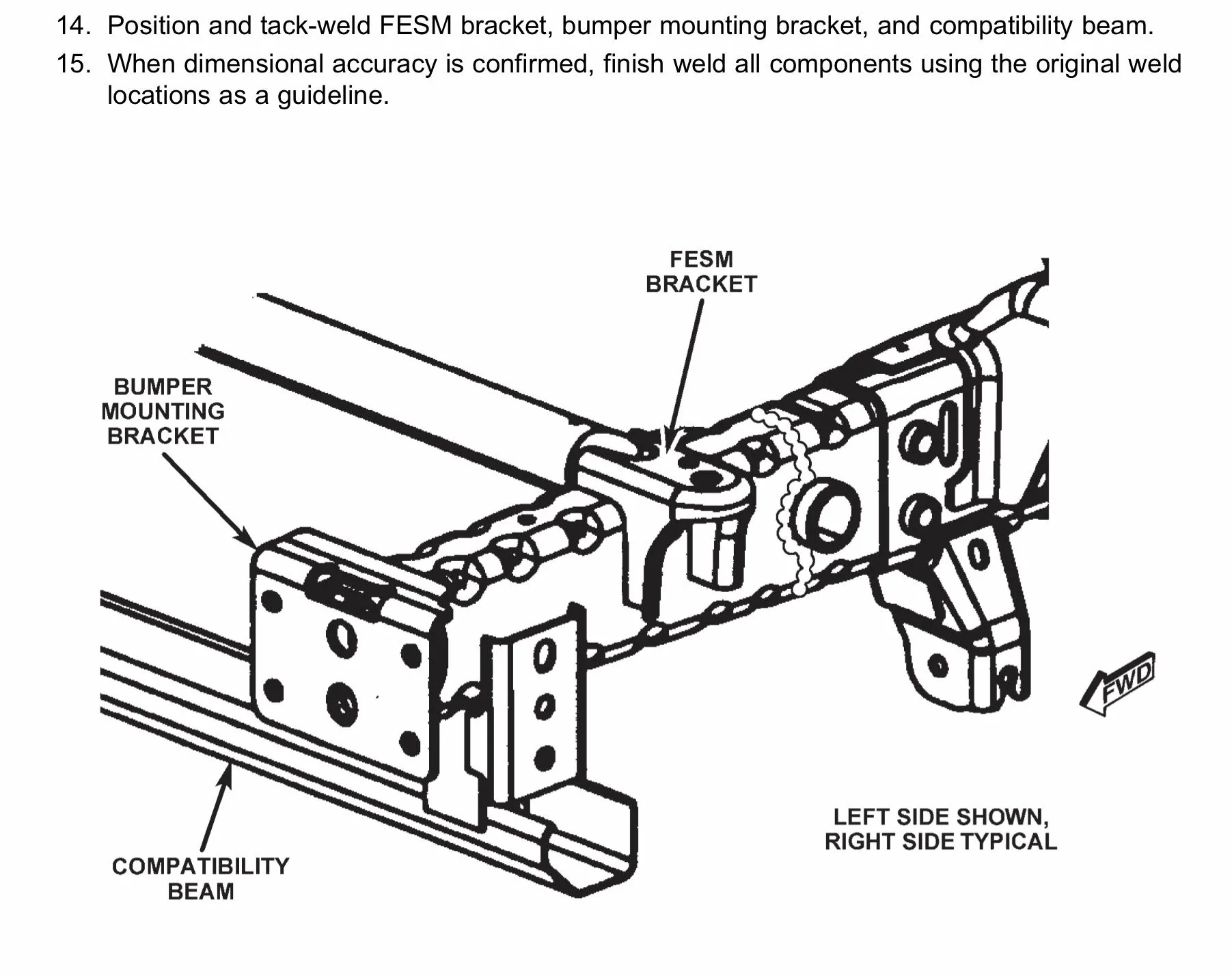

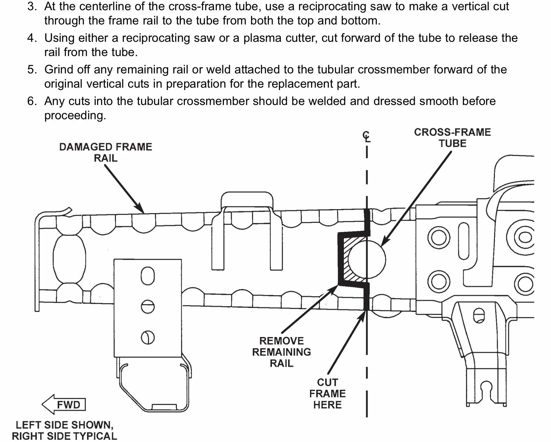

I have “valeur a neuf” in my assurance policy. That mean if the car is declare “Total” It will be replace by a new one of equal value.
And the part for repare will be the original new parts.
I try to have the frame change for a new frame, but they wouldn't. Knowing it is damage at both end! They treat the frame as a assemble part, assemble by welding. So, my old frame will have some new extremity.
If you wander how they will repair the frame (Procedure for JK’s, didn’t find JL’s, but...):

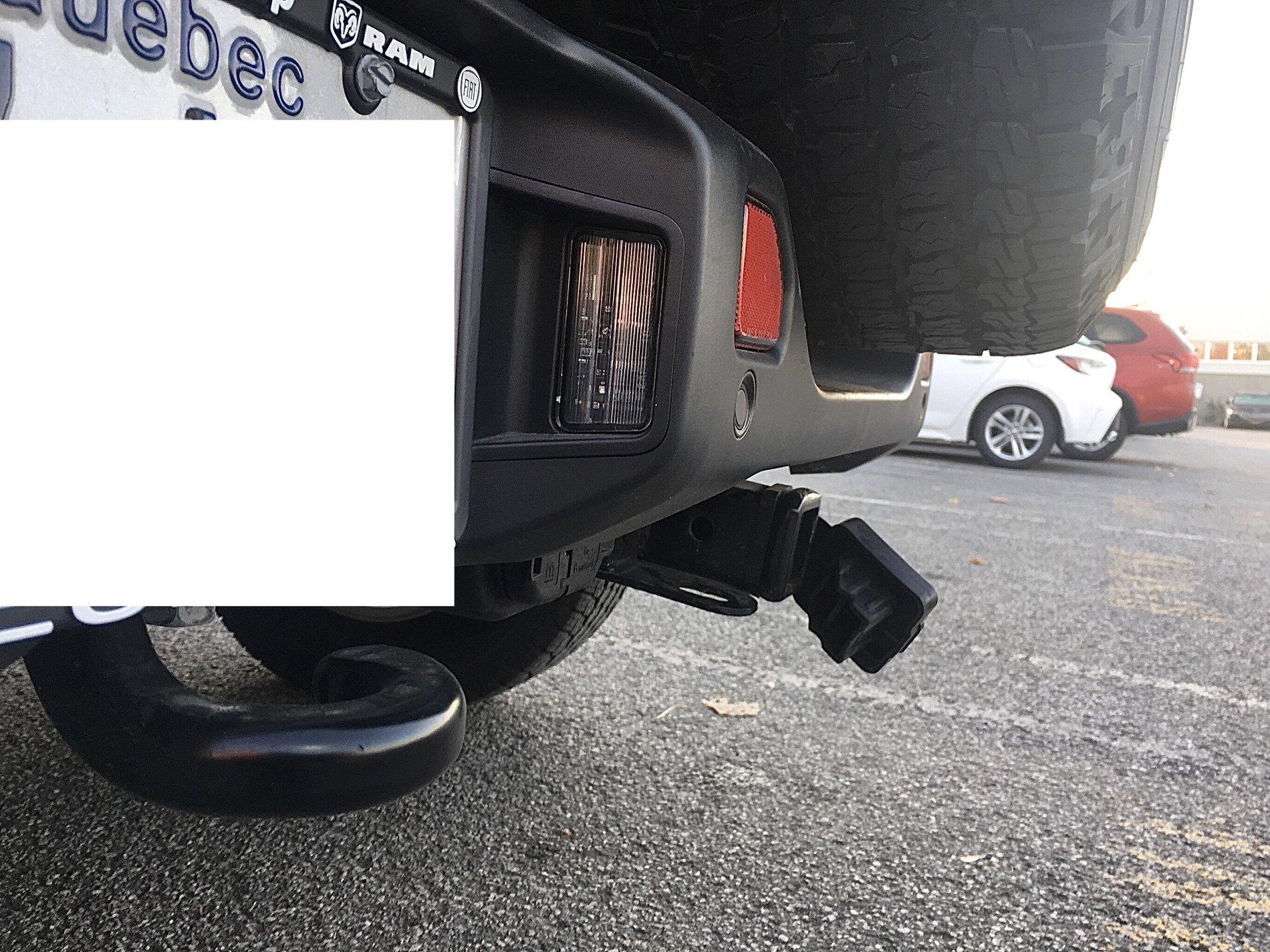

I was looking for metal bumper! My old JK’s or not a perfect fit. The rear bumper could hold by the rear cross member but would have to be modify to bolt to the frame. And they don’t have the hole for parking spacer in the back and fog light in the front.

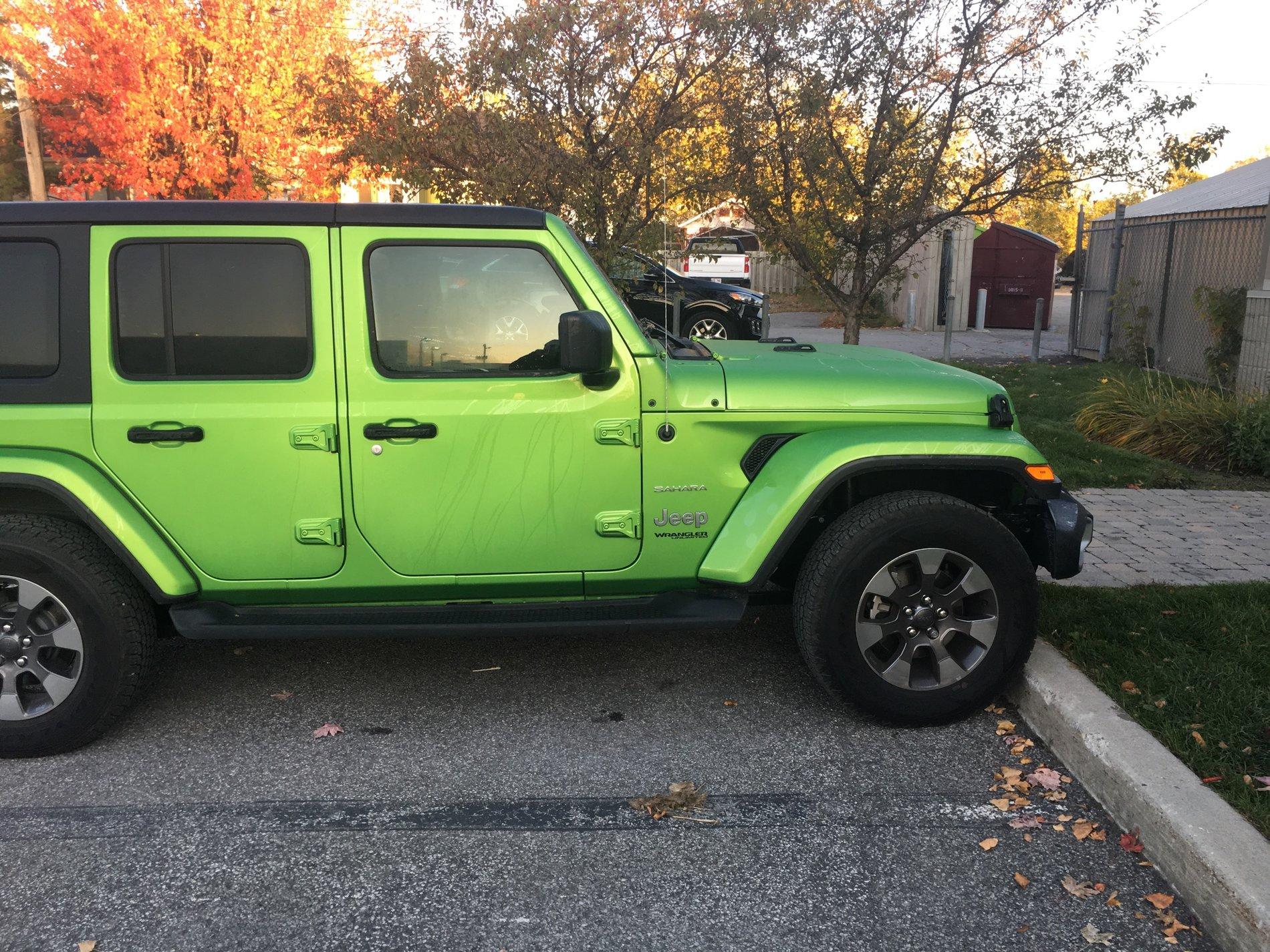

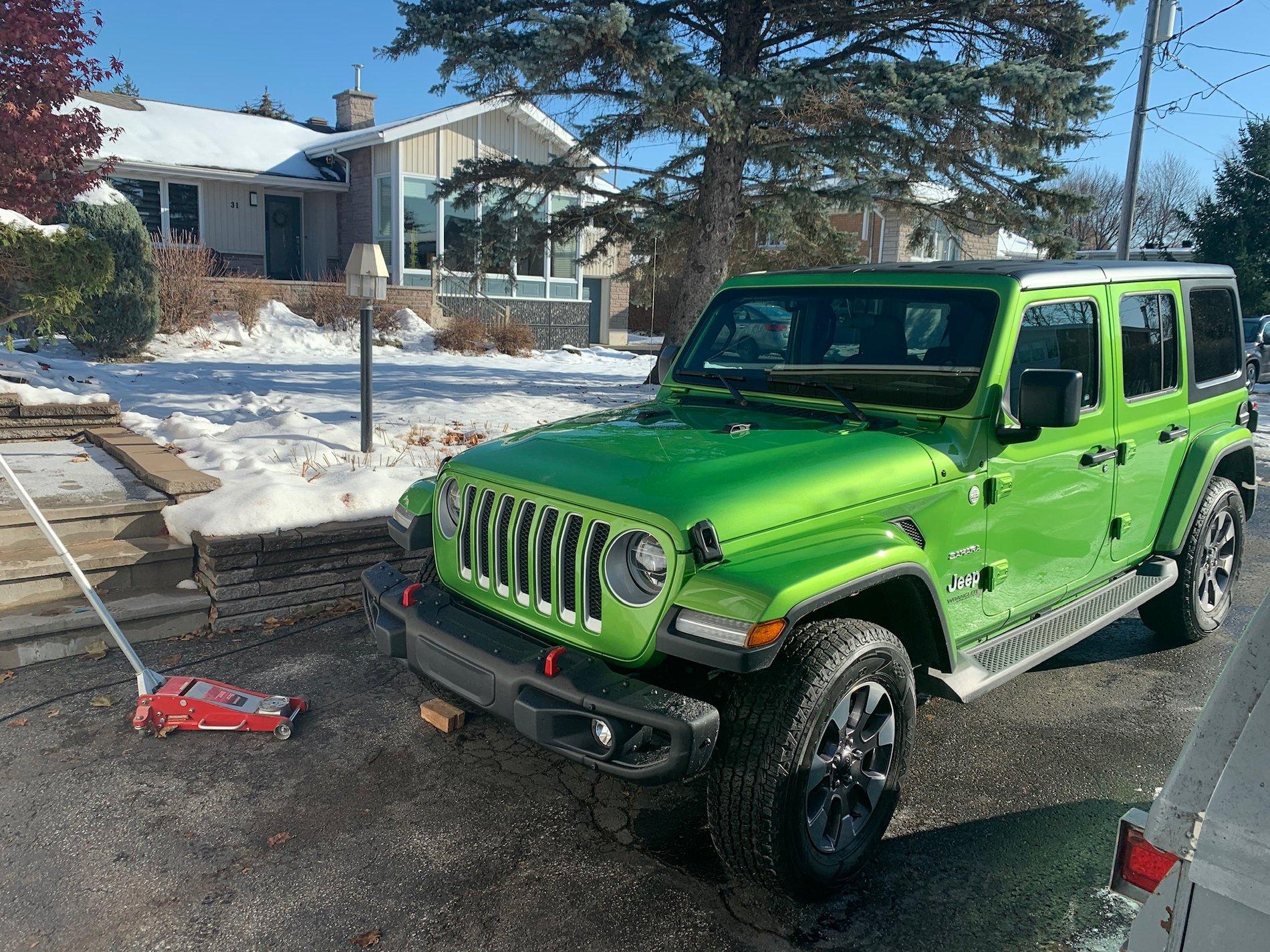

In any case, the work is done and the Green Weevil has returned home at last.
It arrived home and i instantly removed the soft top to put the hard top...1hr after that, the first snowstorm of the year came in...that was close :)
Driving a wrangler is so different than an Acura RDX....after five weeks it convinced the whole family we made the right choice of vehicle....now about resisting that diesel sarge green....
Mind is done to, I got a call today. There is still a ABS light in the dash. The body repair shop ask me if I wanted it, and I would have to go to the dealer with it. Or if, I wanted then to take care of it. So I told them to take care of it. It less trouble for me, time and bill to send to the insurance...ect.

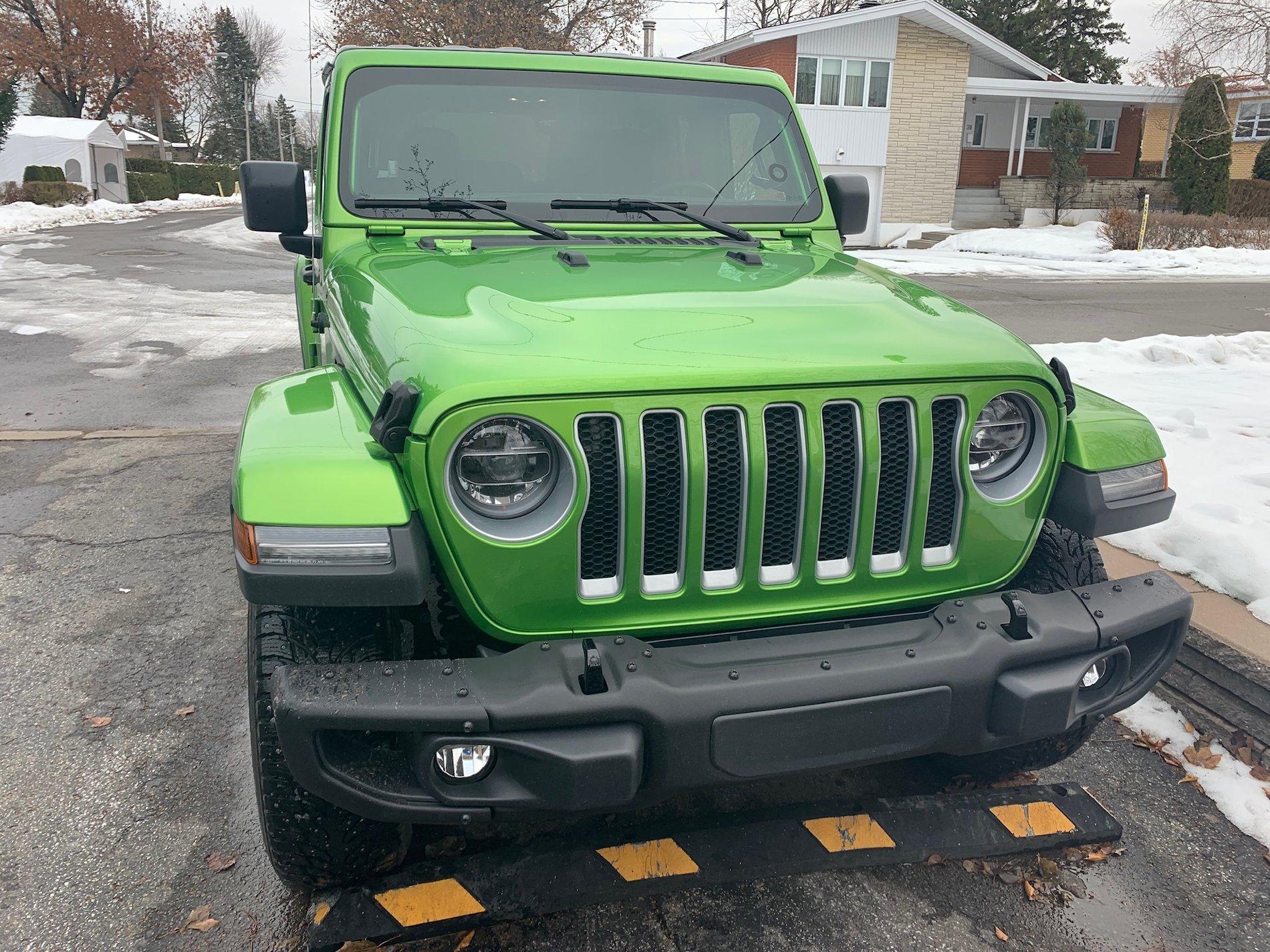

Ho ! I got an upgrade! I both the front steel bumper. The insurance paid for the plastic one, but there were ok with me paying for the extra.
So I got the steel bumper at the insurance cost ( they have good price Mopar retail is 1900$, the dealer wanted 1500$ and the body shop got it at 1100$. This minus 450 for the plastic and 90$ for the backup plate. So around 560$ +tx for me to pay, for the bumper. The body shop didn’t ask me and ordered the skid plate to! so 960$ total. I am happy with that.

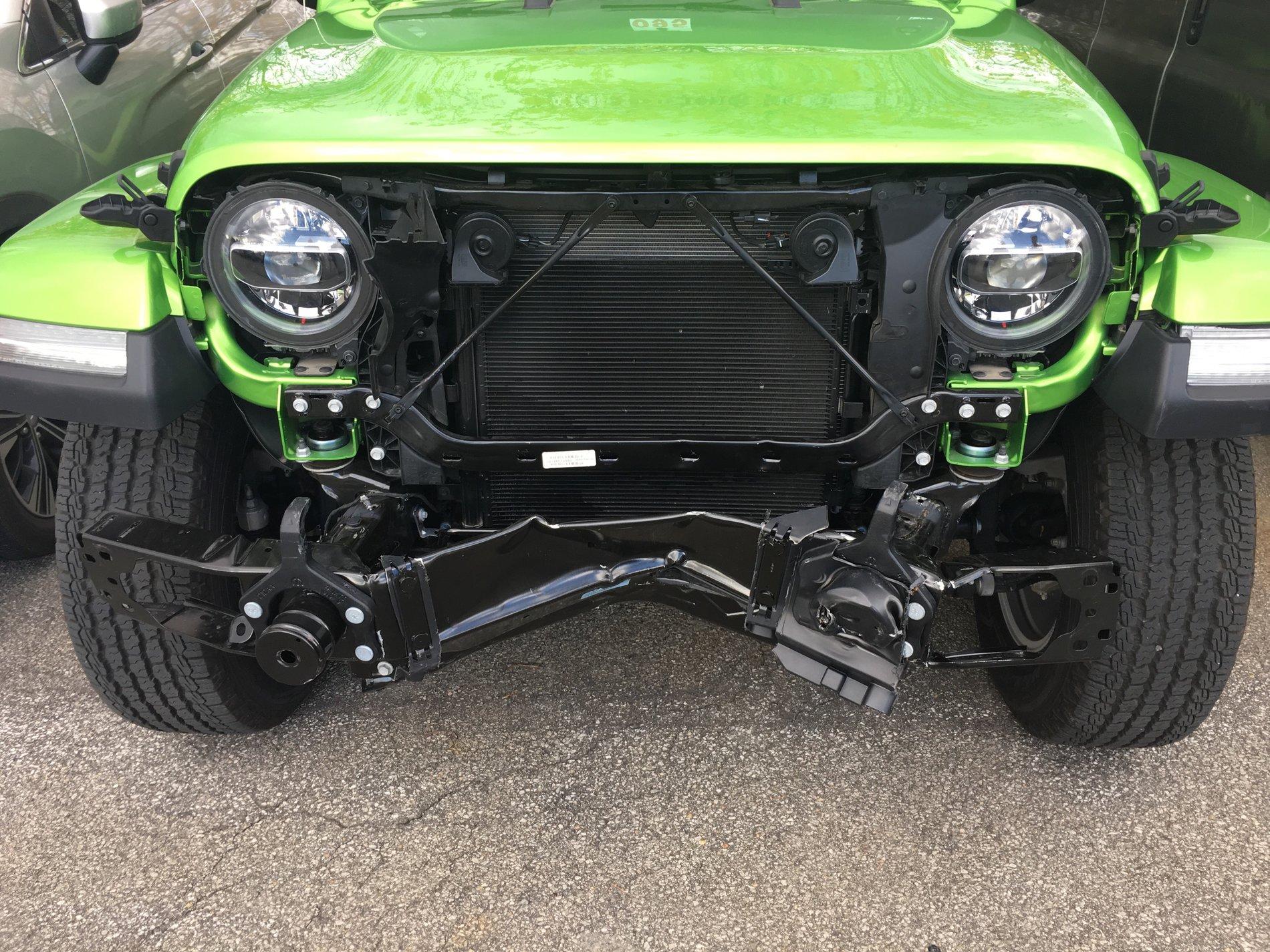

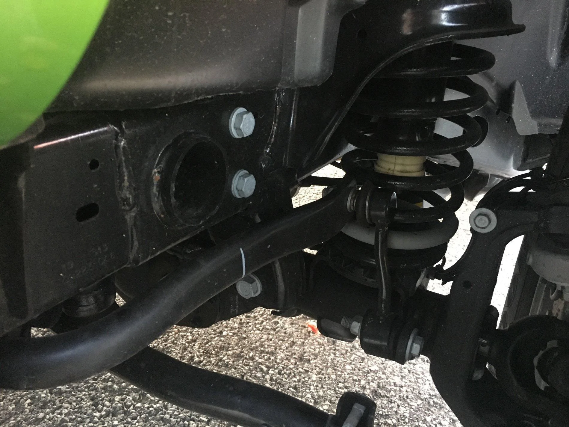

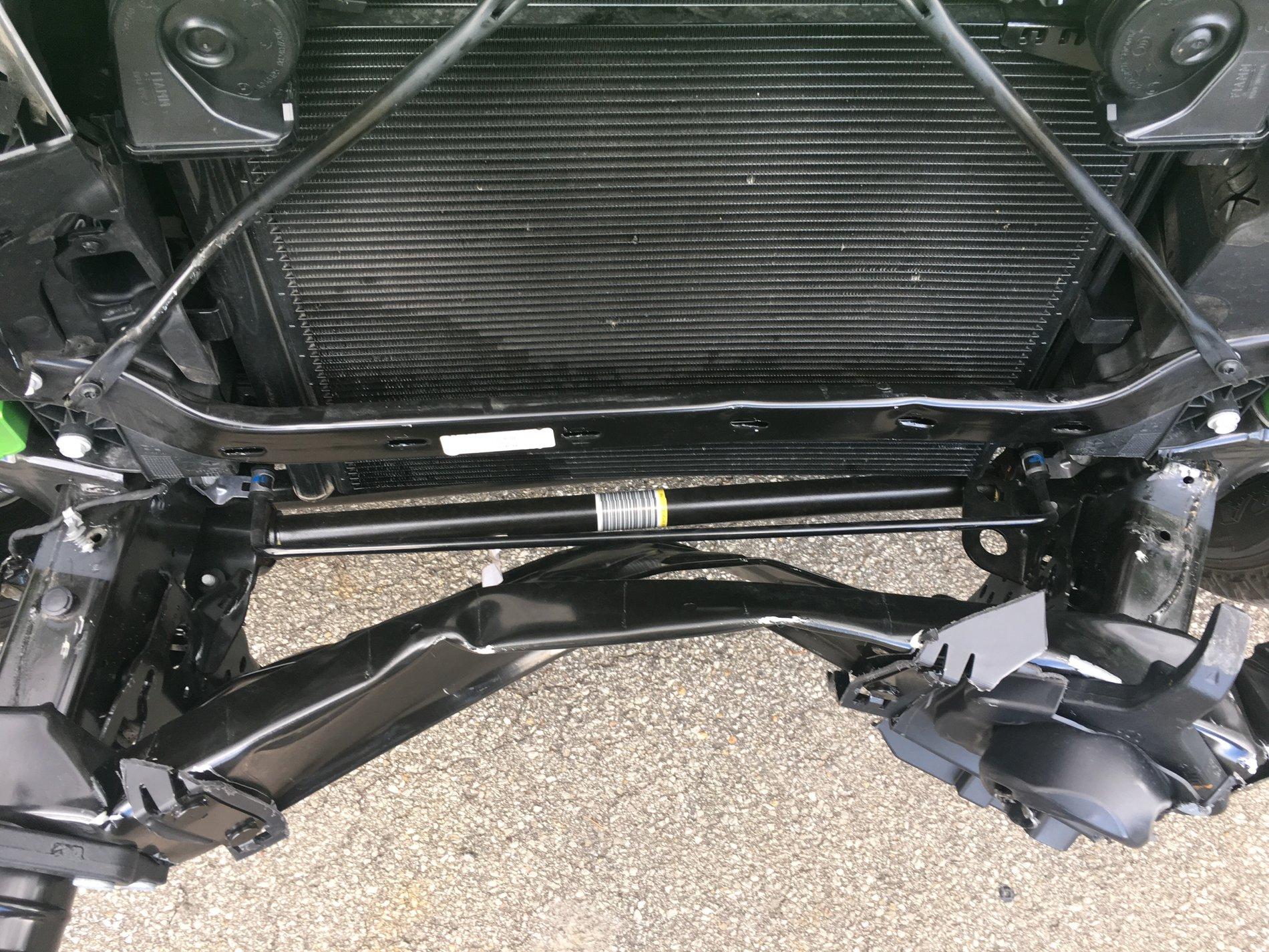

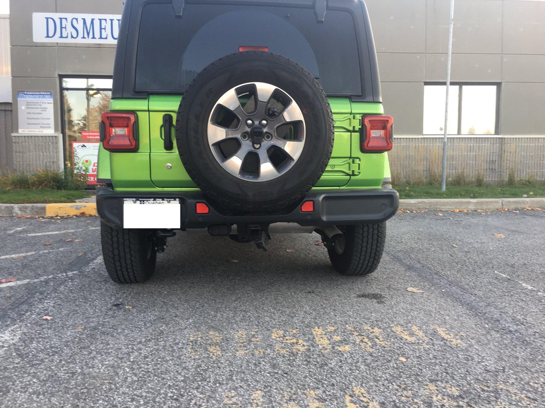

Very interesting pictures...they do have to disassemble a lot of things.

Yes, it is quite a job. I cost 10000$ and lasted 4 week. Now it look new again and have steel bumper.

Outstanding, mine looked as new as well where repaired. Well, that means our Green Weevils are on the road again. Safe winter to you.

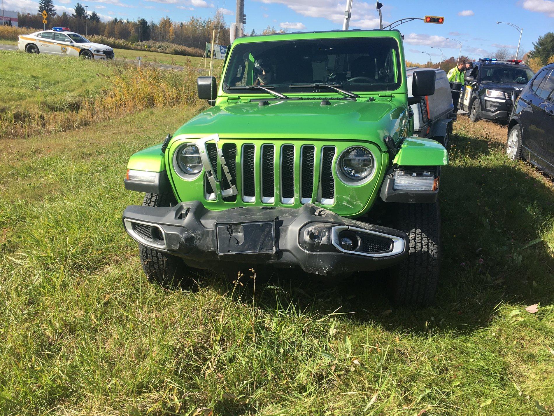

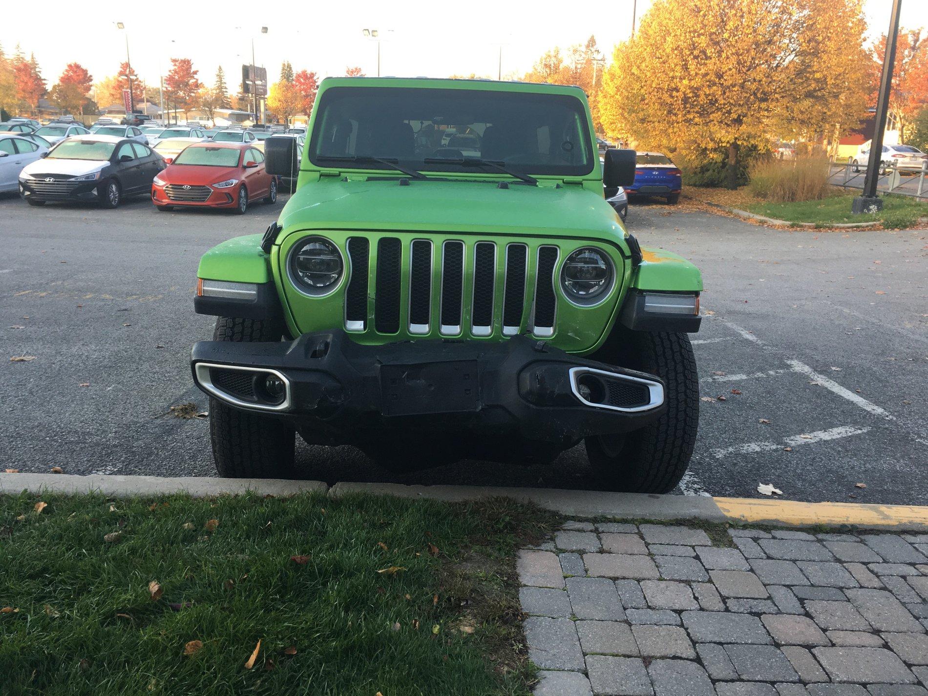

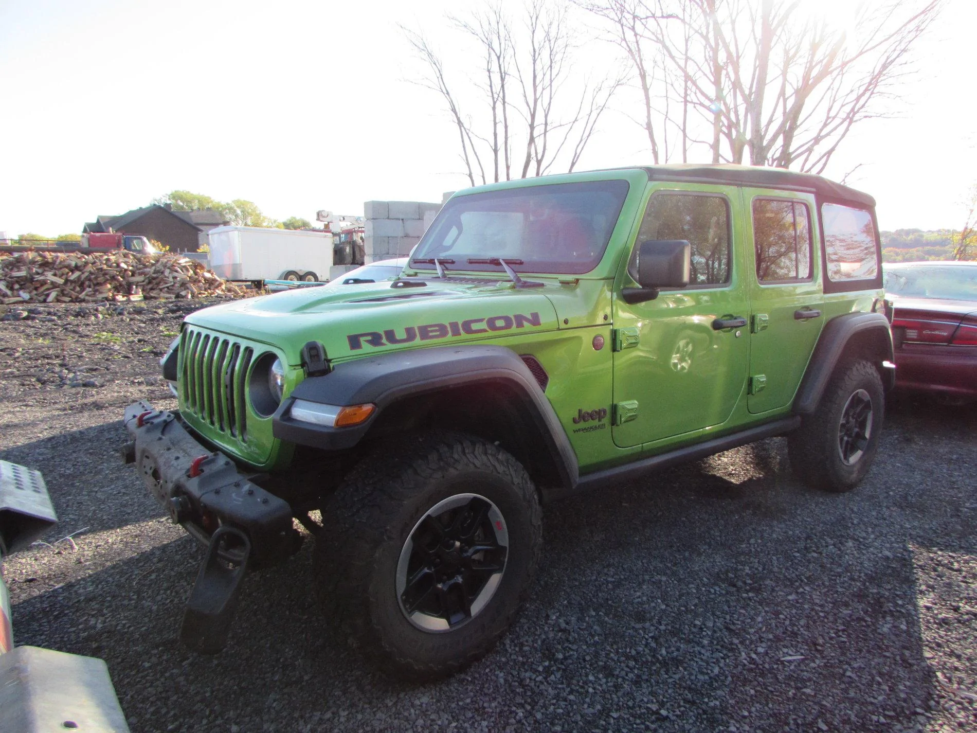

I don't have any pictures yet (and couldn't take any myself), and i know that would get this thread more interesting for you folks, but in any case...
The street lights down where i live were offline today, and the highway had a 4 way stop active (so i-go-you-go). We were back on our wedding anniversary...200m from the house, when it was my turn to cross...a woman in a red car (small 20k buick iirc) apparently didn't see it was a stop sign (even though the other lanes were all stopped) and rammed headfirst into the jeep at highway speed into the left half of the bumper (steel).
The shock was loud, and strong and i was spun around 90 degrees as she crash coursed along the highway about 100 feet further. The bags popped, and my face got the bag on the nose...but otherwise, me and the wife got nothing but a bit of a headache (which is a bit logical given the airbags speed). The medics came in and were amazed at how solid the jeep was...the other car was completely wrecked and the woman carried away by ambulance, i've honestly no idea how serious her injuries was.
The police told me to drive the jeep off the highway, and that's about it for us. I decided (for insurance purposes) to have the jeep inspected in depth because we never know what damage could be lying under there, but we are safe and sound, and not in a hospital...and we'll still get to celebrate our wedding anniversary tonight.
I know cars are supposed to crump and all, but...after what i saw today, i can't help but think that any "soft" car would have been much worse.
Stay safe guys
Edit: here are some pictures. In retrospect, the impact was obviously angled, not full frontal, otherwise the other car wouldn't have "slided" on the bumper as it did. Still impressive to me.
