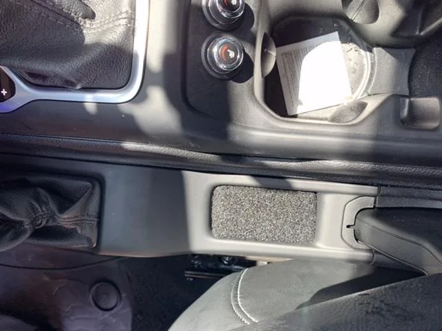

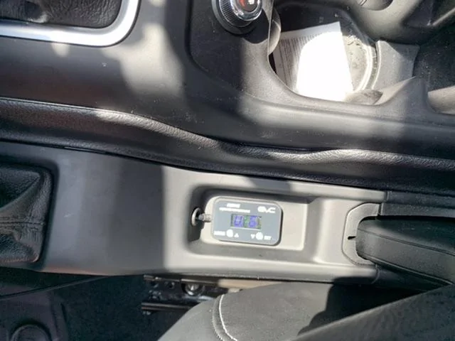

I found a good spot to mount your iDrive / throttle controller. For mine, the little plastic trim comes right off the shifter housing and the small area under the e-brake is the perfect size. I drilled a small hole, added a rubber grommet, and then secured the wires with zip ties. There is a little rubber piece that sits in the area and can be removed to stick the controller down, however, I flipped it over, added some velcro (fuzzy side) to the underside of he rubber piece and it makes a perfect cover. Since I don’t change settings often, this is a good place to keep it safe and out of sight.
