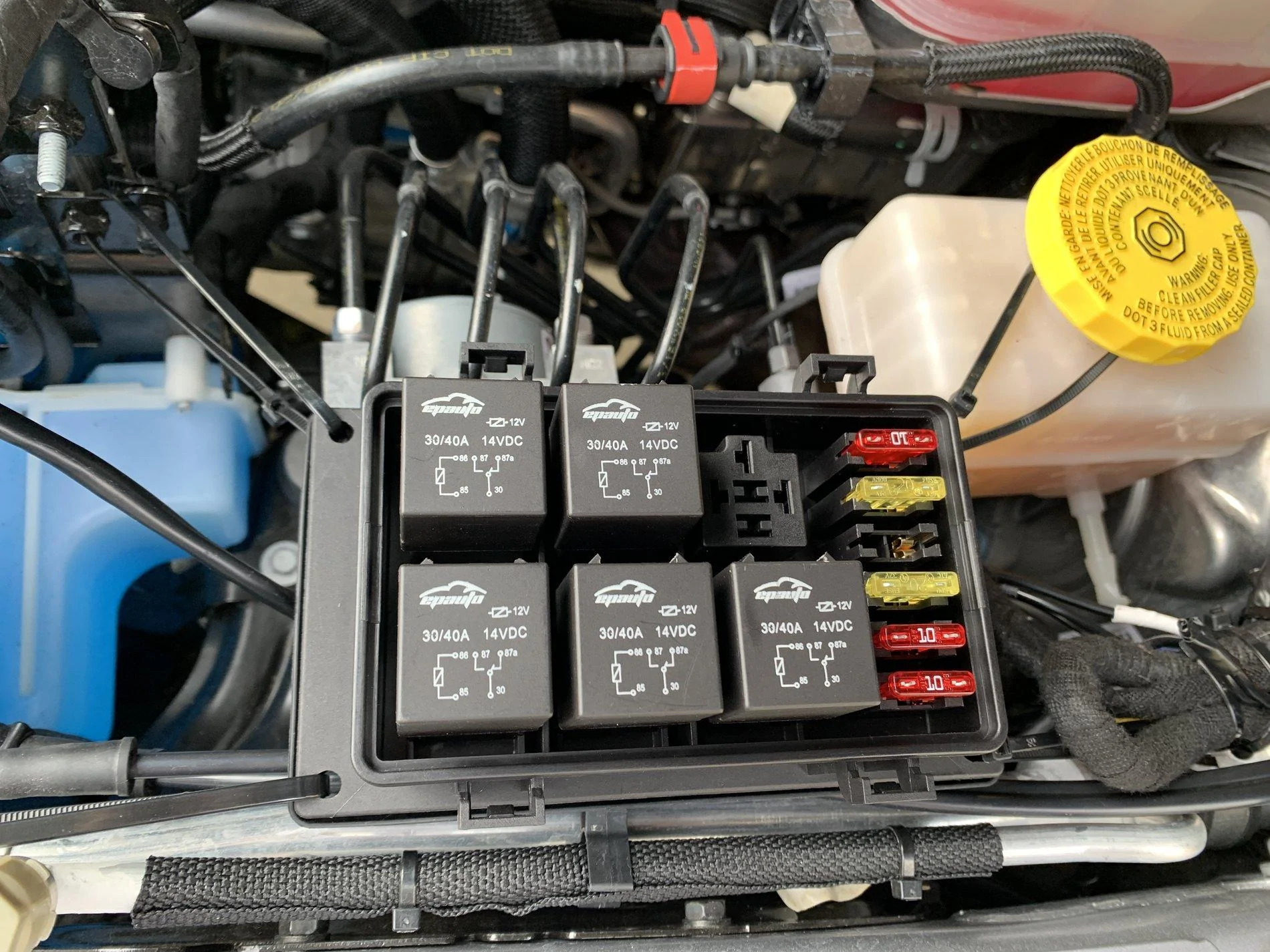

I used a small little fuse for the ACC (little box with blue pig tails), this is actually ok as I’m able to tap all my ACC needs from here and I’m using the Quadratec T harness for clean signal. I ran the 1 main wire to the box, joined one side, then pigtailed and fused all the way down.

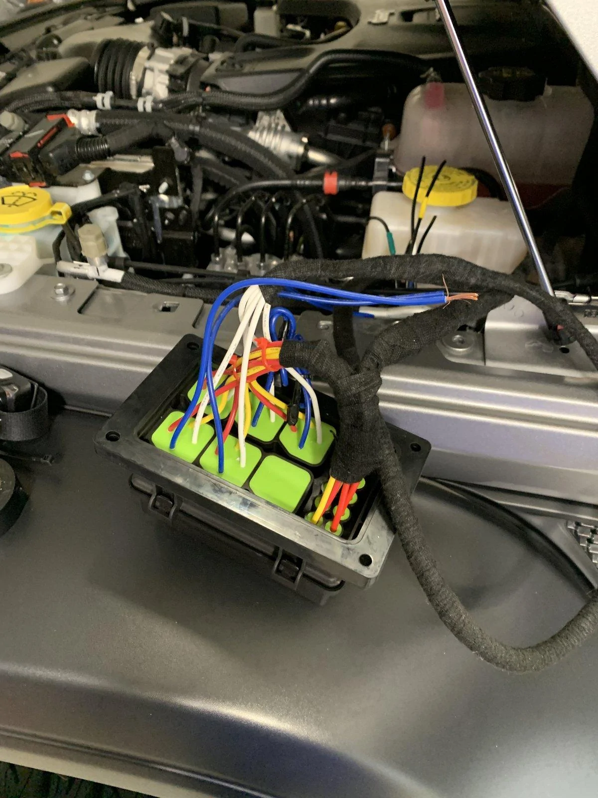

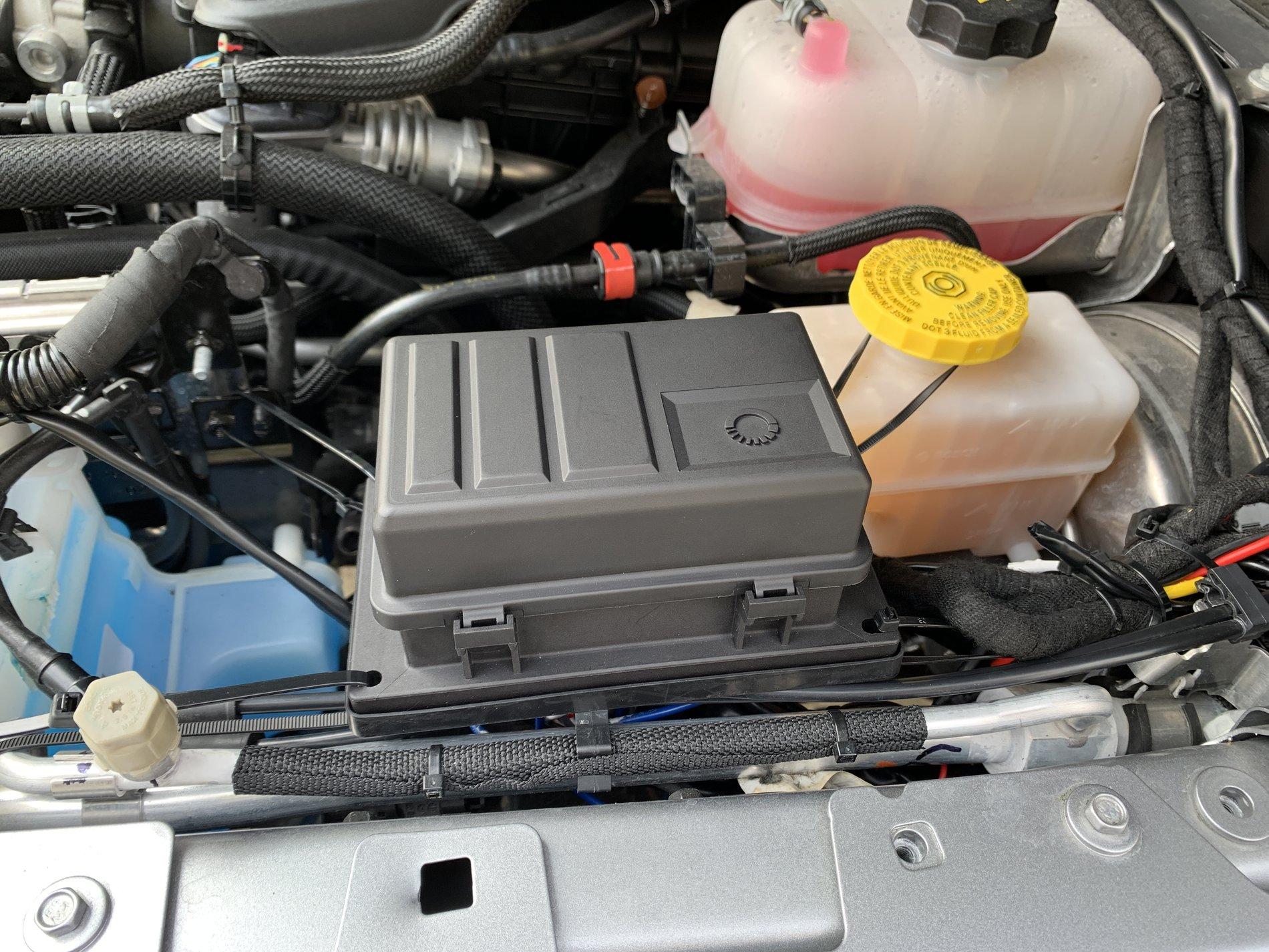

I’m also using a box for my Alpine relays, this is ok, although my zip tie harness is in need of help. I do enjoy being able to control lights from the head unit.

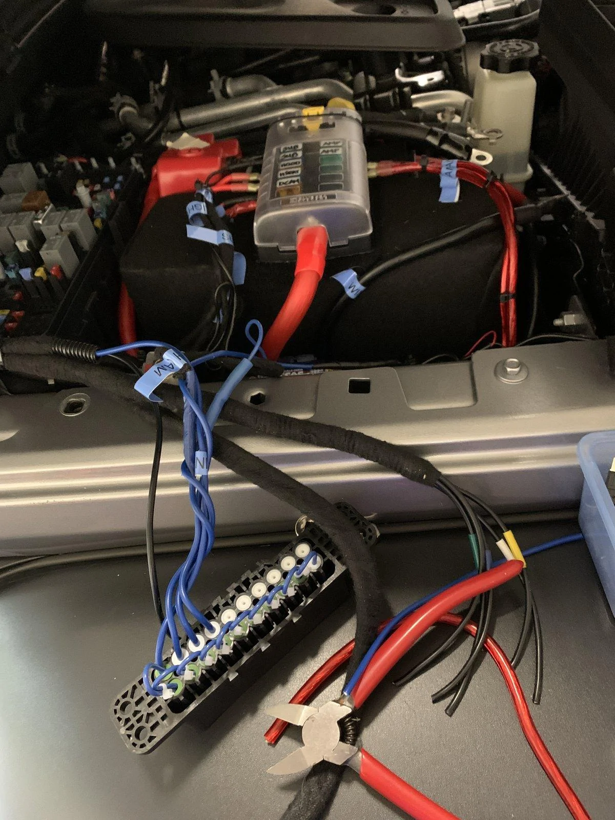

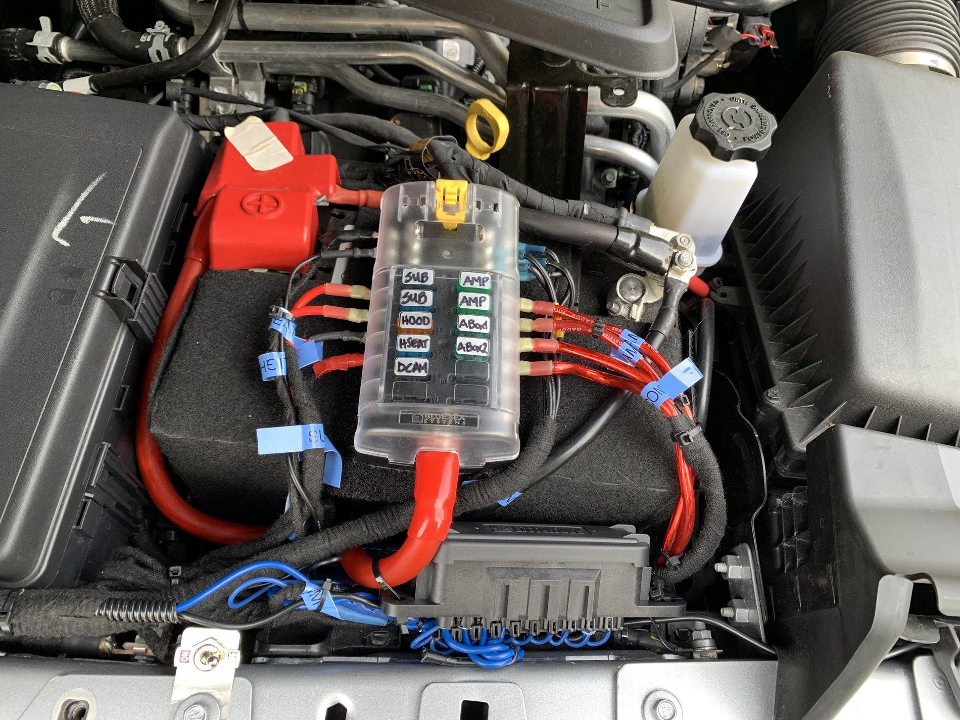

but... while I’m using the marine blue sea system power distribution block, I need ideas on a better path forward. This is too busy. Ideas are appreciate.
