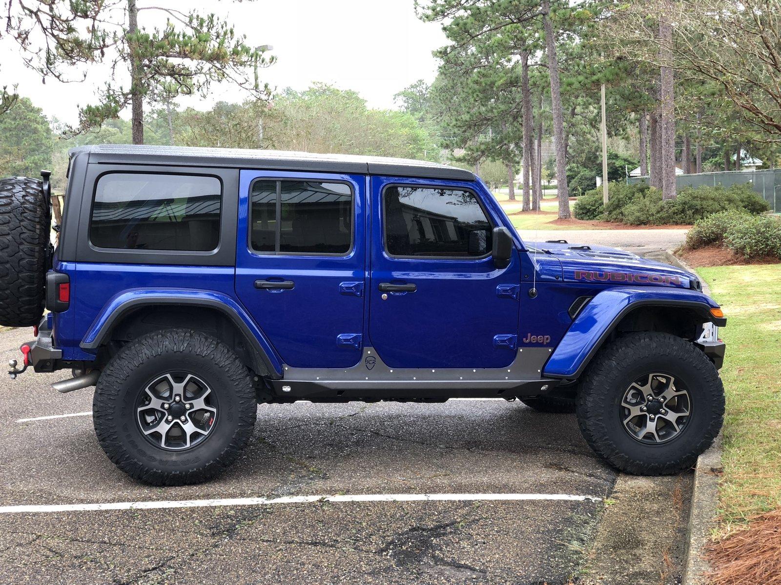

OK folks, here's my current "build list" if you will.

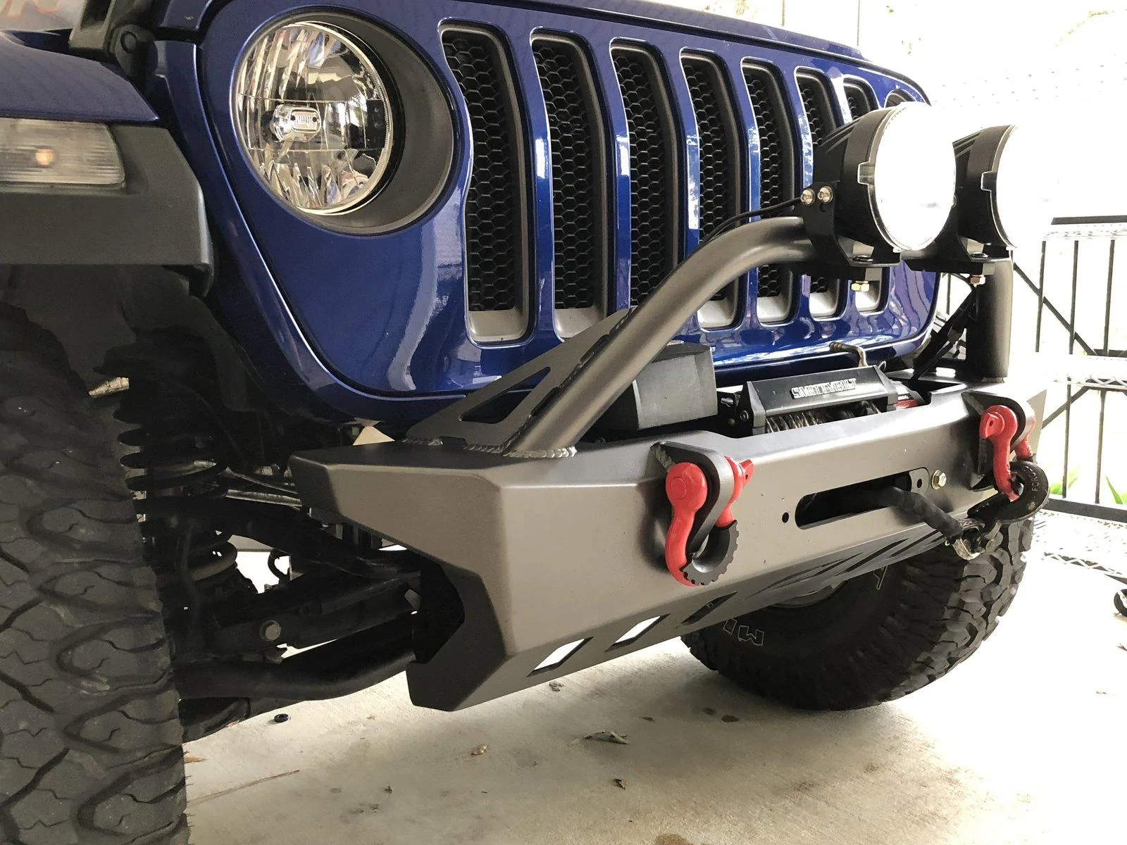

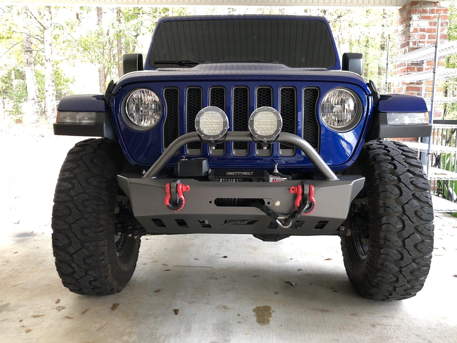

  1. Motobilt Crusher Front Bumper with Bull Bar

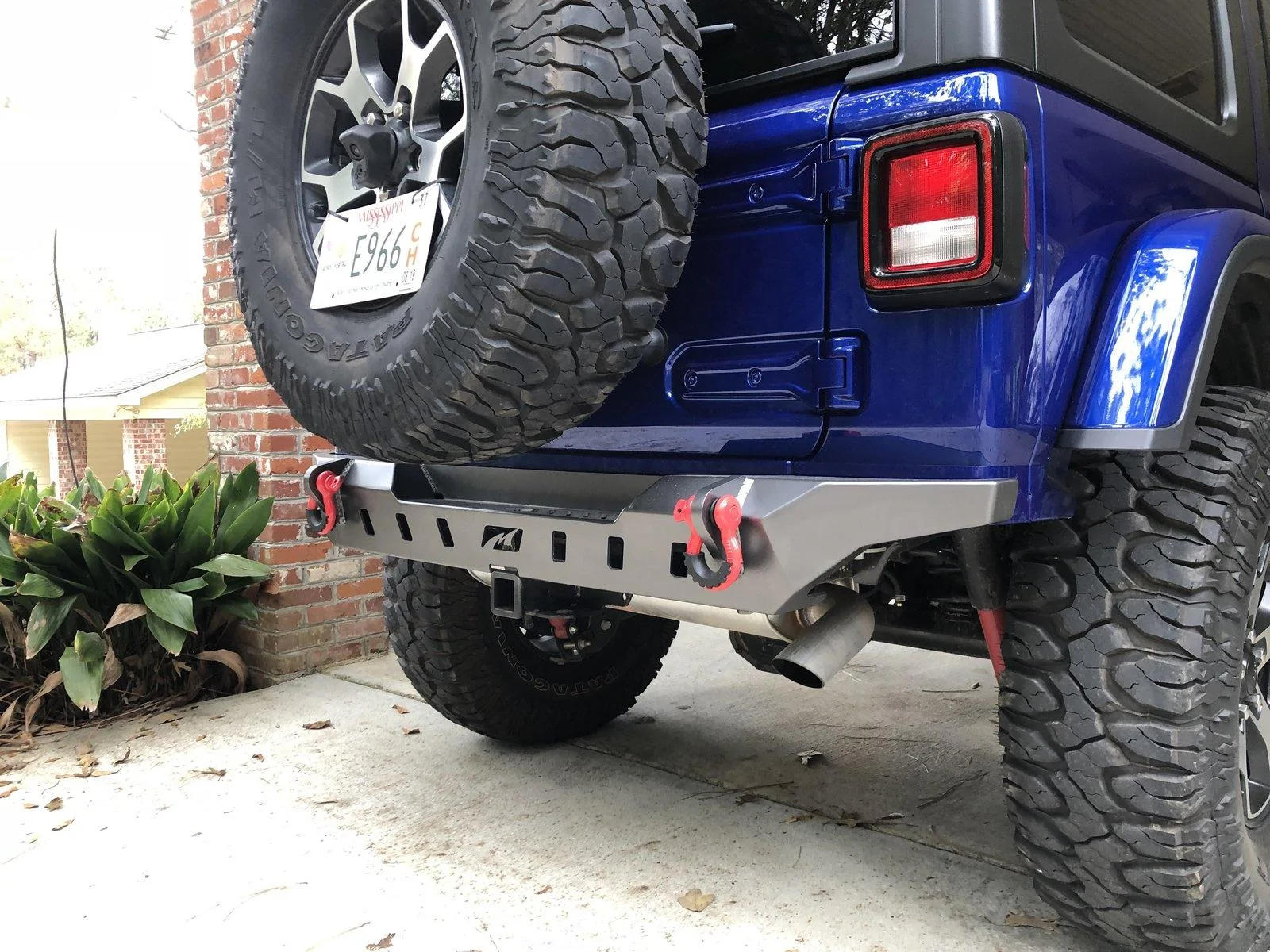

  2. Motobilt Crusher Rear Bumper with Spare Cutout
  3. Motobilt Front and Rear Diff Covers (Painted not yet installed)

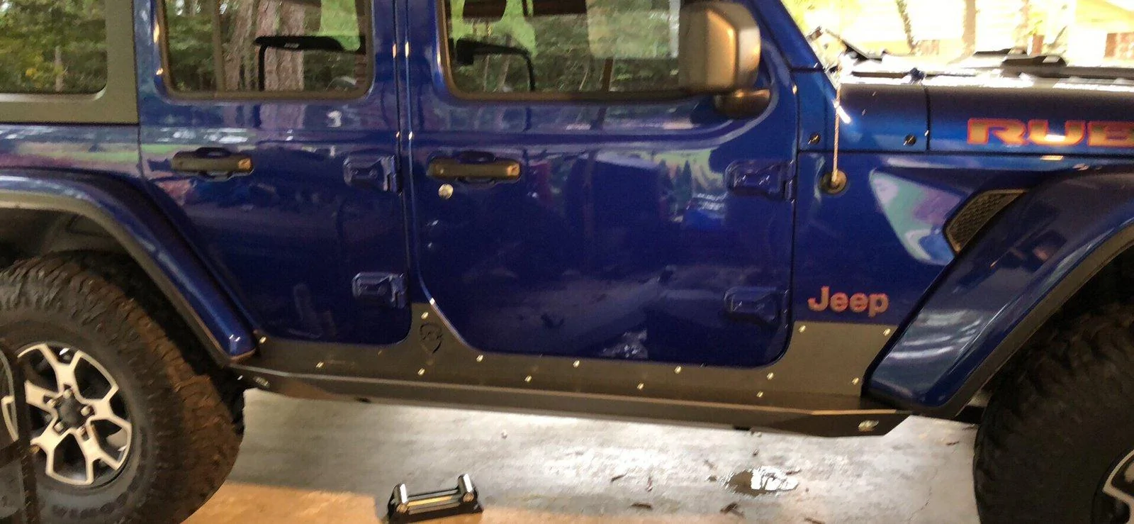

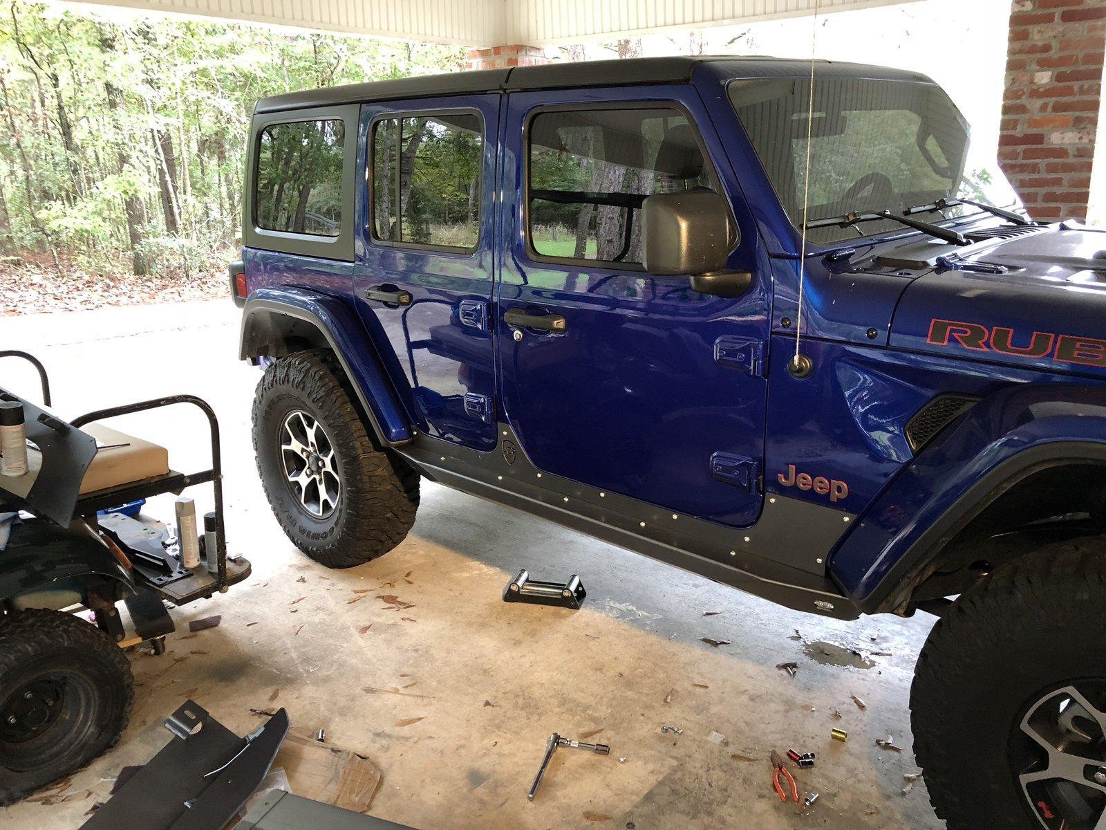

  4. JCR Crusader Sliders/Rocker Armor
  5. M.O.R.E Gas Tank Skid
  6. M.O.R.E Transfer Case Skid
  7. M.O.R.E Trans/Oil Pan Skid
  8. M.O.R.E Evap Shield b/c... why not
  9. Rough Country 2.5" Budget Boost (went cheap to see if i wanted a 2.5 or 3.5 lift... I want 3.5)

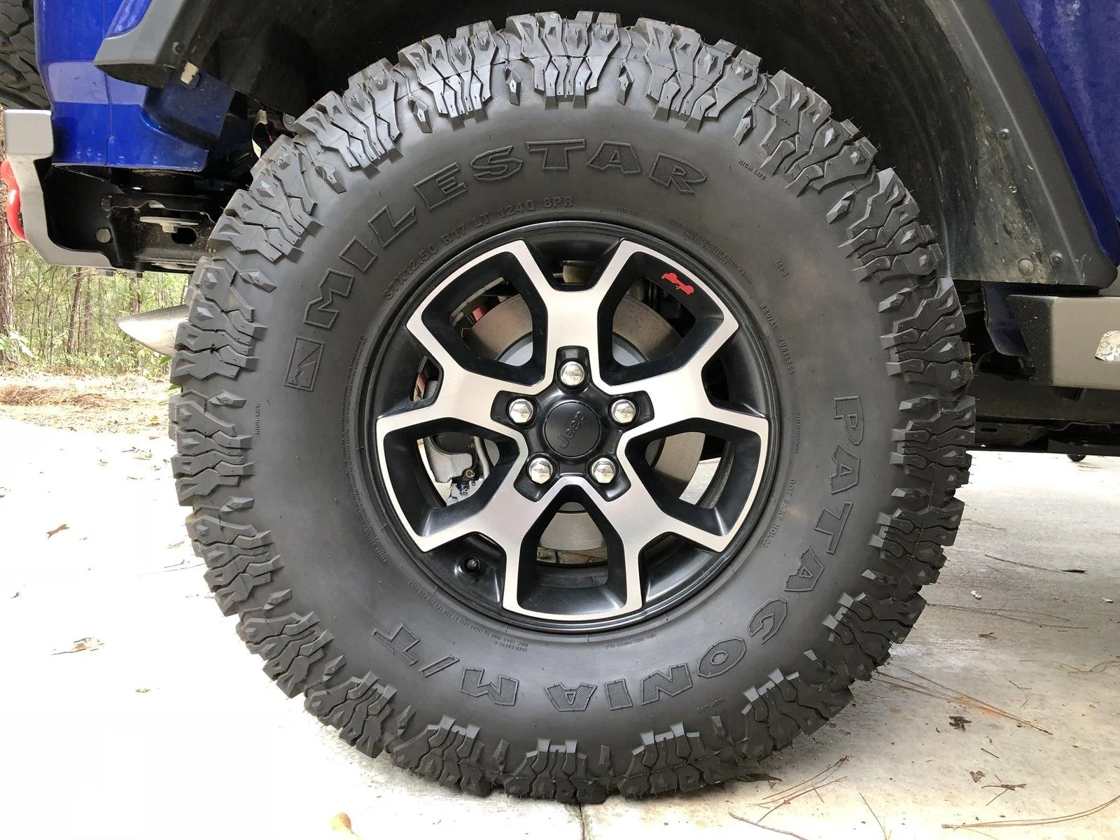

  10. Patagonia Milestar MT 37x12.5x17 on Stock Rubi Wheels

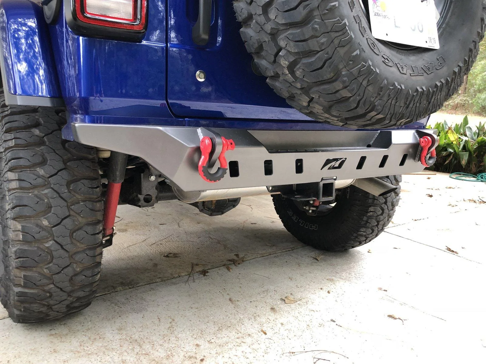

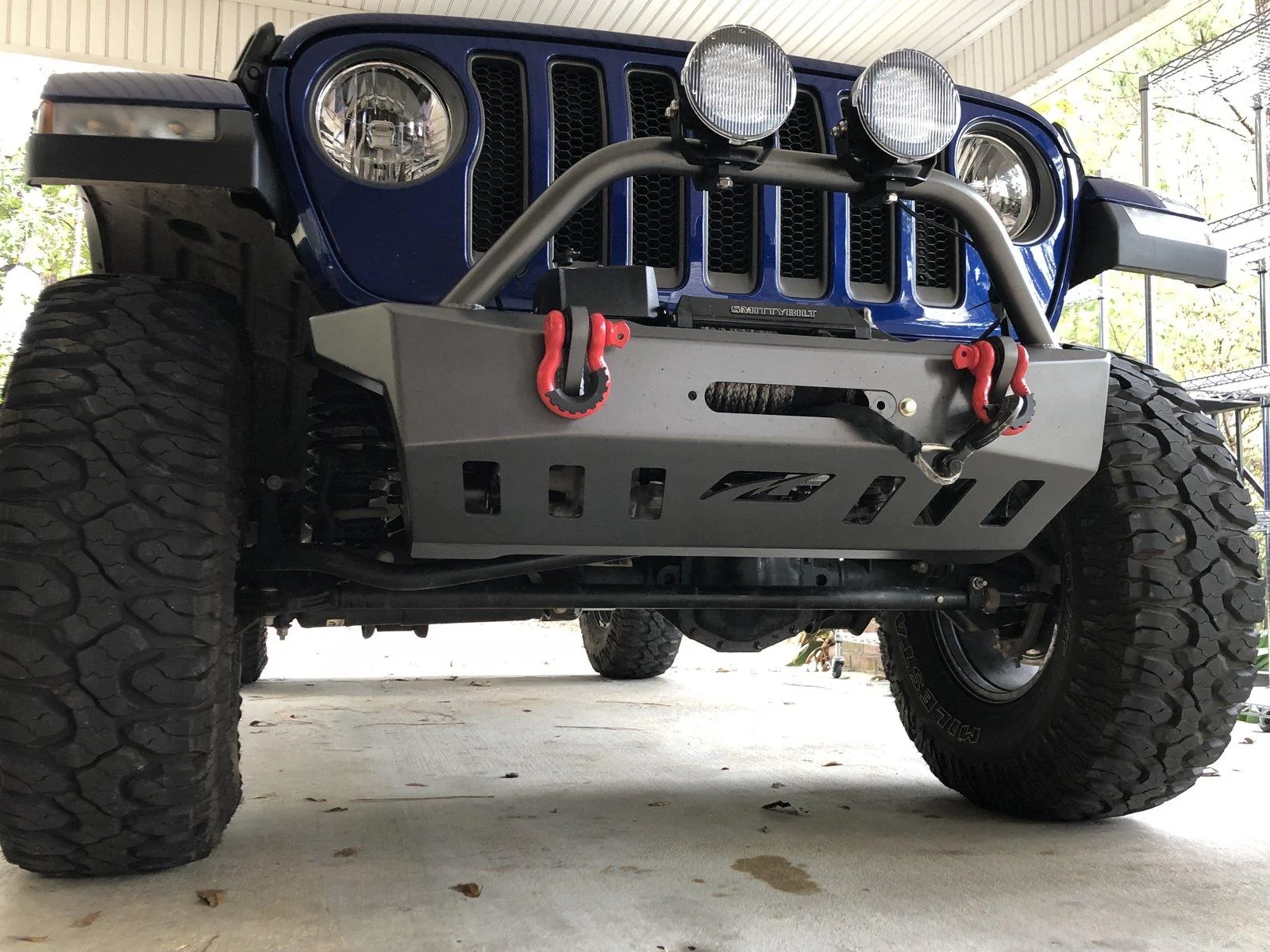

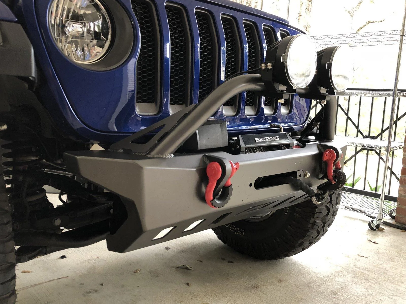

Motobilt Bumpers and Diff Covers
The welds are super impressive, part of me wanted to leave the bumpers raw, but i decided to paint them "Black Stainless Metallic" which pretty well matches the JEEP logo on the side, and grill/headlight inserts. The bumpers installed super easy, everything lined up, and IMO looks great on the Jeep. These dudes are well built and will for sure upset whatever I decide to smack them against. I more than likely will be adding the MotoBilt tire carrier when they come out with it. @Motobilt

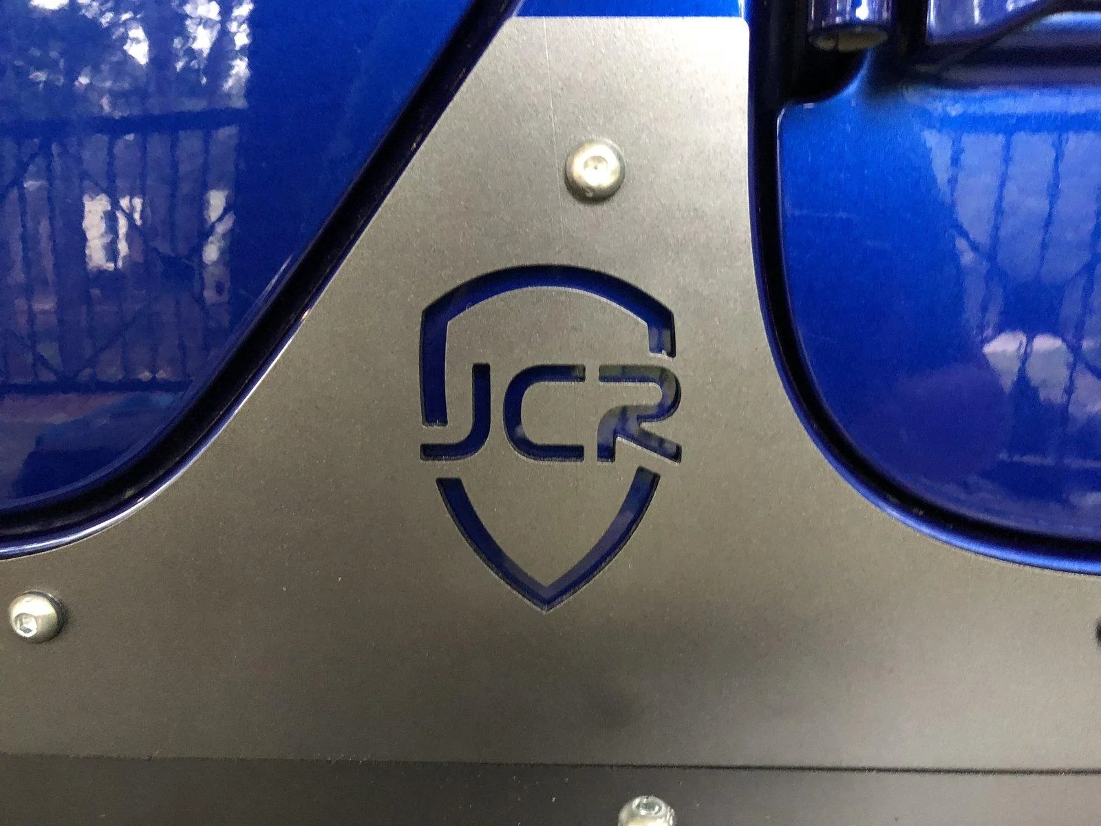

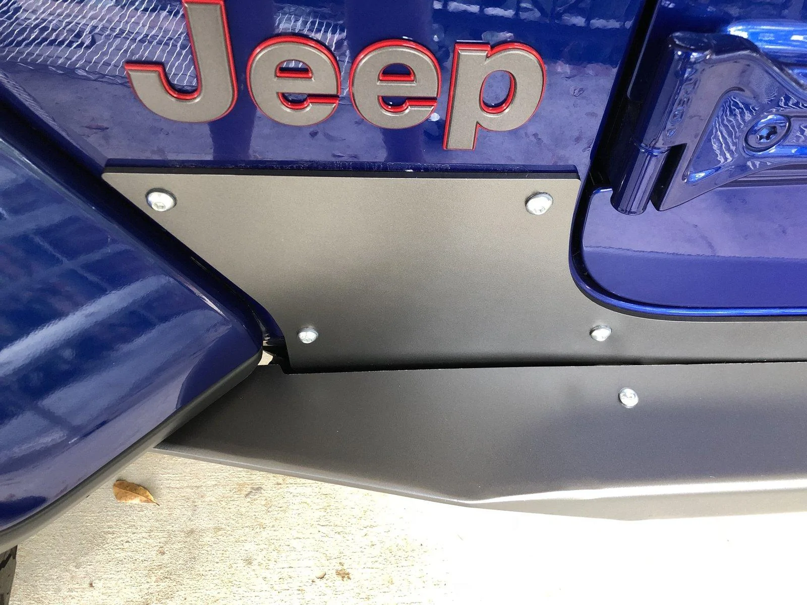

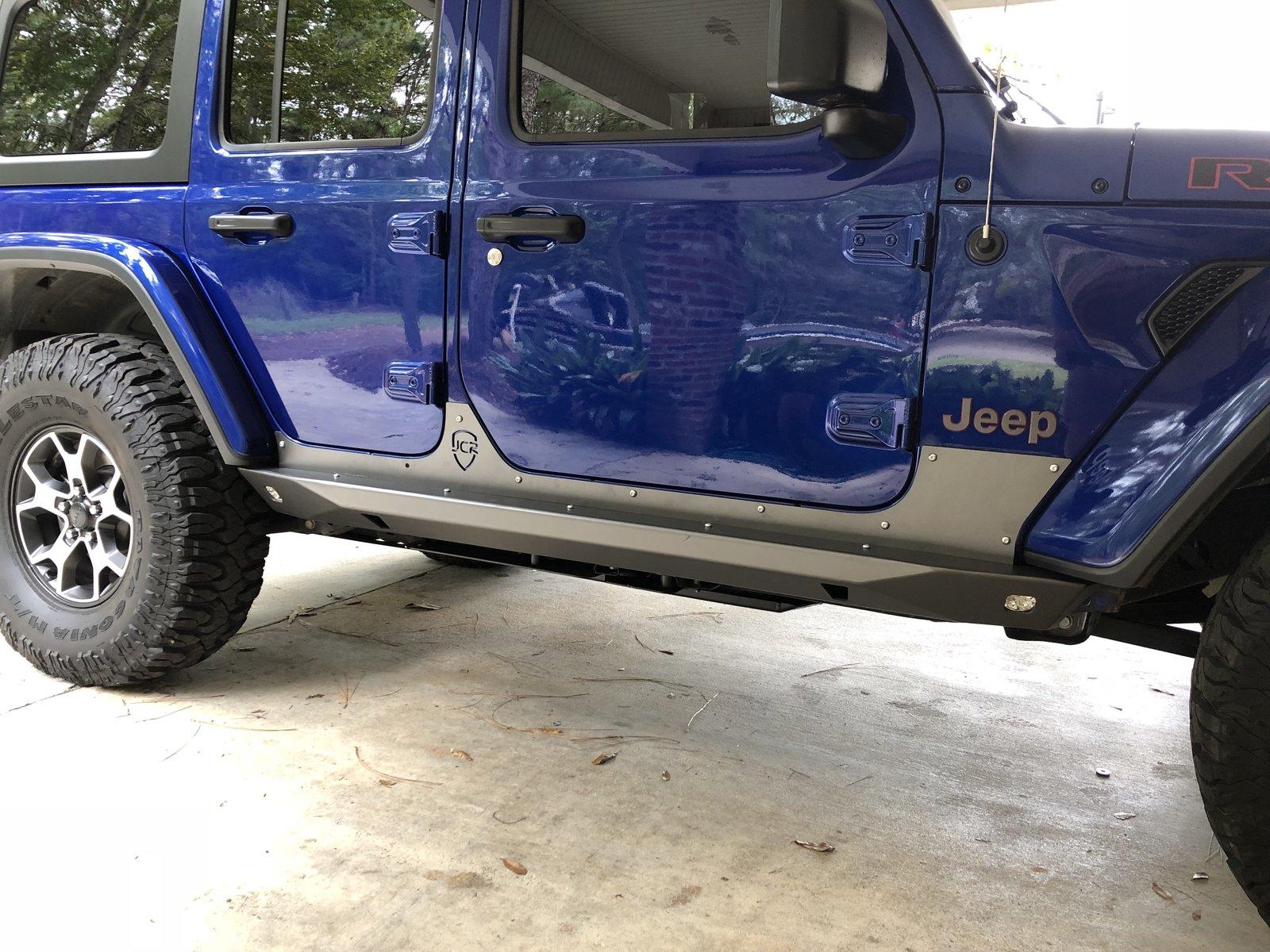

JCR Crusaders Sliders
I wasn't as happy with what I got here. These aren't cheap sliders so I had high hopes for the fit and finish and was kind of let down. I know these are hand made, but the shaping grinds didn't look to be "finished" and some of the angles were a bit off when comparing the left to the right side etc. My biggest issue is the gaps on the ends where the actual slider pushes up against the rocker armor. On my drivers side i've got a > 1/4' gap that i'm not stoked about. now... dont get me wrong, these suckers are built like a tank and will protect the underside from whatever i decide to high center on :) just wasn't happy that I had to do so much finish work on them before i could prep for paint etc. I will end up finding some bulb end trim to even out the gap between rocker armor and slider. @JcrOffroad

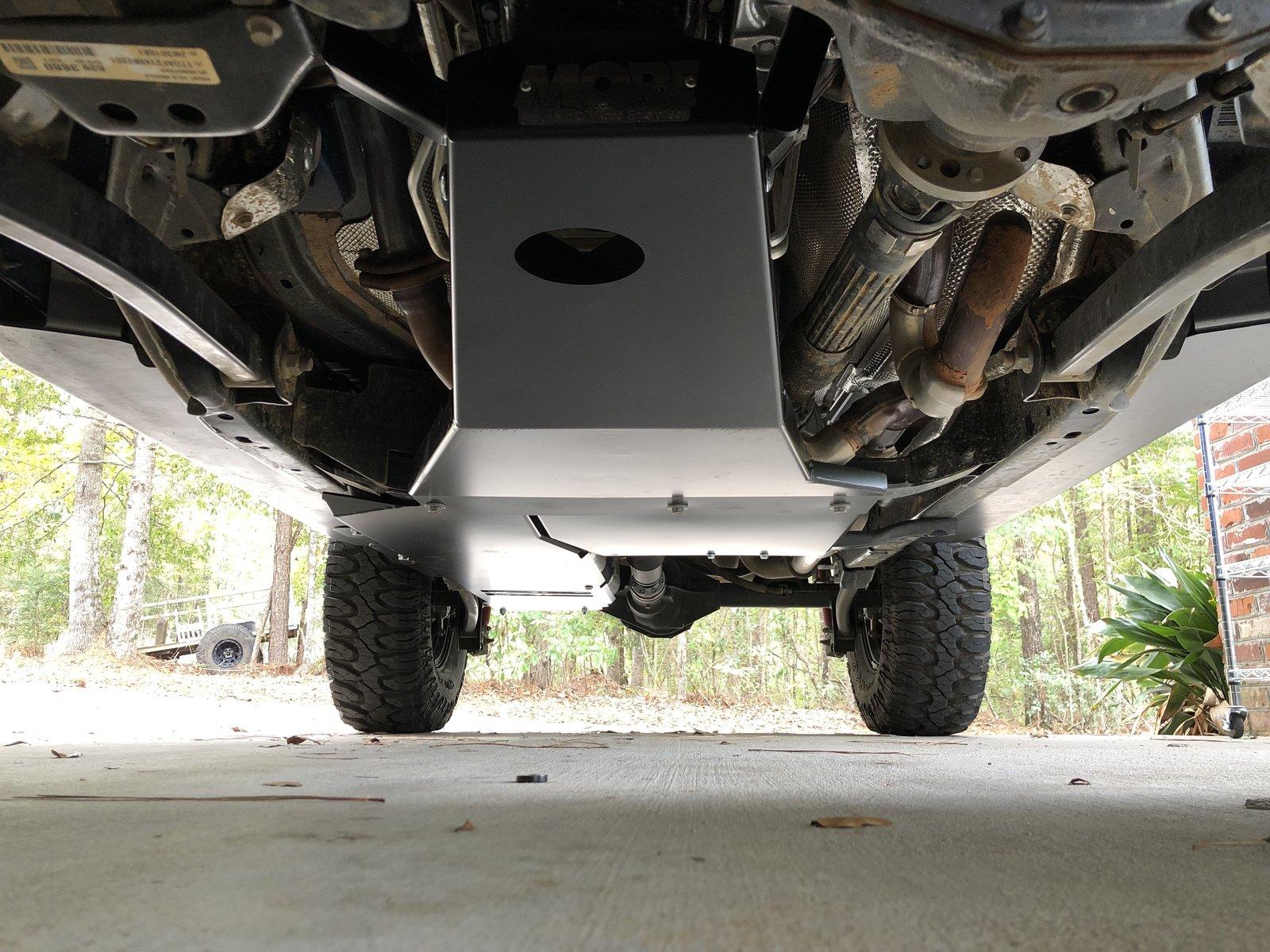

M.O.R.E Skids

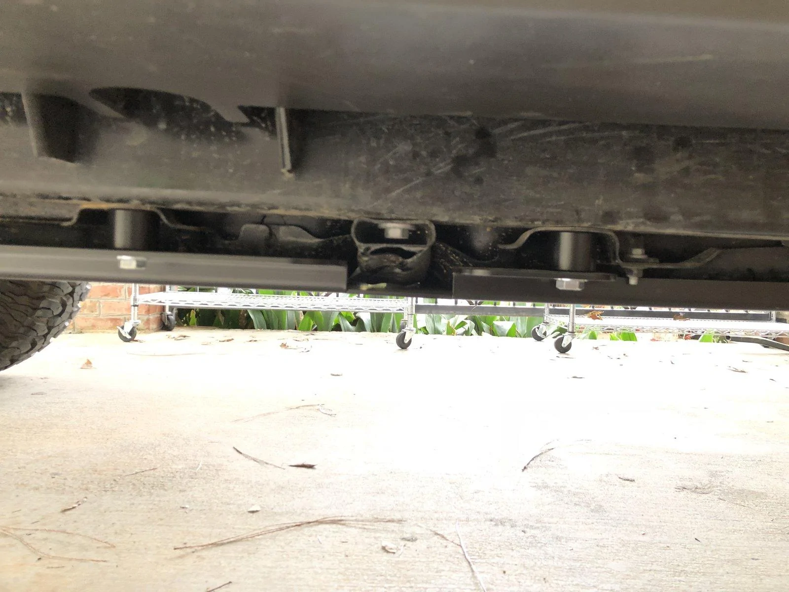

For the price, IMO these can't be beat. They installed easily and have great coverage under the jeep. My only issue was with the gas tank skid. The back of the skid has a "triangle mount" that is attached by dropping carriage bolts down from the top leaving the threads and nuts dangling (go ahead and giggle) under the jeep. The location (super close to the rear passenger tire) means that more than likely the will never drag, but it just isn't appealing. I will more than likely weld the bracket to the skid and remove the carriage bolts there.
The only other issue that isn't really an issue is the spacers they used to mount the gas tank skid to the frame. I would have preferred the mounting points be either boat sided or press braked to actually bolt directly to the frame vs using a 1" aluminum spacer. No clearance is lost and it's not really an issue.... I also wish instead of reusing factory bolts, they would have supplied the recessed "skid" bolt that Rock Hard offers on their skids. I'm having a hard time sourcing them locally.

Patagonia Milestar MT Tires
Was turned on to these by @Kevin8086 and man... super stoked about it. Super quiet on the road, killer grip in the rocks, and a price that just can't be beat. Thanks dawg.
Sorry to hear about the gap issues with the install. We think it could be caused by a variance in the support brackets that mount from the pinch seam to the inner skin. To verify, you could loosen the mounting bolts into the pinch seam and mock the outer up, that gap would then close significantly. It's just a variance issue between Jeeps that we have seen a couple times. Please feel free to contact our tech department to get the ball rolling on a solution at 269-353-1184 or [email protected]. Once again, very sorry for the issues!
Bringing this to PM. Thanks for reaching out.

Loving the build, dut holy hell you have some balls. I still can't bear to drill into the body yet.
imagine my surprise when the sliders didn't line up perfectly after mounting them up!!! but we will figure them out.
