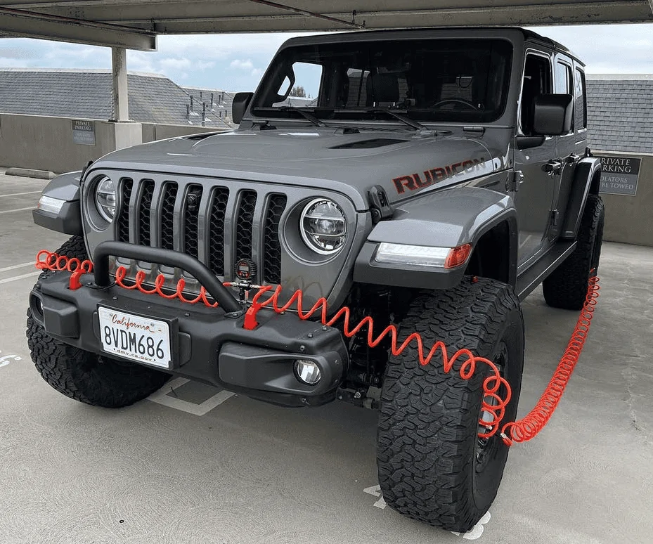

IMO 20psi isn't ideally low enough for sand and isn't high enough to prevent premature tire wear on pavement. If time and convenience are a priority, I would say to get some TeraFlex Nomad wheels for quick airing down and an onboard twin compressor and a 4 wheel Speedflate for airing up. That way you are less than 5 minutes going up or down with your tire pressure. Then again, you can buy a lot of replacement tires for what that setup costs.
I agree - get a good airdown and tire inflation system, and it'll not only be no big deal to air down and up, but it can actually be kind of fun in my opinion.
I use Staun tire deflators for airing down, and it couldn't be any easier. Just screw them onto the valve stems, and let them do their thing. They stop at whatever pressure you set them to, in my case 15psi. You don't even have to wait for them to deflate, you can hop back in and start driving as soon as you put them on, and even keep driving around with them on after they're done deflating, if you want.
For airing up, I permanently installed and hard-wired my 10.6CFM compressor, so all I have to do is connect the 4-tire hose system to the tires, flip the switch, and give it about 5 minutes to reach 30psi, switch it off, throw the hoses in the trunk, and go.
Much better solution, in my opinion, than trying to find a tire pressure that is acceptable for both sand and pavement, which doesn't really exist.
