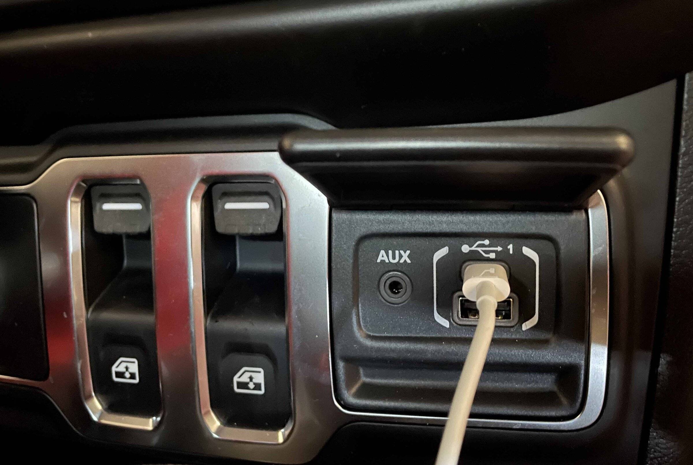

First, your Android phone almost certainly has to be connected to the display via a cable. I don't know how old your phone is, so here there is some guesswork, but I believe that most newer Android phones use a usb-c connector. And the wired connection has to be to the proper usb connection in the Jeep. Again, I don't know what year or model of Jeep you have, but on my 2022 Wrangler Sport S the connection is on the passenger side of the dash. See the photo below.
