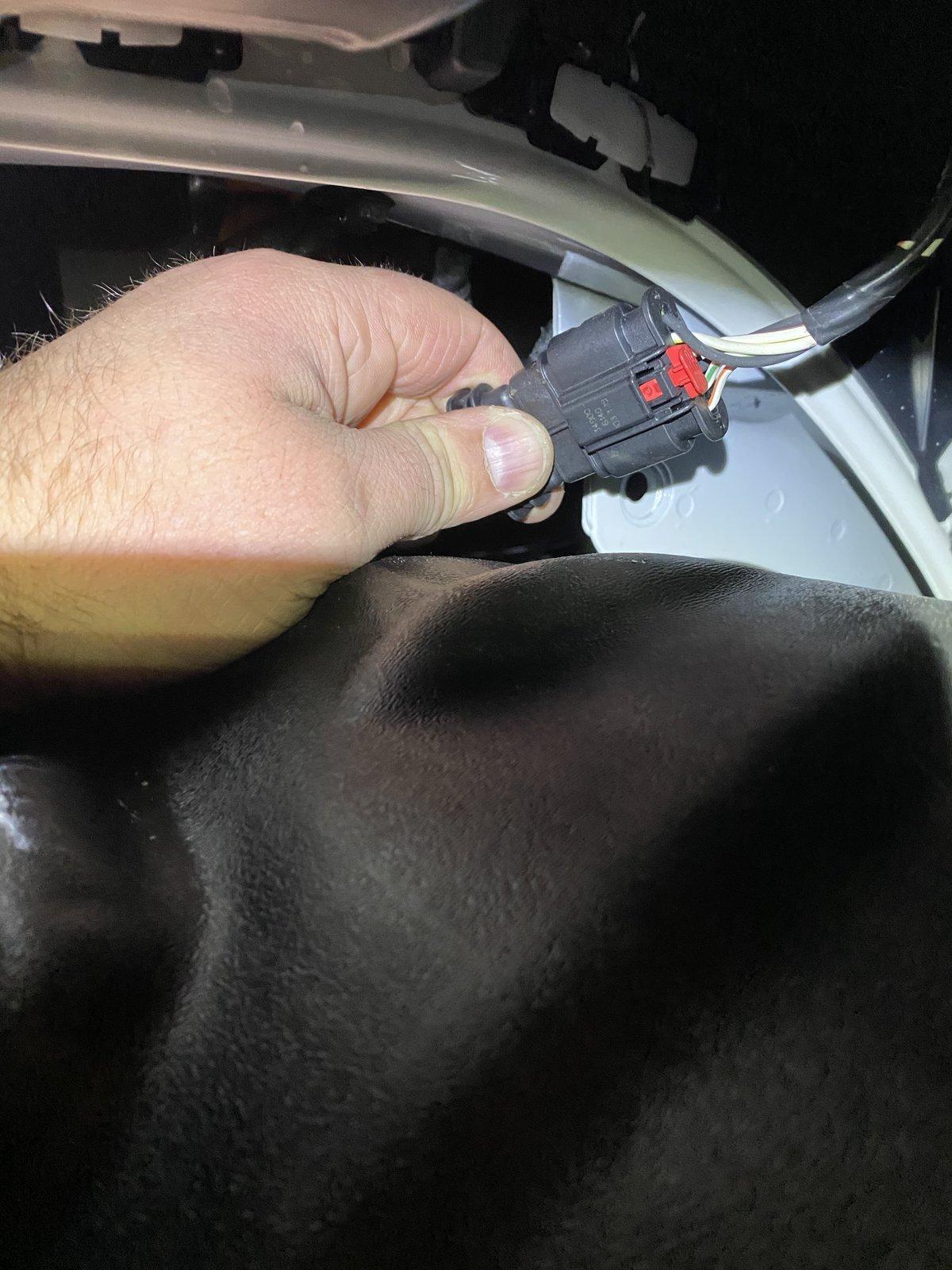

How do you unhook the turn harness?

How the heck do these seperate!?!? I pulled the red tab and this one just won’t let go...the other one did after just fumbling for a while I’ve poked and prodded and it won’t separate! What am I missing!?!

Nothing... I had a hard time with mine also.... just keep working it out. ...

If I remember right you see where you picked up the red clip, you squeeze the gray/Black where it slides down into and than pull apart at same time

So I stuck a screw driver in the slot right above the red slider and it cracked and came off nice and easy. only affected the old harness new one plugged in just fine....if your in the cold and desperate I recommend this!

For future reference to anyone searching for this answer, to unlock the connector you pull back on the red tab to unlock the connector and then push down/squeeze the black "U" shaped plastic that goes over the red lock.

Also you can use a small pick or something pointy to push down that red square in the middle.
