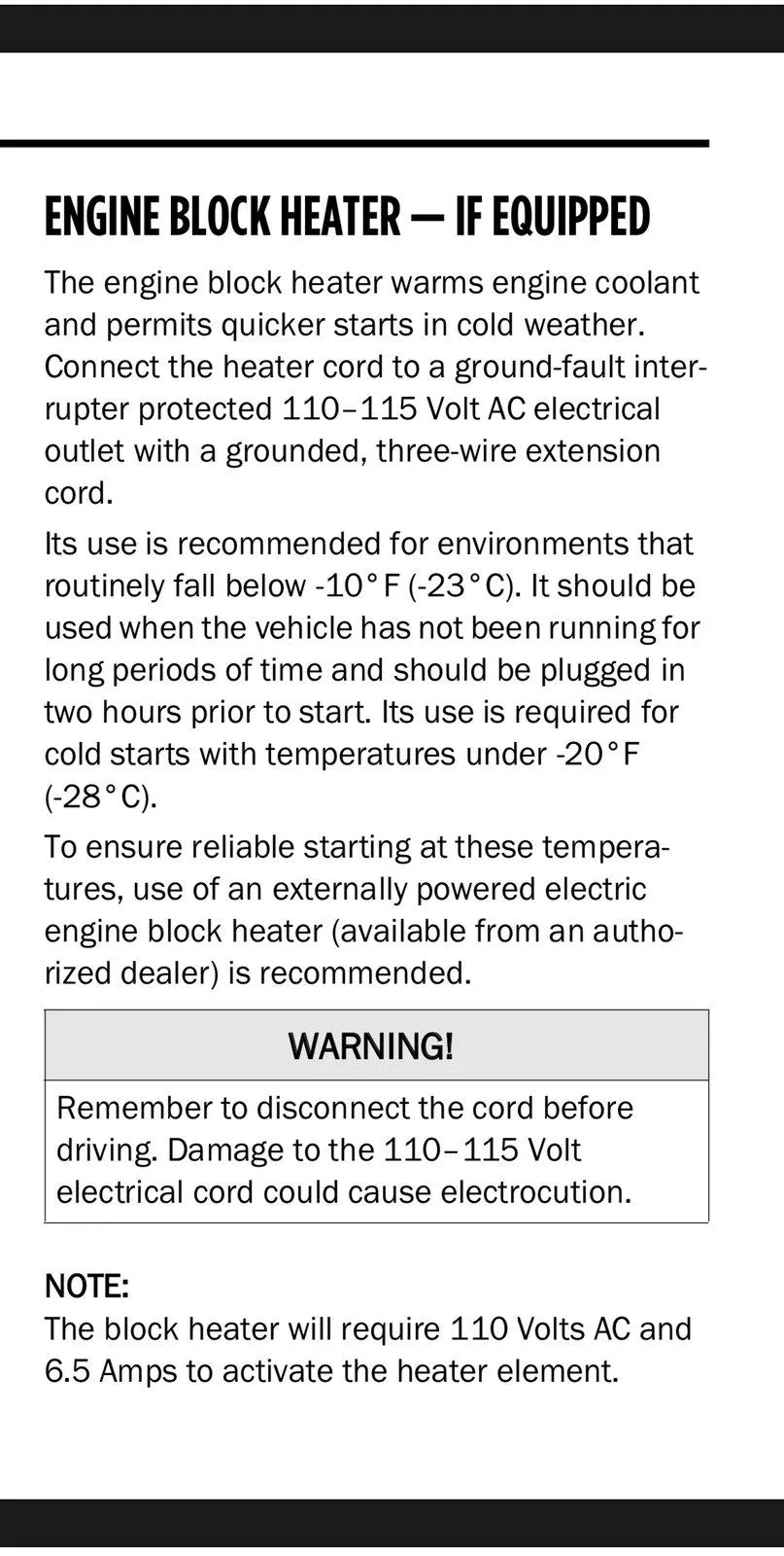

Off the manual.
I noticed this when I was perusing the supplement manual and thought to myself, define “required”. As in the damn thing is programmed not to start if the thermometer reads below -20F and the block heater isn’t plugged in? I will be parking my rig below -20F far from electricity at times so I guess we’ll find out one way or another. Somehow I doubt Jeep has the balls to disable a vehicle from starting just because it’s cold. My guess is the lawyers recommended that wording so they could reduce legal exposure for accelerated wear or failed parts in extreme cold.
