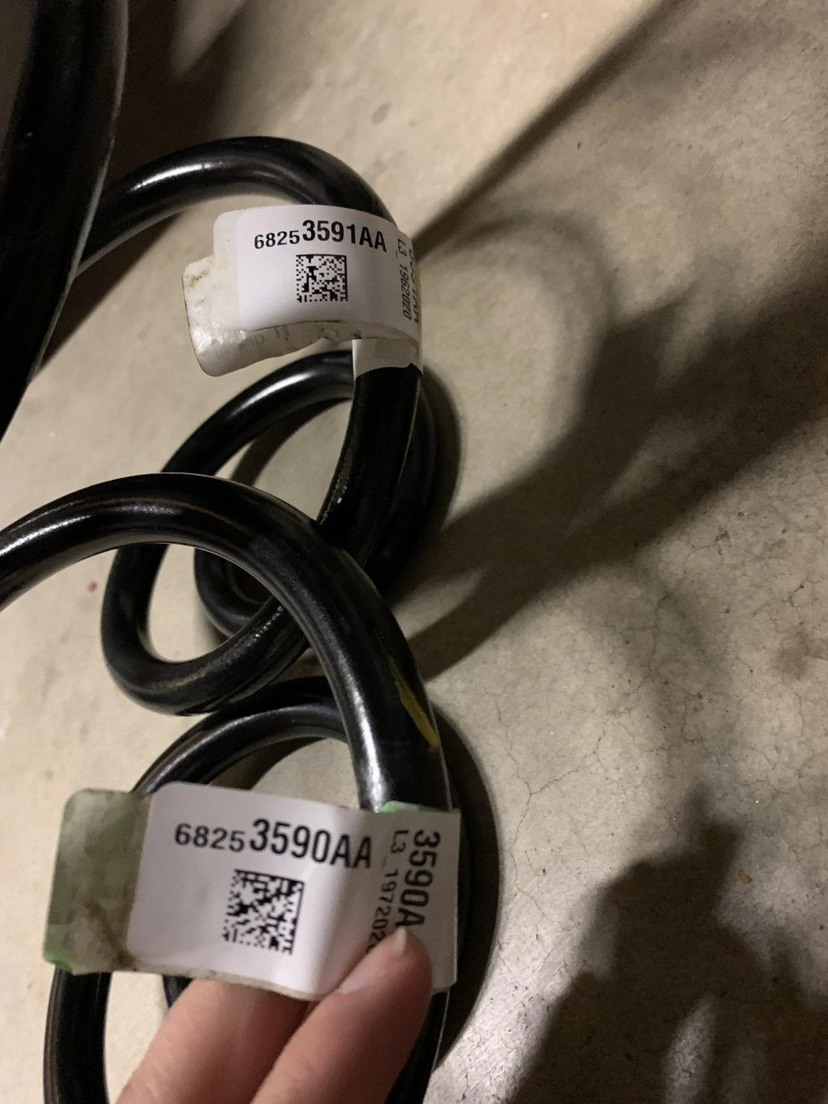

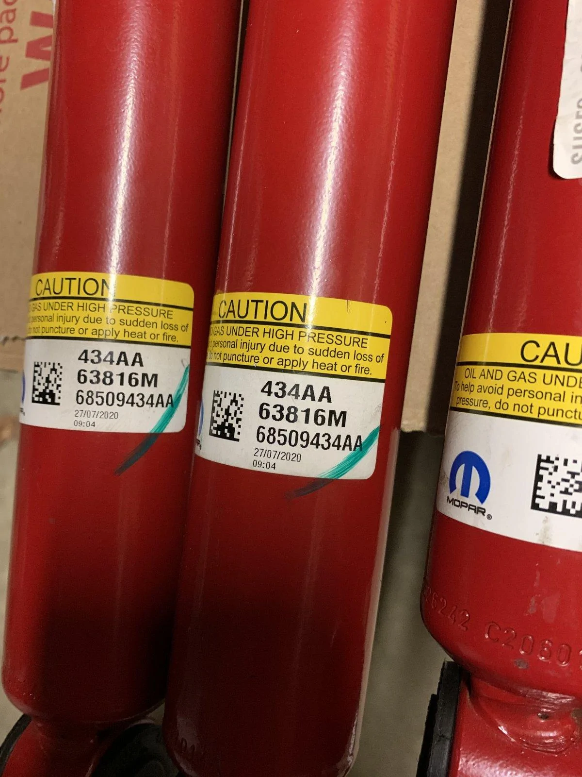

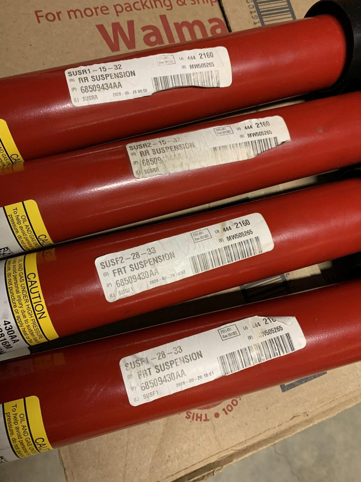

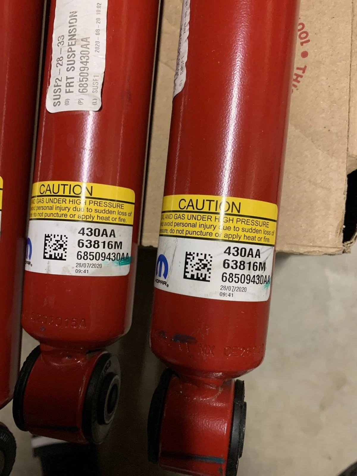

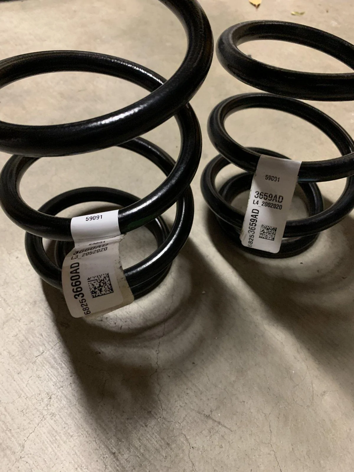

Hey guys! So I’m getting ready to do my swap soon but wanted to see if you could help me figure out the proper sequence of the shocks and springs. How do I tell which ones go in the front or rear and drivers side/passengers side? I’ll post numbers below

The higher digit is the passenger side.
59=LF
60=RF
90=LR
91=RR
For the shocks, on my shocks it had an R or F for front or rear on the part number sticker. But an easy way to tell is; longer shocks for the rear, shorter shocks up front. They’re not left and right specific.

Awesome! This is exactly what I was looking for. Thank you!
