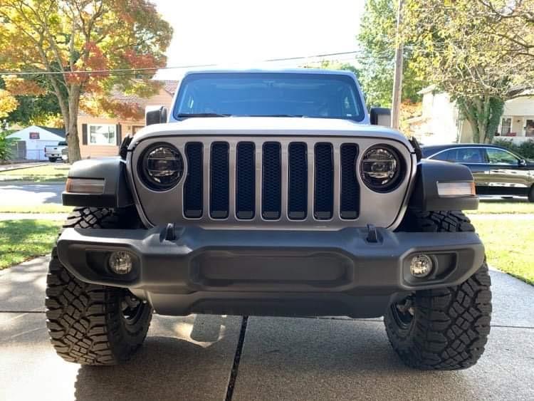

Two weeks ago I installed Mopar LED headlamps on my 2019 JL Altitude Sport. The headlamps are 2020 JLUR takeoffs, I DID NOT run the extra wire for the halos but I DID have the dealer flash and it didn’t correct the following issues:
  1. Passenger low beam occasionally shuts off after flashing the high beams or using the turn signals. The Jeep requires restart for the passenger side to come back on. (I replaced the passenger headlamp once already, it’s not the headlamp.)
  2. High beams light up distant but nothing immediately in front of the vehicle as the low beams turn off completely when the high beams are turned on. Only the projectors work when the brights are on.
