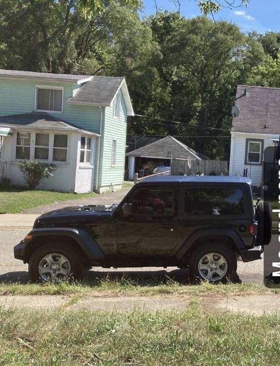

I have 2 door 2022 jl sport,
Jeep Wrangler JL Help please!!!! 634CB5D0-C701-46A9-89DD-6538A2B2E005
Can I run 35s on 2.5 lift? Or could I run 37s on 3.0 lift?
Jeep Wrangler JL Help please!!!! 17BF6632-7DE9-4A15-8C37-77639895FB52
Concur with previous post ^...
Teraflex doesn't sell lawn mowers though. Lol. Just teasin'.

We're gonna need to see that picture a third time to determine.

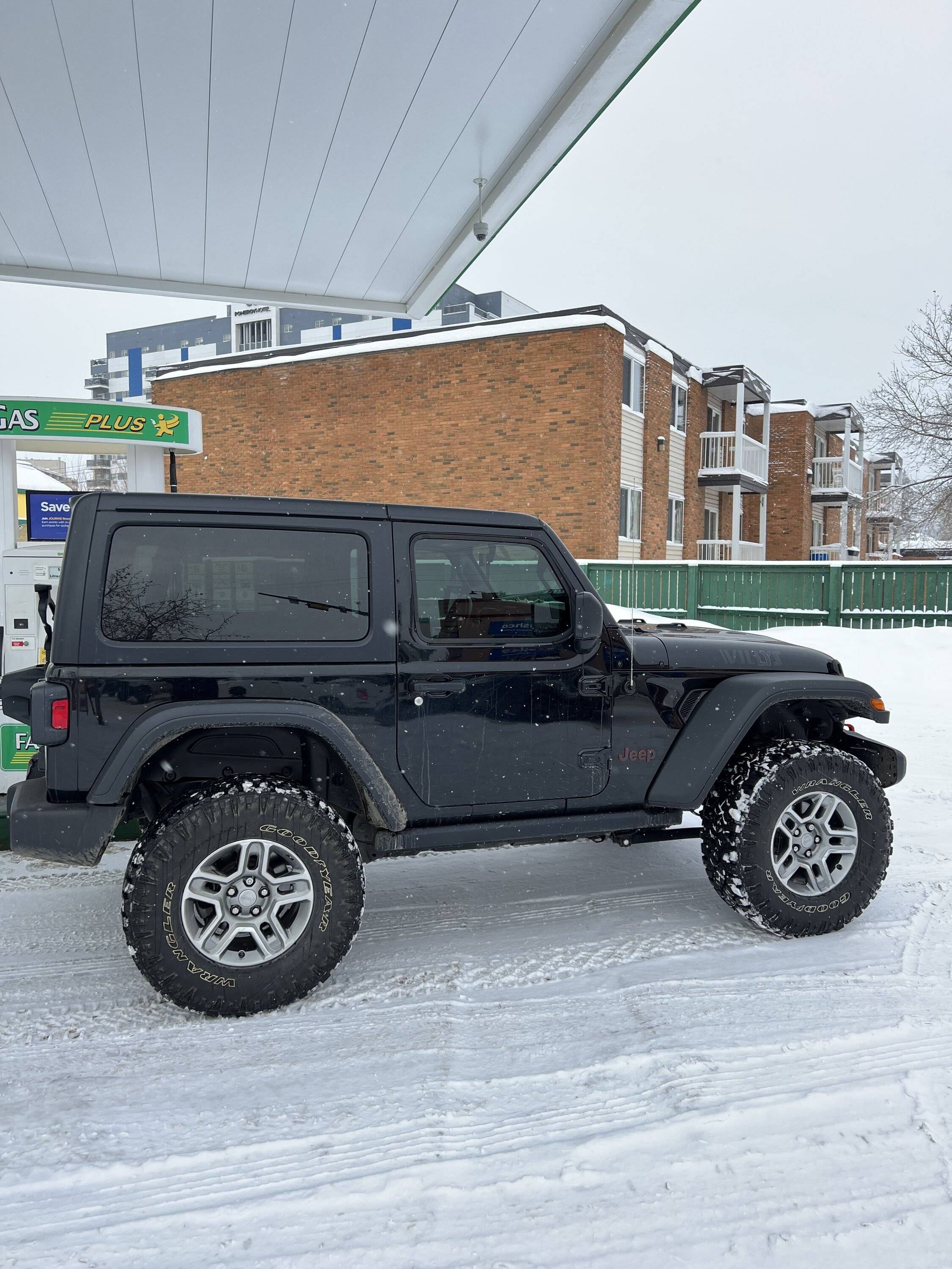

I have 35’s on a 2 inch lift. It’s the rough country spacer lift.
3.45 gears in sport and Willy’s are crap though, just a heads up
Jeep Wrangler JL Help please!!!! IMG_8435
