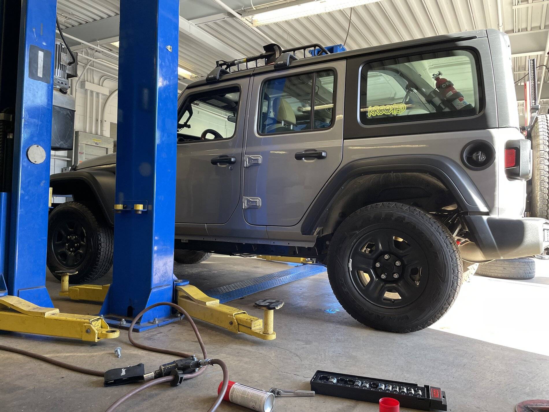

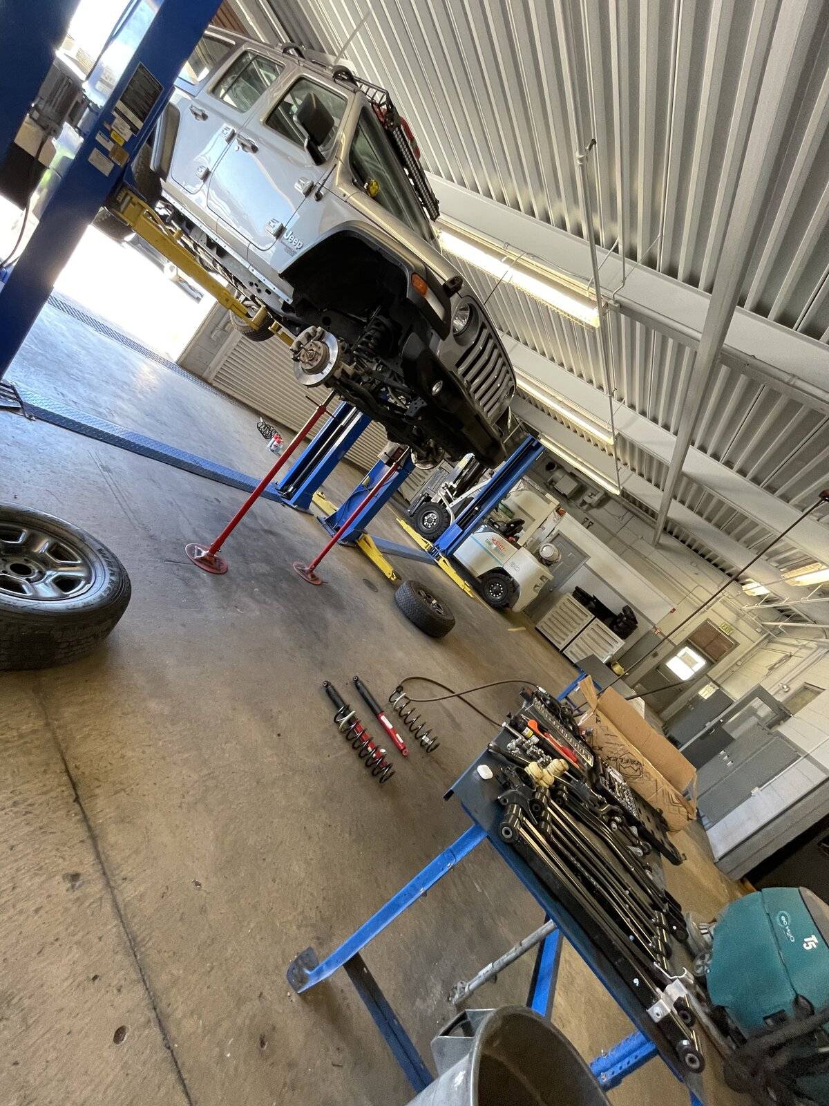

I essentially took the entire suspension system from a Rubicon Recon and put it on a Sport: lower control arm, coil spring, shock, brackets, track bar, steering stabilizer. The whole suspension system came out and the new went in its place. Its the same exact process as the 2” Mopar Lift, I actually followed the 2” Mopar lift install instructions because there technically isn’t official Rubicon and Sport suspension swap instructions.
I had access to a mechanic garage with a commercial 2 post vehicle lift and impact tools. I will say that it was still a pain in the ass and very time consuming even with professional equipment.
