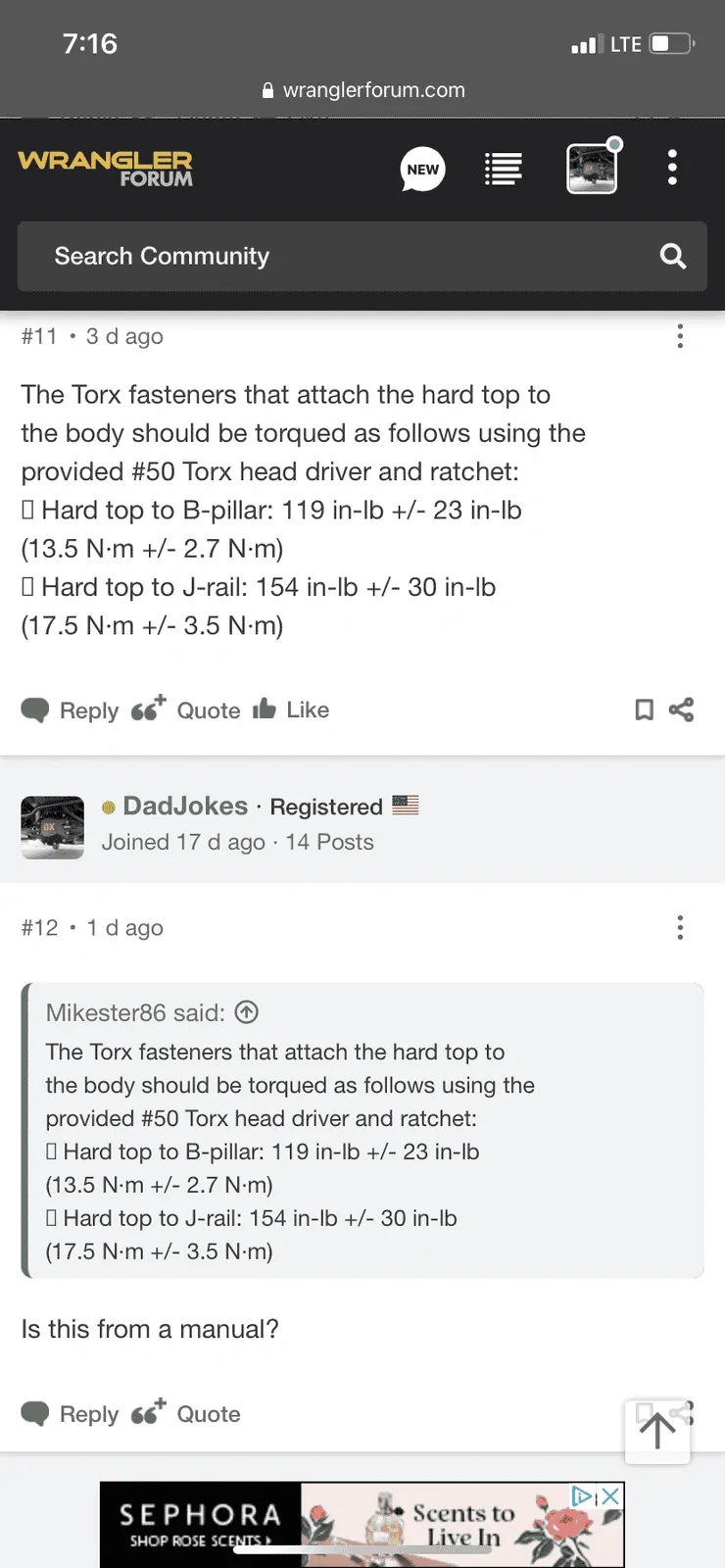

Ownerās manual? I went and looked at the hardtop removal section and all it said was the install was the reverse of the removal so I was back to thinking itās in the service manual instead. ShrugItās in the manual. I replied the the OPās other thread with this info:
The Torx fasteners that attach the hard top to the body should be torqued as follows using the provided #50 Torx head driver and ratchet:
Hard top to B-pillar: 119 in-lb +/- 23 in-lb(13.5 NĀ·m +/- 2.7 NĀ·m)
Hard top to J-rail: 154 in-lb +/- 30 in-lb(17.5 NĀ·m +/- 3.5 NĀ·m)

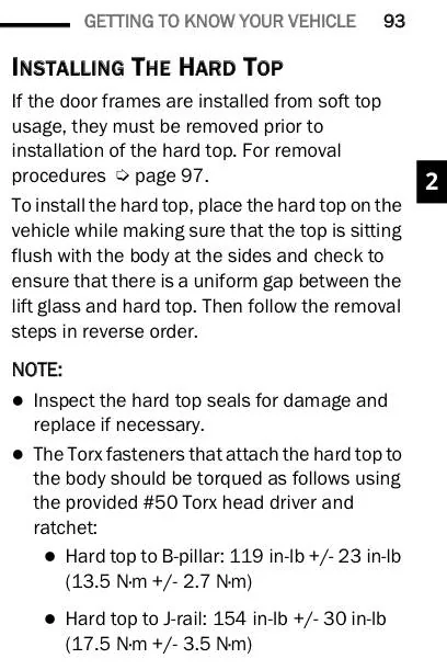

Sure does. We have a 19 and 21. I couldnāt find it in the pdf 19 copy. I looked in our paperback 21 manual and itās on 93 like you said. Right now, on the updated pdf copy downloadable from Mopar, it is on page 109.Yes. Page 93 of the 2021 Owner Manual.
