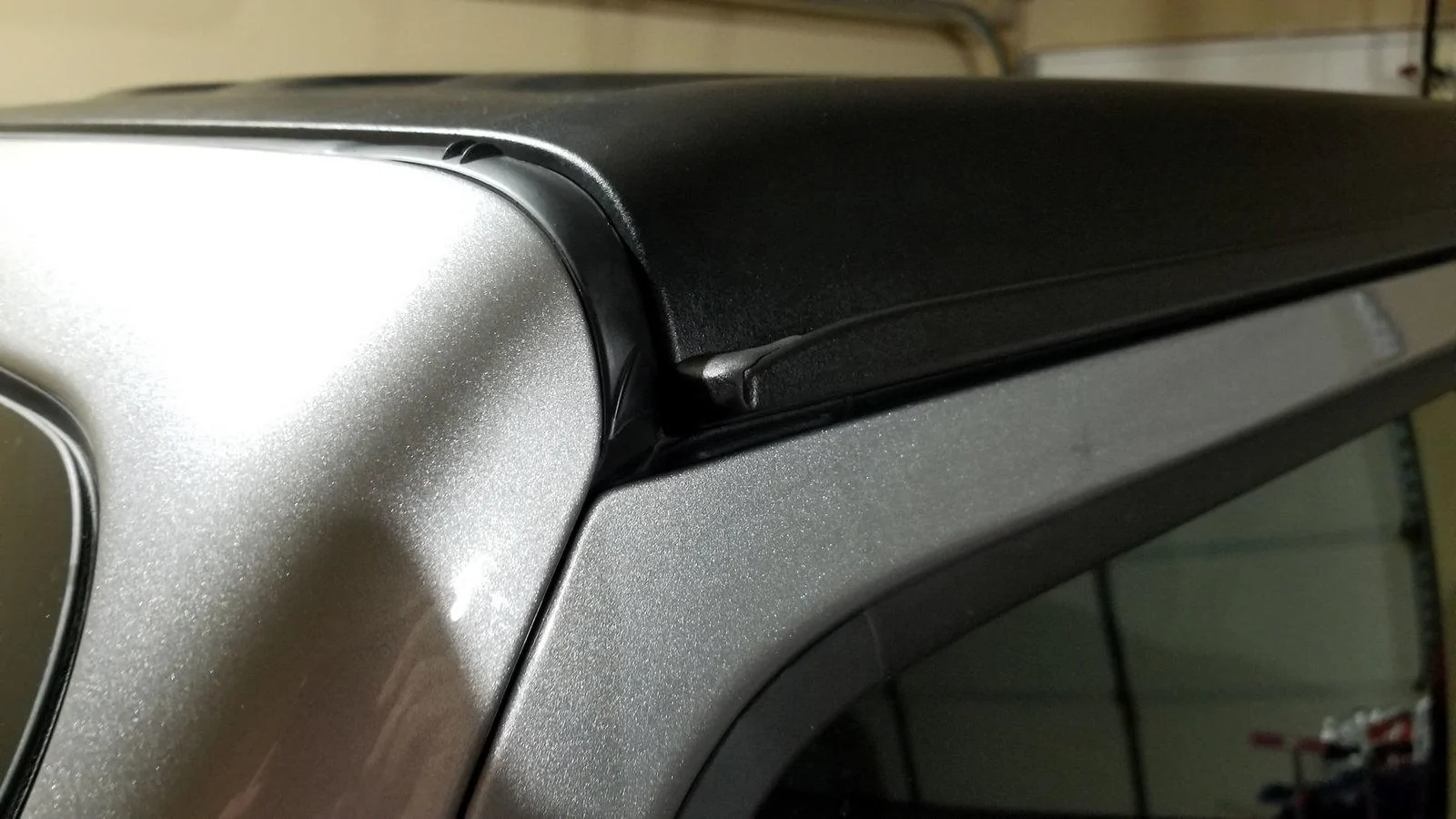

Yes it does that because the gutter ends at the windshield, and the Jeep has a little bit of a forward rake so it points down when on level ground
Exactly. Hopefully there is some solution somewhere that solves it.
Rain shields work well, until you open the door.

Yep, well discussed here. I blocked the end of the channel with black RTV sealant. Helps in light rain....not so much when pouring.

It’s a trade off. If you extended the gutters enough to clear, you’d have these weird projections on the top or freedom panels, waiting to be broken off, then the complaining would be about that.
I'm sure some good engineers could have figured this problem out. Recessed/flush drip rail design perhaps.
With this said, it is such an immediately apparent problem that I think Jeep knew about it and chose to ignore it rather than this being a failure in design.

It would be expensive as a solution, but the waterfall slowed to a slight drip when I installed my Sunrider for hardtop.
