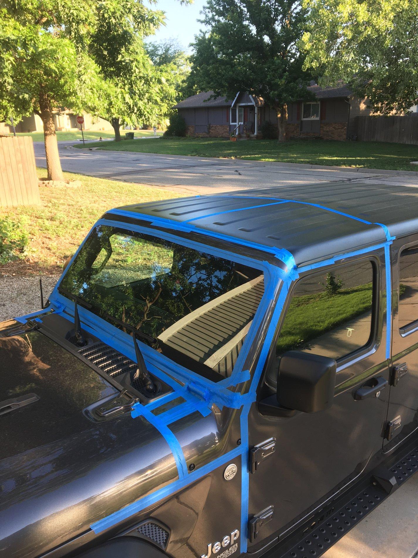

Here’s where I’m at today.
After getting the jeep back from service, I took the liberty of taping off every conceivable seam in and around the front windshield frame and front door seals, as well as the top freedom panels.
After crawling through the backseat, I drove it about 15 miles; I live in Kansas and it’s moderately breezy all the time, maybe 8-10mph. I got up to highway speeds, and at 65mph I was reading 69-71 for decibel levels.
I felt as if there was a reduction in the whooshing noise, but there was still noticeable wind noise from the front windshield.
I’m no mechanic, or aerodynamic engineer, and I know Jeeps are like driving a brick down the road, but I still felt as if the sound was slightly louder than it should have been.
My next plan is to begin untaping, until the full wind whooshing noise returns.

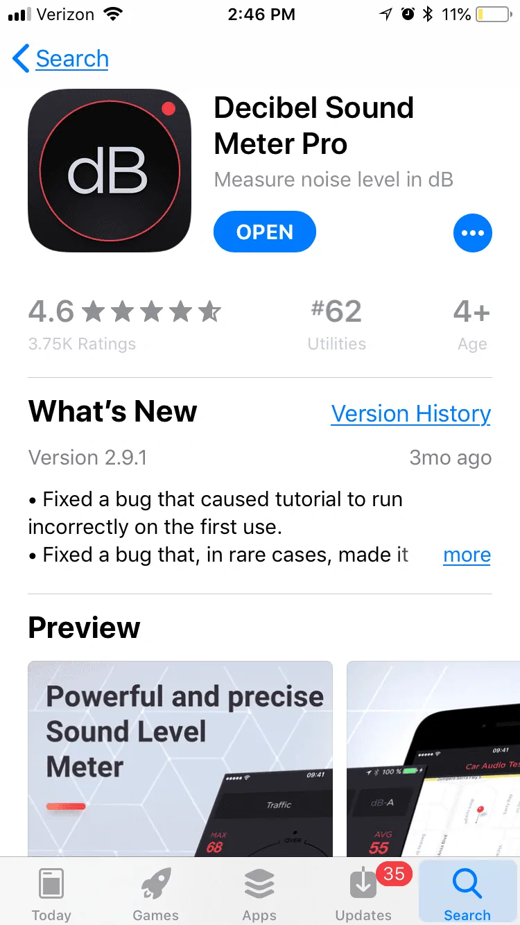

I used the DB meter on the App Store. I took a lot of cues from the JeepInformat YouTube channel. Here is his link where he compared the JK road noise to the JL.

Looks like you have everything taped off, maybe try removing the windshield wipers? Or taping off the vent between them?

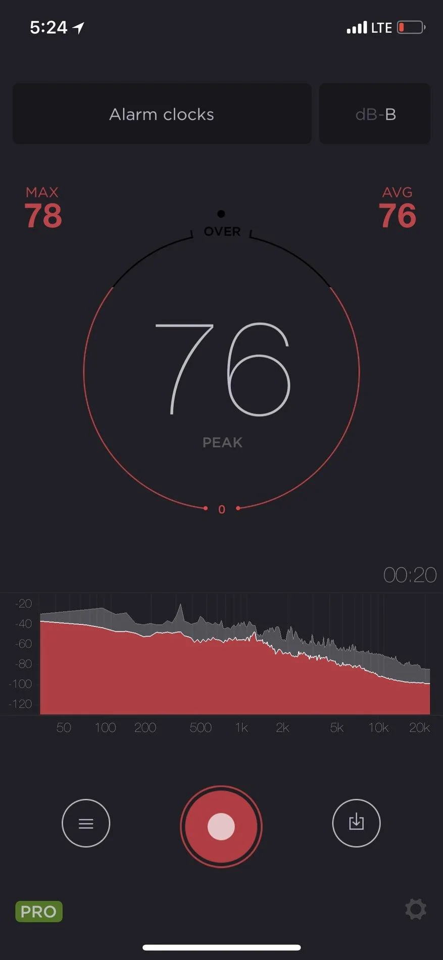

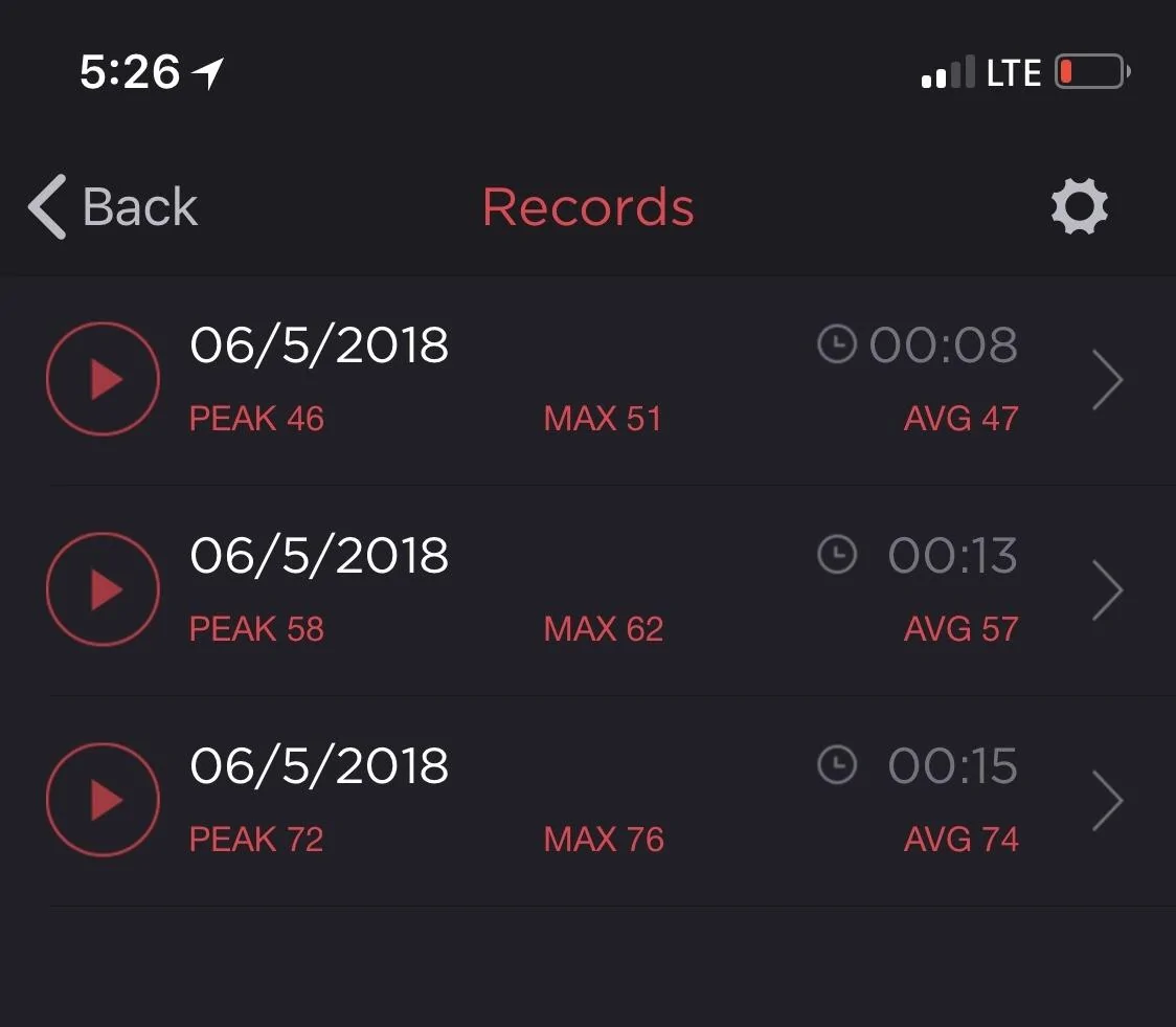

@Wfd1244 I do the app and did a few tests on my way home, coming out of DT Houston during rush hour is pretty loud with 5-6 lanes of traffic so going to do another highway check tomorrow morning when nobody is on the road
Anyway in order from top to bottom is 1. Everything off just sitting in vehicle, 2. Startup with nothing on except engine, 3. 45-50 mph on traffic heavy road and 4. Is 65 mph on medium traffic road.
This is by no means a professional test as I was just holding my phone in my right hand flat just over the shifter to try to get it close to where I here the wind noise and today I actually noticed it from both sides of the windshield so I am almost guessing it’s just in the design of the vehicle, I wonder if the windshield was fixed like a car or truck if it would be as loud, my first guess would be no.
My JLU Sahara is no Beamer or Lexus but I sure do like driving it and can’t explain why as it’s got so much less in extras compared tote other vehicles I have owned and this is my daily driver.

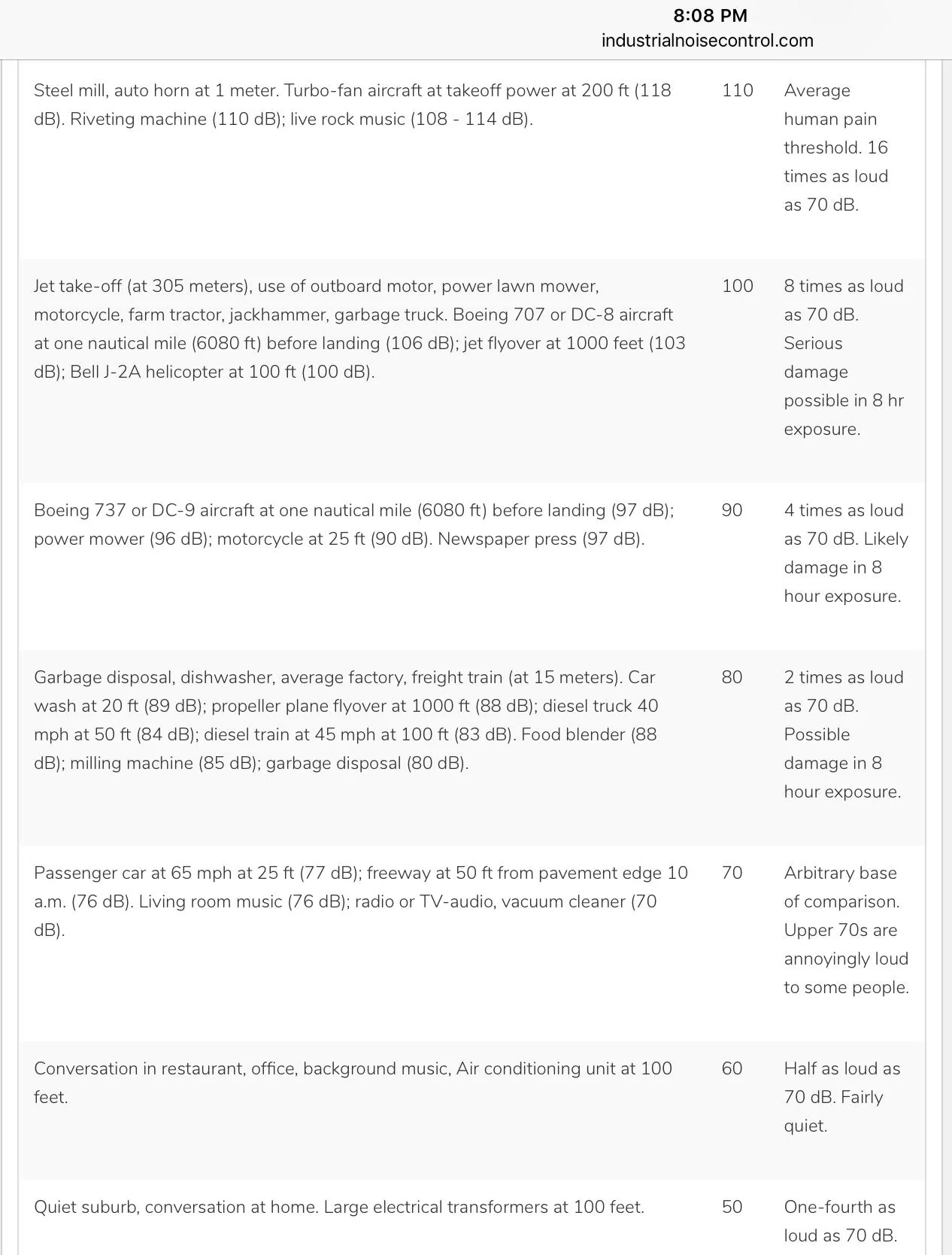

Also found this as a reference
