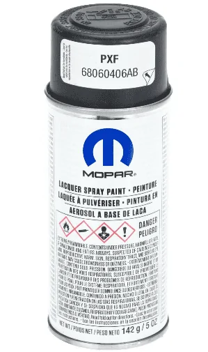

Chris, if memory serves me correctly there may be two different color blacks for the hard top. One for those who, unlike you I believe, have color matched black hard tops to match their black painted rigs, and those like me who have a regular non color matched (albeit painted) black hard top with my non black colored rig.
You want the latter less sheen color if your like me.

The one I linked is the same thing except it includes the clear coat. Mopar number is same but ends in AB instead of AA
