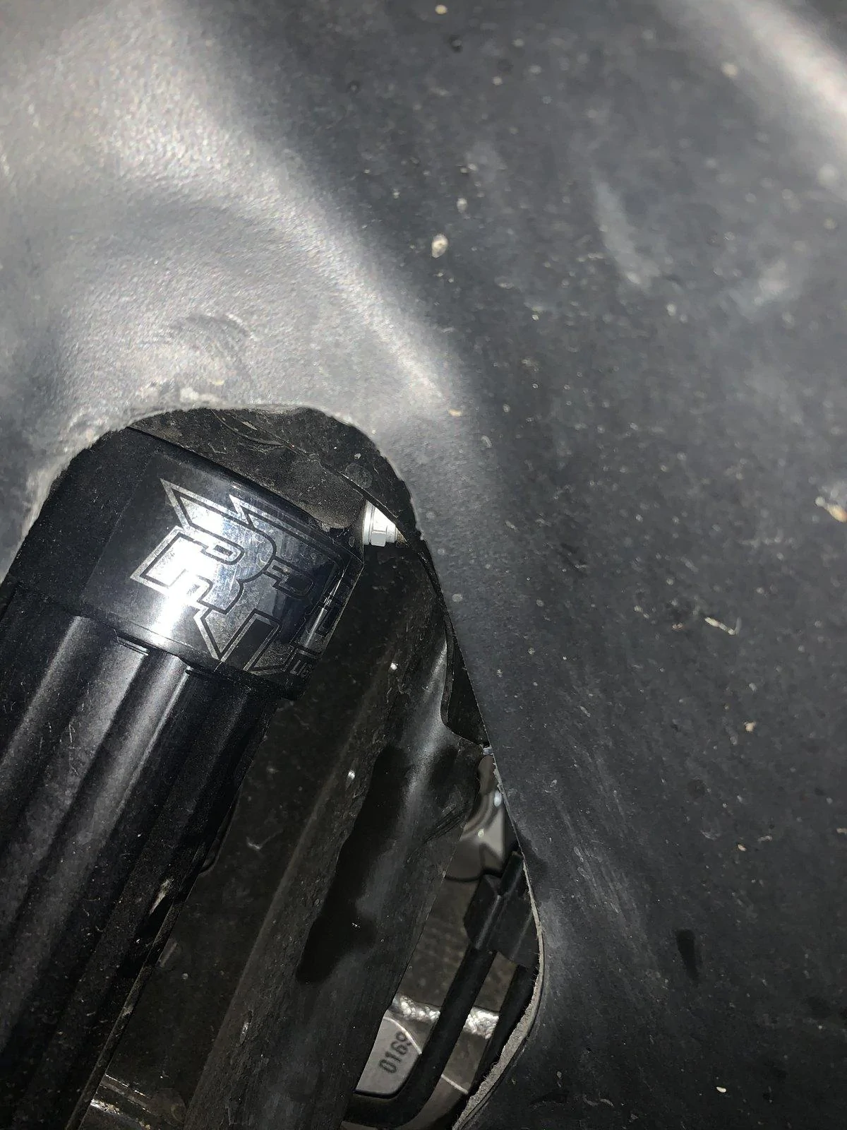

Thanks. I crawled around and found em all earlier including the track bar one. I appreciate the checklist on what all to hit. Here’s a pic of the top of the Shock.
limeade
Guy
Oct 29, 2018
1,244
2,310
Reno, NV
Those are Schrader valves for when they are serviced or rebuilt. Those are not lubrication zerks.
This...you dont grease the shocks. Make sure to use 000 grade grease. The front LCA's can be annoying to greass due to access.

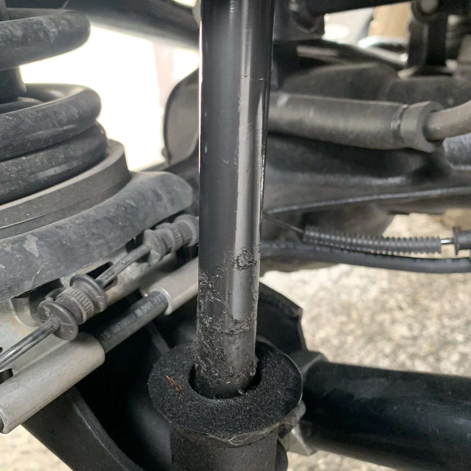

Dealership told me shocks are blown. My installer agreed but said that definitely isn’t what causes the clicking noise. RockKrawler said it’s normal for rebuildable shocks and are fine just dirty... I’ll torque the ball joints myself.
Roky
Roky
Oct 4, 2018
5,187
14,978
Central Florida
Dealership told me shocks are blown. My installer agreed but said that definitely isn’t what causes the clicking noise. RockKrawler said shocks are fine just dirty... I’ll torque the ball joints myself.
Shocks aren’t blown, that’s how they are, always wet.
