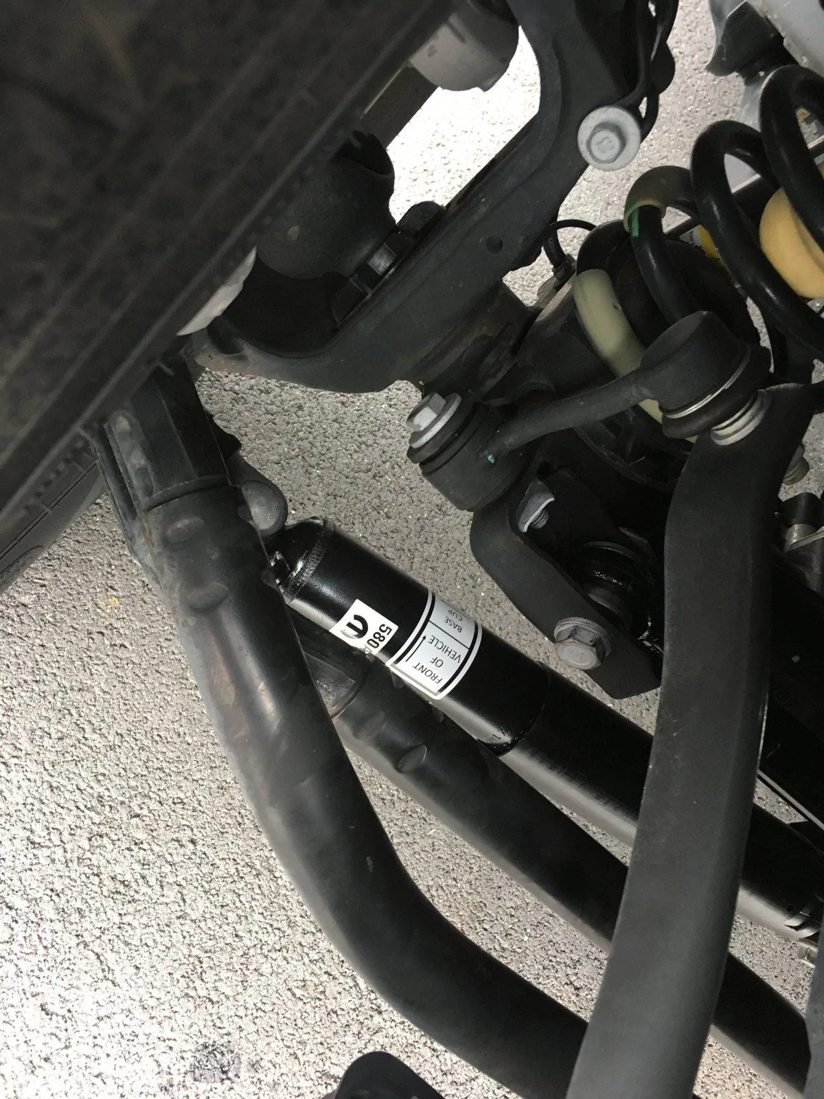

(upside down)
sXE1NJ4u_FXFcVxiP5ciiyS00F5Wc2qUvNnoTvgRVI72V0JfyM5U3A69GR7sDOIvmtwOZP9Y6tDT0YK-Fi=w1139-h854-no.jpg
Had mine done yesterday and my photo looks like yours (incorrect install).
I have an appointment tomorrow to have it corrected while I wait.
I'm going to insist they put in a 'new' one as I'm being told that driving it that way will damage it.

Got my recall done today andddddd.....installed with the arrow facing backwards and the green dot pointing up. Told my advisor who drove with me back to the service bay and asked the tech who installed it if it was wrong. The tech literally grabbed my old stabilizer and said "Look, it's just like your old one" and stormed off. My advisor looked dumbfounded, chased the tech down and I guess talked to him a bit....then the tech comes back and tells me the stabilizer is just a piston and blah blah blah doesn't matter which way it's installed. I replied, so why is there an arrow on it with a green dot to orient it correctly? No idea he replied. I mentioned where I saw the FCA supplied instructions to orient it with the arrow facing the front and he said ok, I'll install it anyway you want. 5 minutes later I was on my way home with the stabilizer oriented correctly. What a mess and I've lost whatever confidence I had in my dealership service dept which had done great for the last year. I'm guessing these Techs just slap shit on the Jeep without instructions and call it a day now.

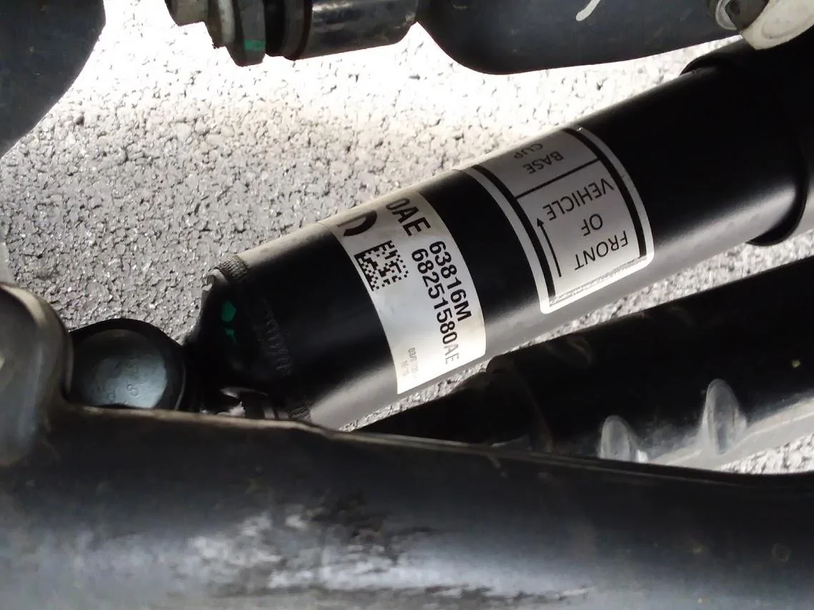

I took mine in. Don't see any new part at all. The sticker on mine says "580AB" and seems like it's dirty and has spray from the undercoat I did when new (2018 March). The ticket has some gibberish on it, no part number or anything..... nothing really said when I checked out today as I had oil change and other issues taken care of

forget the label and use the green dot, bulge orientation.
Can you elaborate on where the green dot should be? I just had mine done but was in a hurry so couldn't check until I got home, and of course the arrow is pointing forward.
Good question, in a perfect world if the arrow on label is pointing forward it is good to go. But we do not live in that perfect world, there are posts saying some have stickers that are backwards. So look at the dot and bulge, they should be at the bottom toward the ground.

so i had mine done today and at first it felt tighter. On my way home i hit a RR track thats at a slight angle to the road and the front it felt to wobble a little. I never felt it before. should i have them put the old one back? or go with Rancho or Fox?
Mine did this when before it hadn’t. Mine and many others have been installed backwards. Look back a few post for photos of properly/correctly installed pics.
