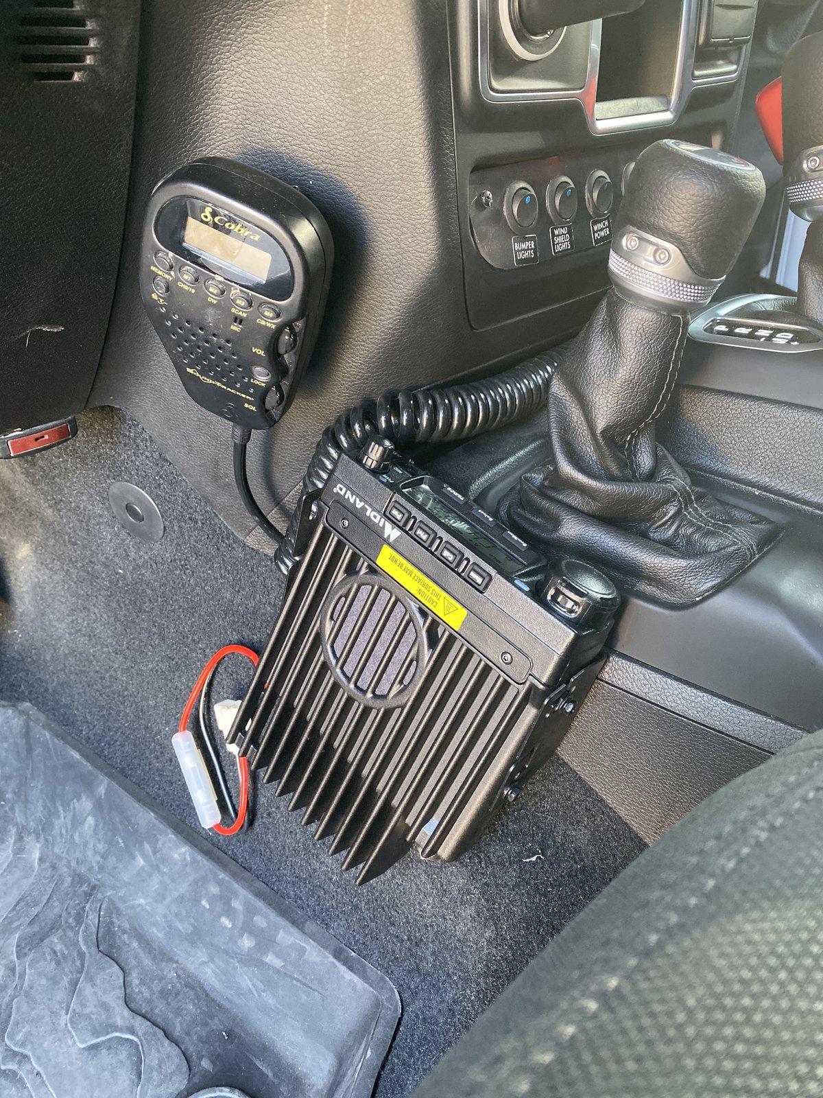

Here's my set up. I mounted the base on the panel below the steering wheel, with the speaker firing outward. I'm still on the 12v plug, but will wire it directly soon. I will swap back and forth between CB and GMRS, depending on which is of primary use with a particular group. I like the loud clear volume of the Midland. It is much louder than the Uniden. Now I just have to get to work on that antenna mount.

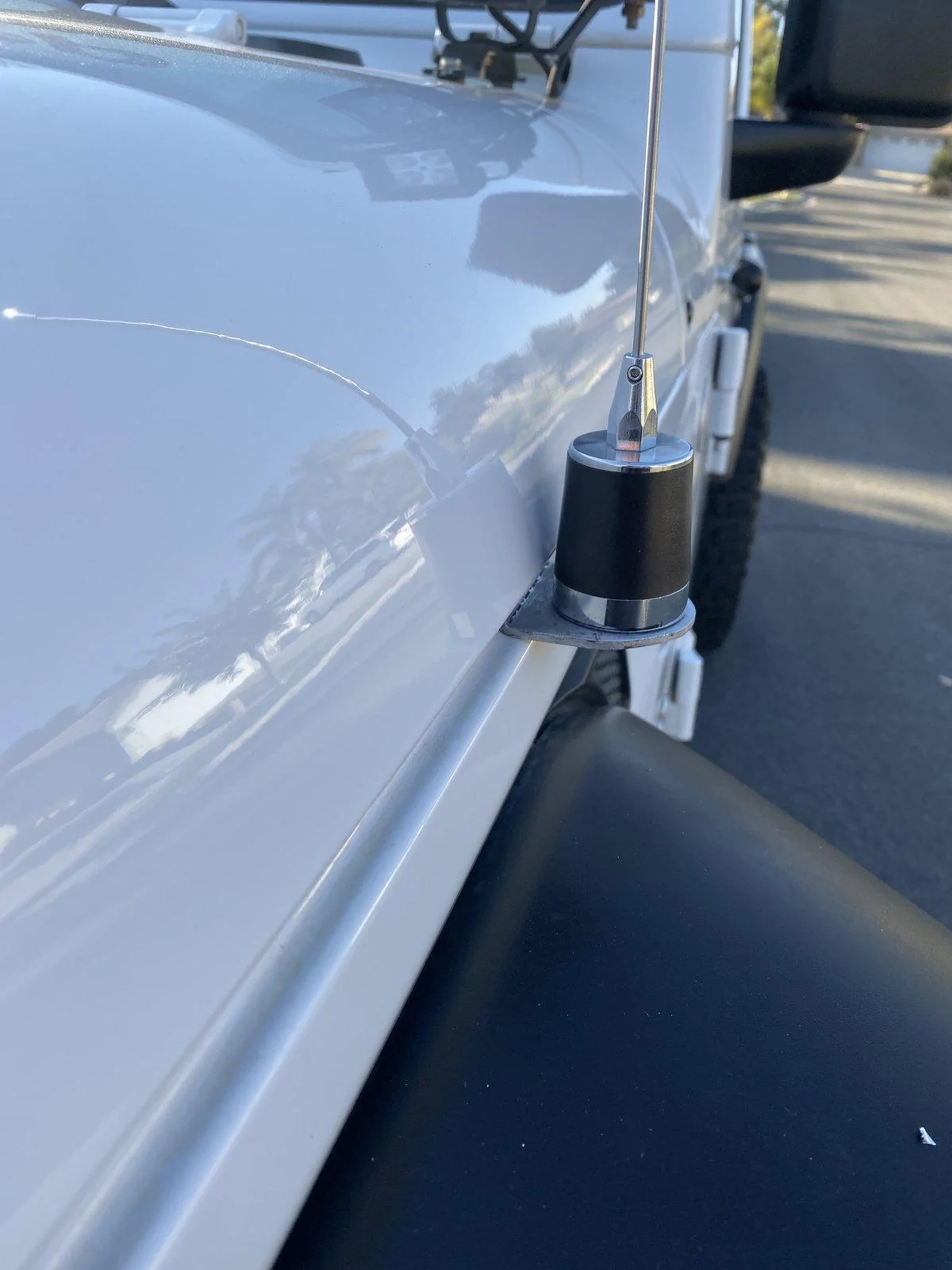

I made my own. It's a bit rusty because this is an untreated prototype and has been in use for last 3 months. Works pretty well!
