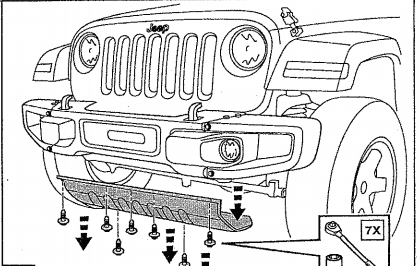

1. - Remove your factory plastic air dam

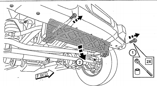

2. - Remove the metal skid plate behind it

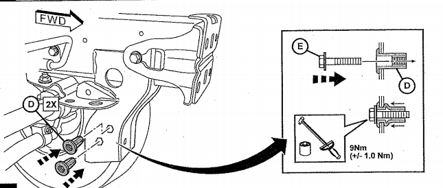

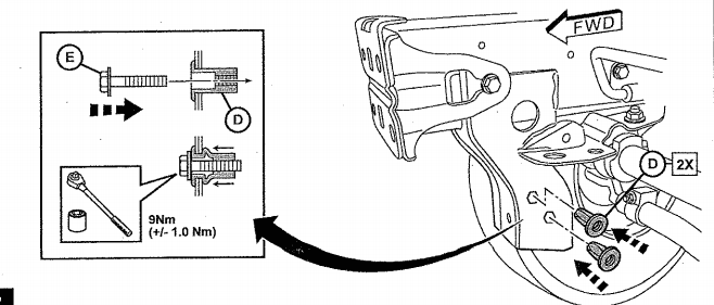

3. - Install 4 nutserts into each frame horn (8 total)
