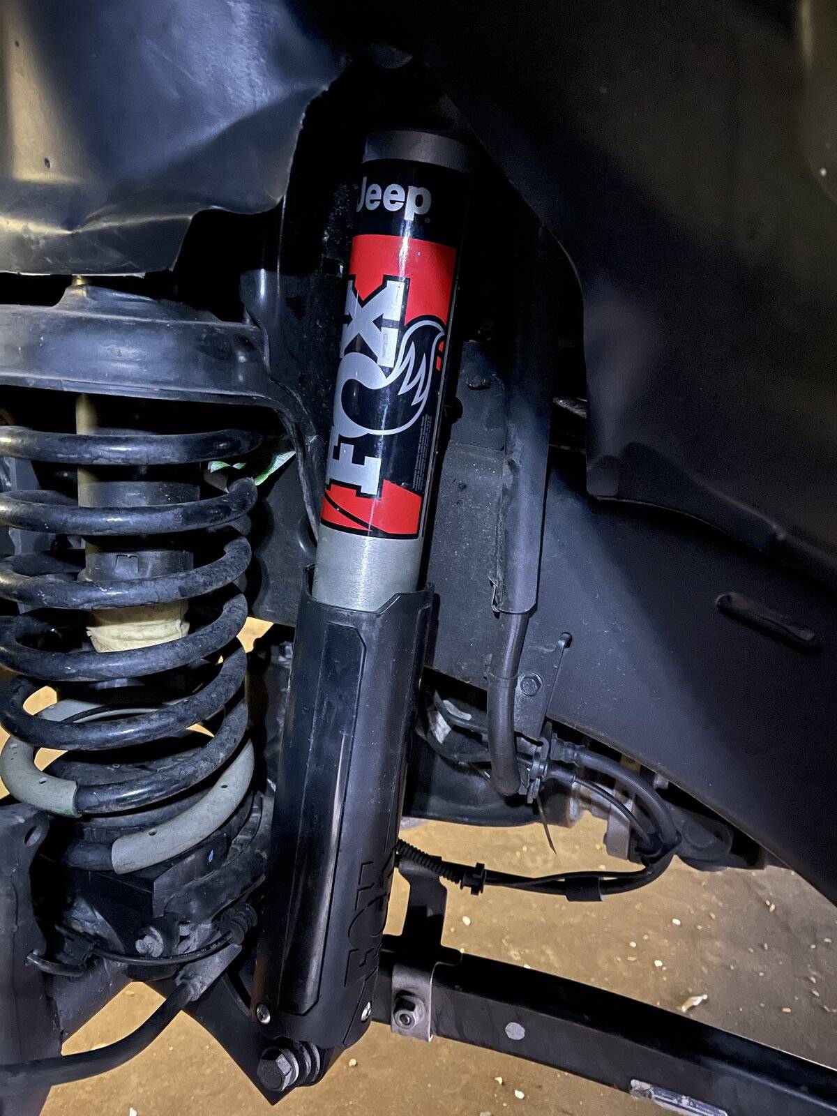

Installed gladiator rubicon shocks on my sport with rubicon springs. I had red rubicon shocks for about 20k miles and one front and one rear started leaking. So far really like new shocks, ride is way softer, but not bouncy. Not much brake dive.
I reused upper bushings from red shocks. To make things easier and not to destroy the lip on the bushing I partially pushed the bushing from the red shock with gear puller so the lip is inside the shock opening, than put red shock on top of the gladiator shock and pushed the bushing to the gladiator shock using red shock as a guide using bigger gear puller.

JL bolts for now. With all the negative reviews I was not sure I'll like JT shocks, but will change to 14mm lower bolts. Actually I dont have any clicking or any other negative effects with JL bolts.

But you didn’t change out the rear bottom bushing? So you have a 13 bolt in a 14 hole? Don’t know if that’s safe or not lol

I think its safe for now, I'll change the bolts soon. Even holes in stock bushing have some play with stock bolts, I have slightly more potential play for now, and with the bolts properly torqued down there should not be any play at all unless you are jumping your Jeep.

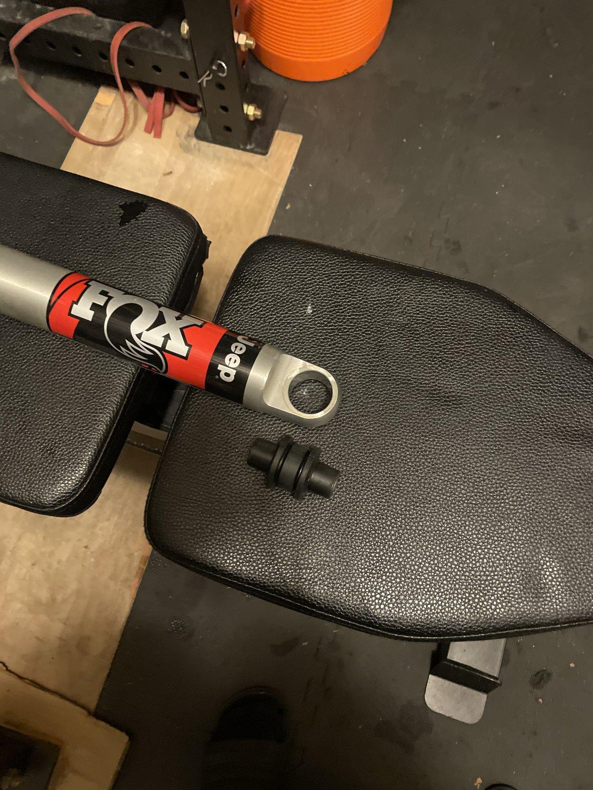

Why not just press out the bottom bearings too to transfer them to the fox shocks? Or do they not fit
Somebody in this thread or other mentioned, that the JL bottom bushing is a very loose fit for the JT shock, so I assumed they don't fit properly.
Correct.
I ordered 2 new bushings from the part # posted on this thread. Inserted them into the bottom of the JT Fox shocks. They're not "press fit"...you can just push them in with your hand.
I've since then installed them, torqued to spec with no issues.

Correct.
Did you order all new bushings? Or just the bottom?
