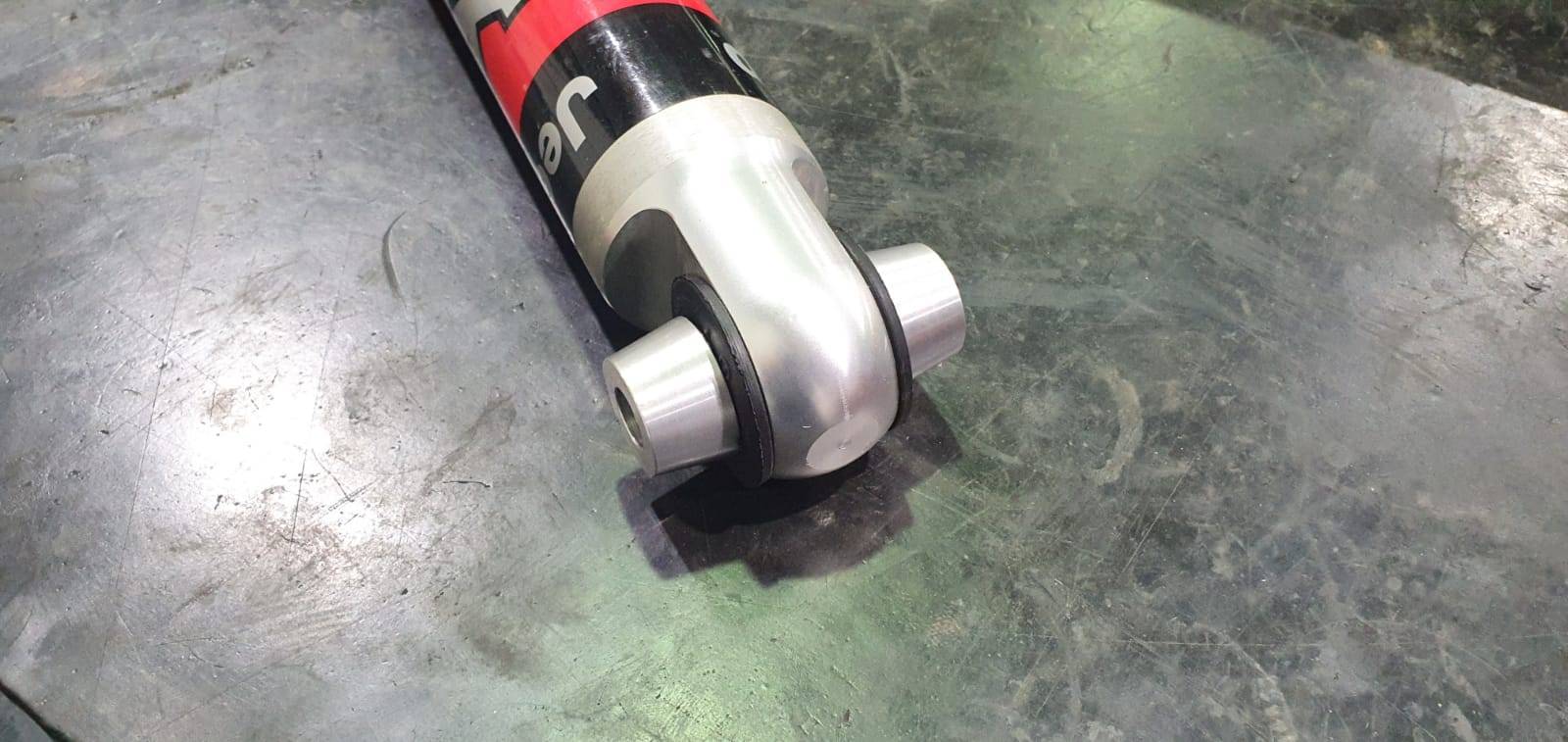

I'm thinking if we can order the JL Rubicon(or sport/Sahara) bottom bushings and install them on the JT Gladiator rear fox shocks.
Those bushing are the same as the ones we ordered, ie too small. I just put the original ones back in and got m14 bolts. Only had to ream out the lower bolt a very small amount and done for good.

I drilled the lower mount holes on the axle for the larger bolts, you could use a file to open them up as they are barely too small.

Sorry just reading into this, but what about a spacers for the top of the rear shocks? Is that needed? Or just swap in the new rubber and bolt on?
Easiest way to make rear JT Rubicon shocks work on JL is to order and install the JT Rubicon front bushings in them.
Top PN 68274895AA
Bottom PN 68274045AA
Just FYI, that bottom bushing is not the right one. Easiest way to do the swap is change the upper bushing and drill out the bottom hole for a 14 mm bolt.

Drill out what exactly? The hole on the axle it goes into? I’d rather not. If I ever lift my Jeep which I plan on doing next year, I’ll be shit out of luck with a 14mm hole and the shocks needed to upgrade have a 13mm

Yes, drill out the lower shock mount hole. It doesn’t take very much to make a 14 mm bolt fit. Or you could just use the 13 mm bolt in the lower mount if you don’t want to drill it out. I looked and could not find a bushing with a 13 mm bolt hole that was a press fit in the shock.

Hmm I wonder if pushing the one that doesn’t press in is a big deal.. ? I came across free shocks so I’m going to throw the fronts on today.
It’s not a tight fit and I’m sure it will get looser over time.
