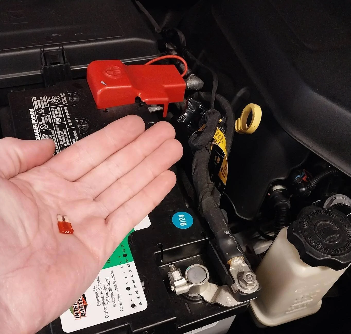

Could someone verify for me the negative cable for the small battery? I would guess based upon size that it's the one closer to the inside of the compartment. The cables are now wrapped together in a sheath, so I'm unable to follow them with any degree of confidence. Thanks

It is indeed the thinner cable.
This is what things looked like after I removed the ESS negative cable. I'm holding the related 10A Fuse F42 as part of isolating that particular battery.
Note that you'll want to ensure that the remaining, thicker Negative cable for the primary 12V battery is securely seated on the Intelligent Battery Sensor.
