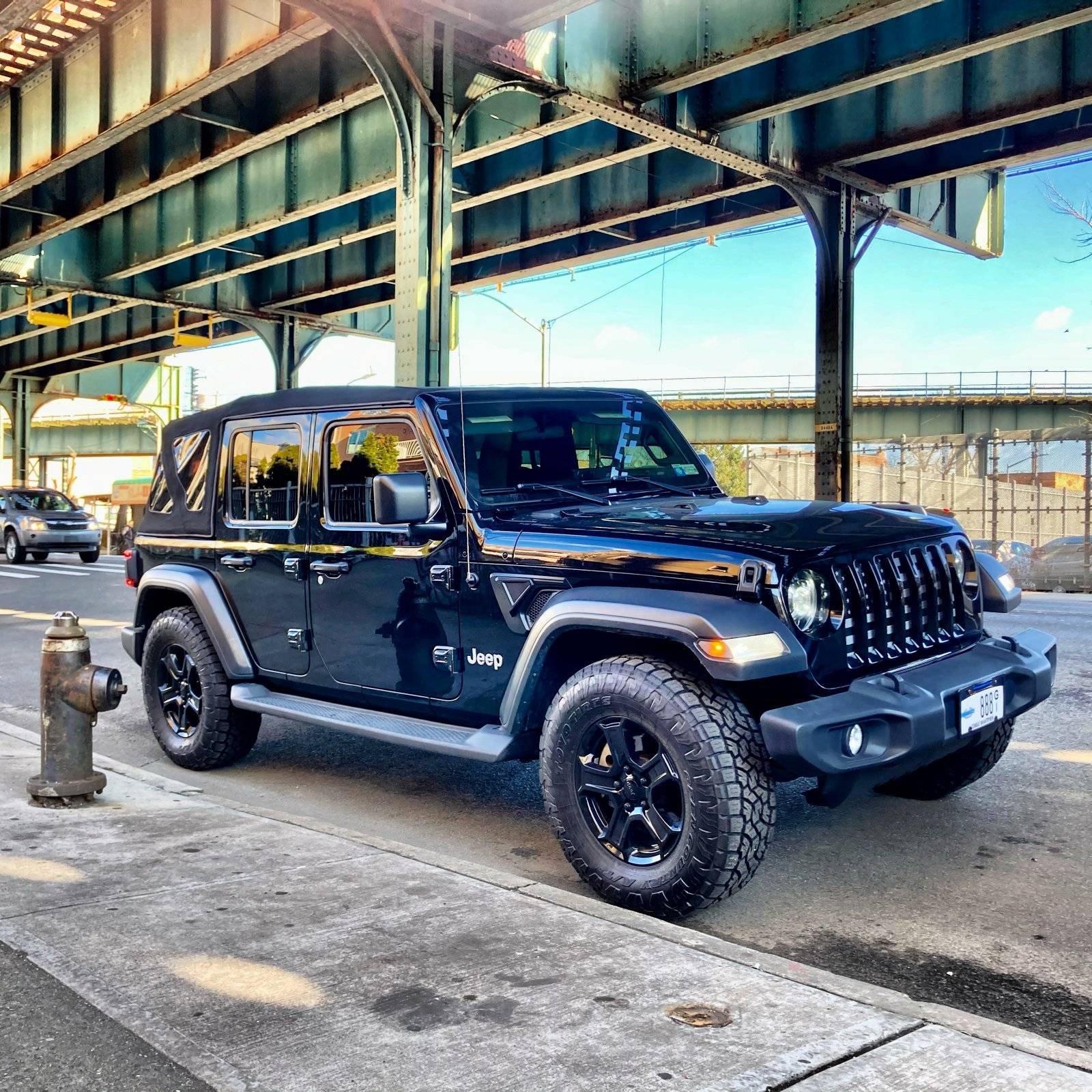

I have a JLU Sport as well and this is the largest size you can have on before anything rubs https://amzn.to/3ppjA8o (285/75r17)
I have those exact tires on mine. So far it’s been great in dryrain and heavy snow.

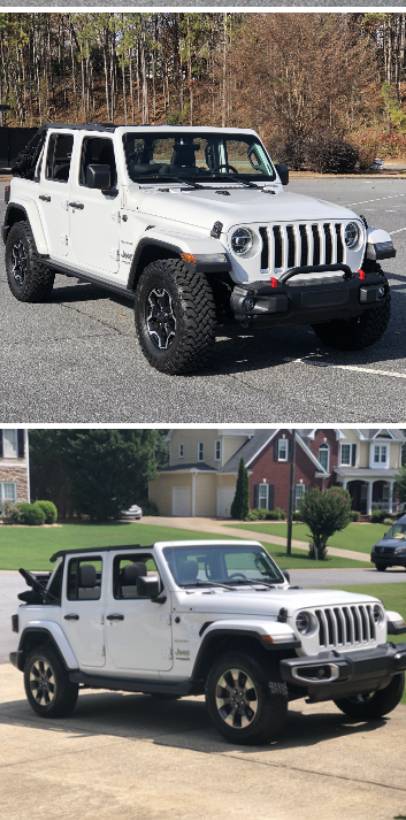

This is great advice for anyone wanting to change the look and performance of their Sport or Sahara on the cheap, while sticking with OEM parts. Deals are out there, but you have to be ready to jump on them when they pop up. One man’s junk is another man’s treasure!
