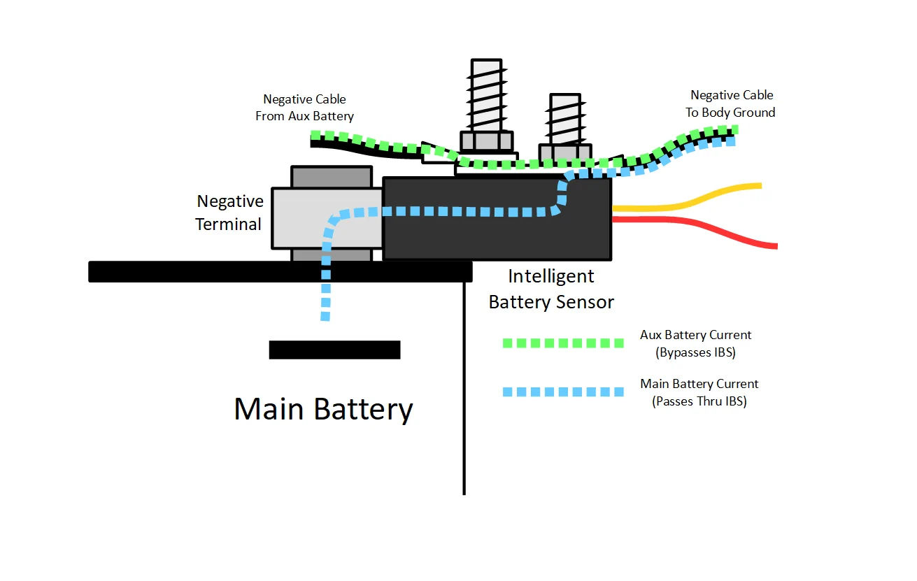

Posted about this here https://www.jlwranglerforums.com/fo...road-dual-battery-kit.5422/page-9#post-879046 , it looks like the battery sensor is connected to the wrong battery. It should be monitoring the main/charging battery, not the accessory battery. Try moving it to the other battery to see if that helps.
Hmmm, the sensor is connected to the negative terminal of the accessory battery. But there is a solid cable running from the accessory negative to the starter battery negative. So moving it will not have any affect at all. All the negatives are hard wired together.
Not true, the sensor is measuring the current into and out of the battery it's attached to, it does not measure the current into and out of any other battery. Here's a diagram I made for my IBS thread.
