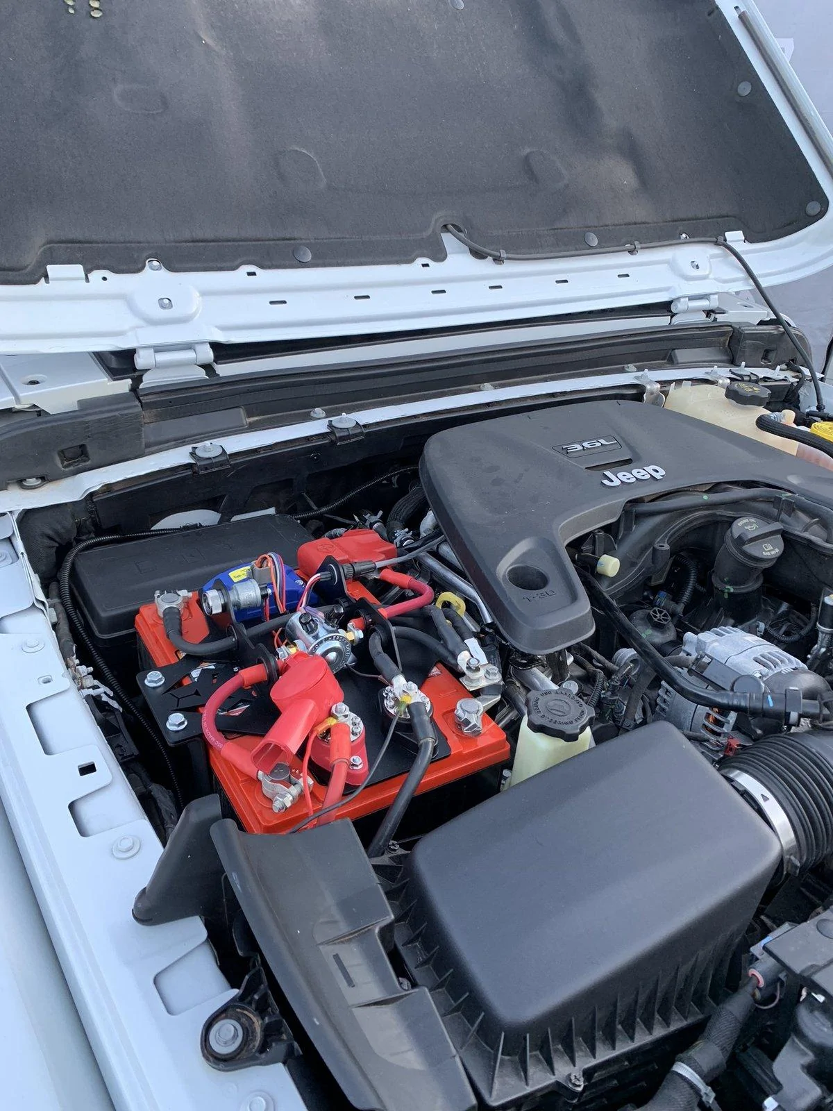

What is momentary mode and will the small battery be enough to start the Jeep in very cold weather?I am working on a DIY solution now like that. I managed to bypass the second battery thus far and have all operations run off the main battery, then I Tazered the ESS. My next step is to use one of the Aux switches in momentary mode to trigger a solenoid to reconnect it to the main battery if it needs a boost to start.. Then just add a conventional battery isolator to keep the aux battery charged.
