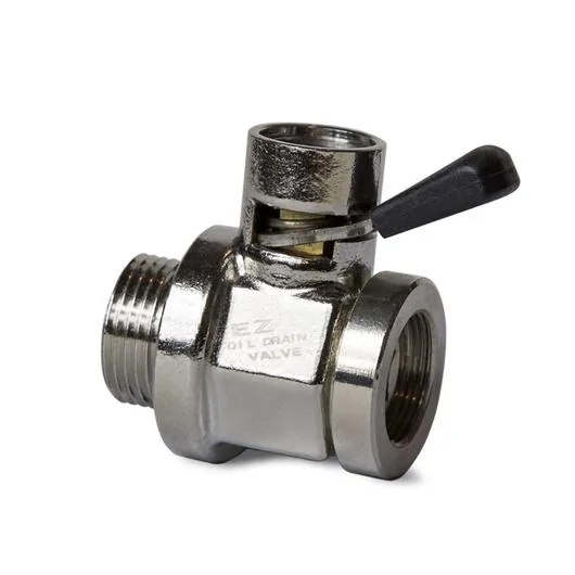

I think the OEM plug is tapered pipe thread.
Yes, you are correct. The OEM plug is a tapered plug. That is how it "bottoms" and seals with teflon tape or dope. The transfer case is threaded as a M22-1.5 all the way through.
There are a couple of ways that a drain plug will seal. One is the tapered plug design and another is a flat face with a washer or in this case an o-ring. I have installed the EZ drain that I referenced and it threaded properly then the face bottomed to seal properly.
It fits perfectly and doesn't leak. I have these on almost every vehicle I own plus generators for oil drains. They all seal identically with the flat face and o-ring. None of them leak plus they make oil changes a lot easier.
I will admit that this is a bit of an overkill, but it is a pain how much of a mess it makes without dropping the protective shield.
