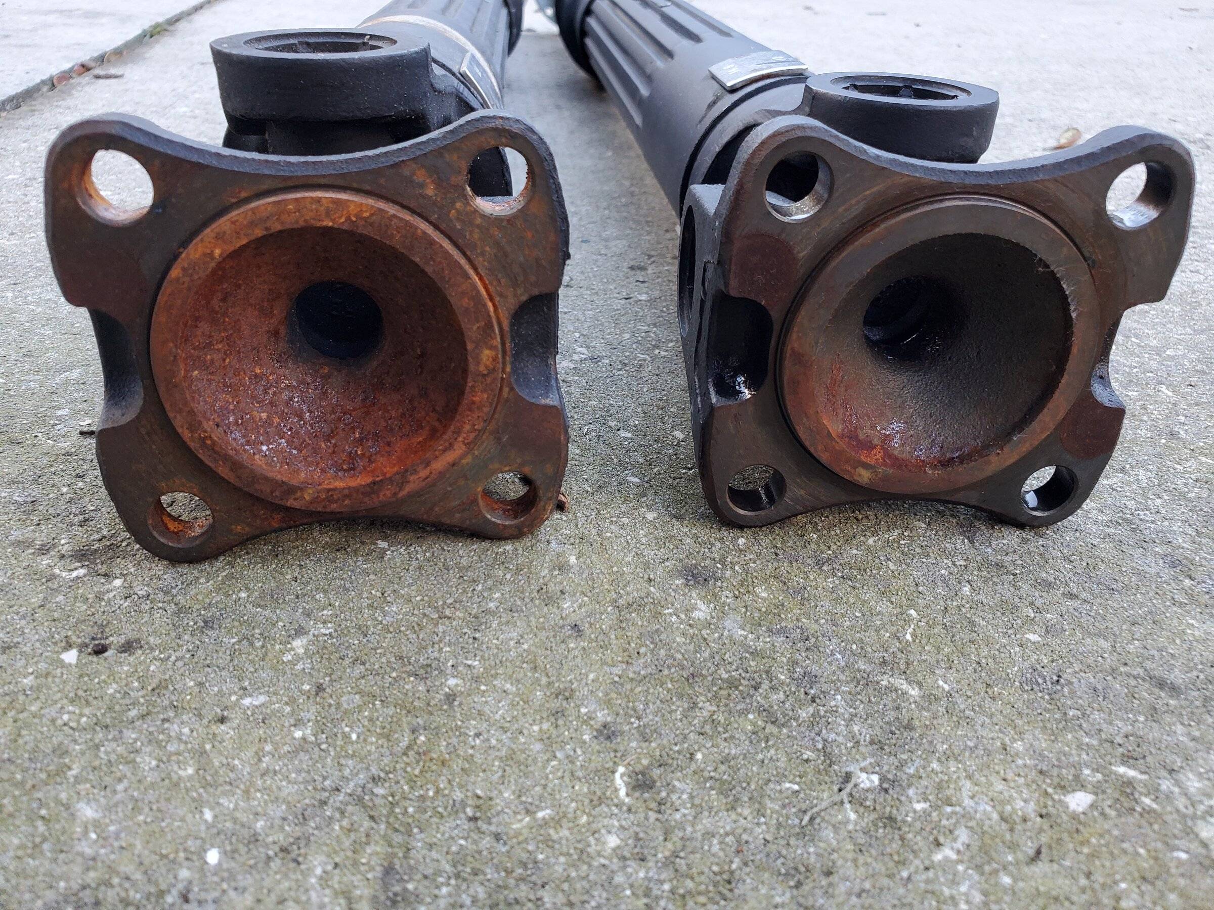

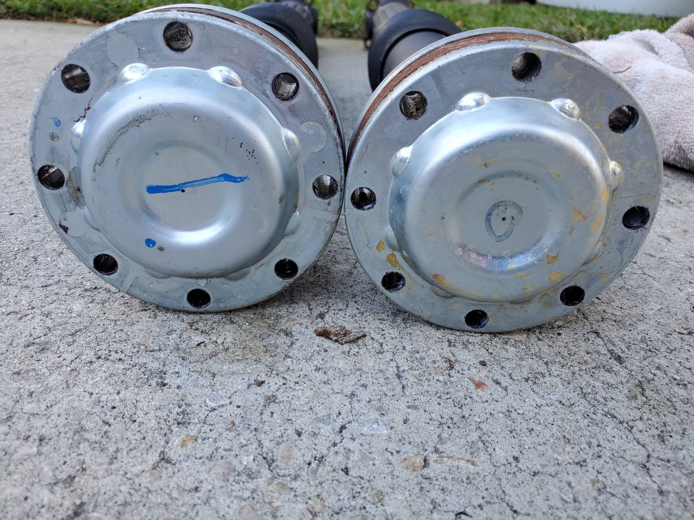

I figured I'd provide an update here. I ended up finding a good front Driveshaft off a Rubicon (part # 68272525). It is exactly the same as the original Sahara front drive shaft (part # 68272524). Here are a few pictures and it in stalled very easily.
It seems that the Rubicon shafts are much more available as those with Rubicons are more likely to need to upgrade the driveshafts. So if you have a Sahara or Sport and need a new one they are interchangeable.
