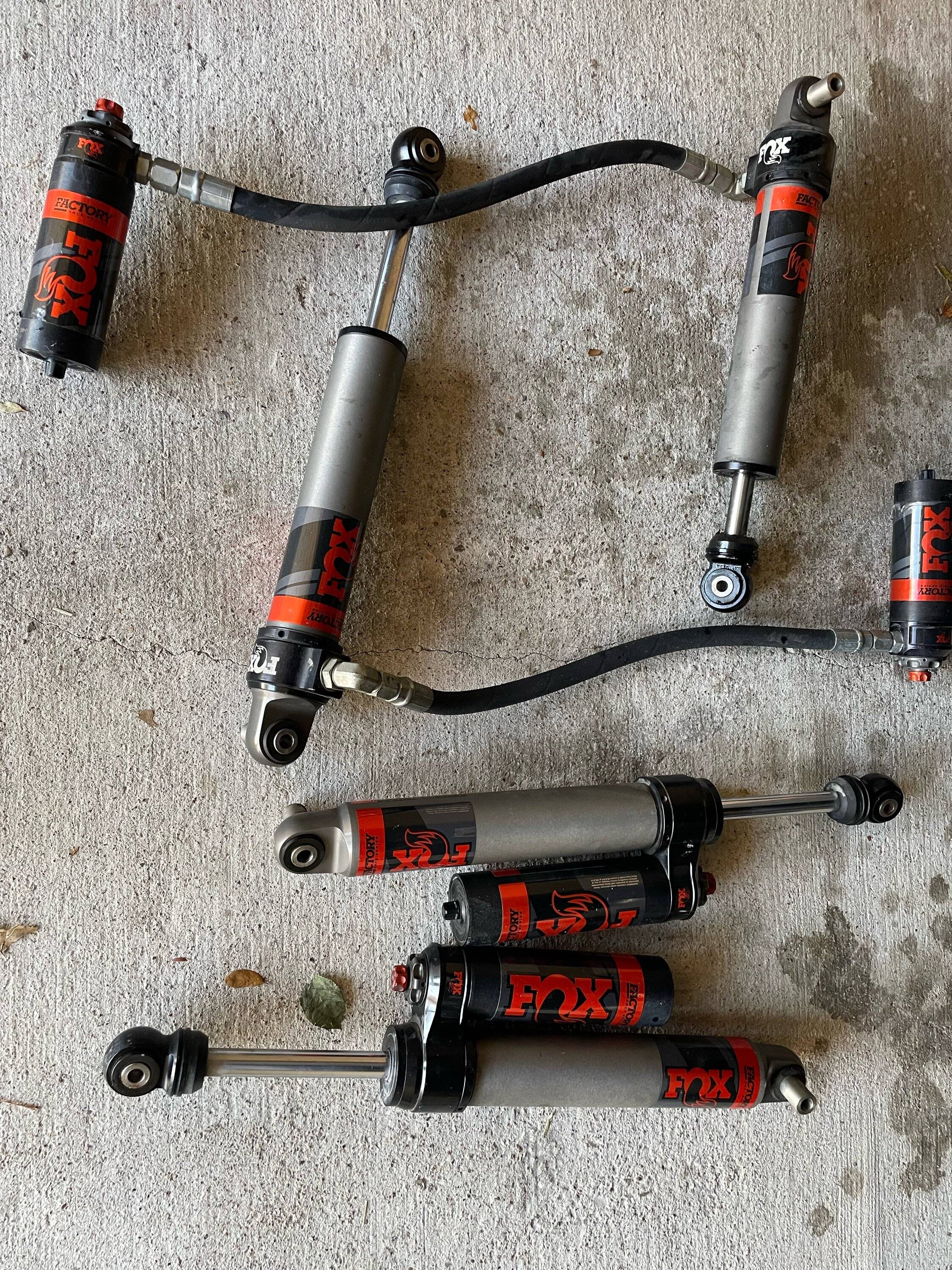

Background: I purchased a lightly used JLU Rubicon with 22k miles. At some point, I had Fox suspension installed, but I'm not sure when exactly since it was a dealer purchase. During the second month of ownership, I realized the passenger front shock was leaking from the bottom. I ended up seeking out the best shop to service locally in Texas but was not able to secure any good options. I settled on AccuTune since I was able to get them rebuilt and "custom tuned" for the vehicle.
Removal: I released all the nitrogen in the shocks, and they came off relatively easily. packaged them up aggressively and sent them off.

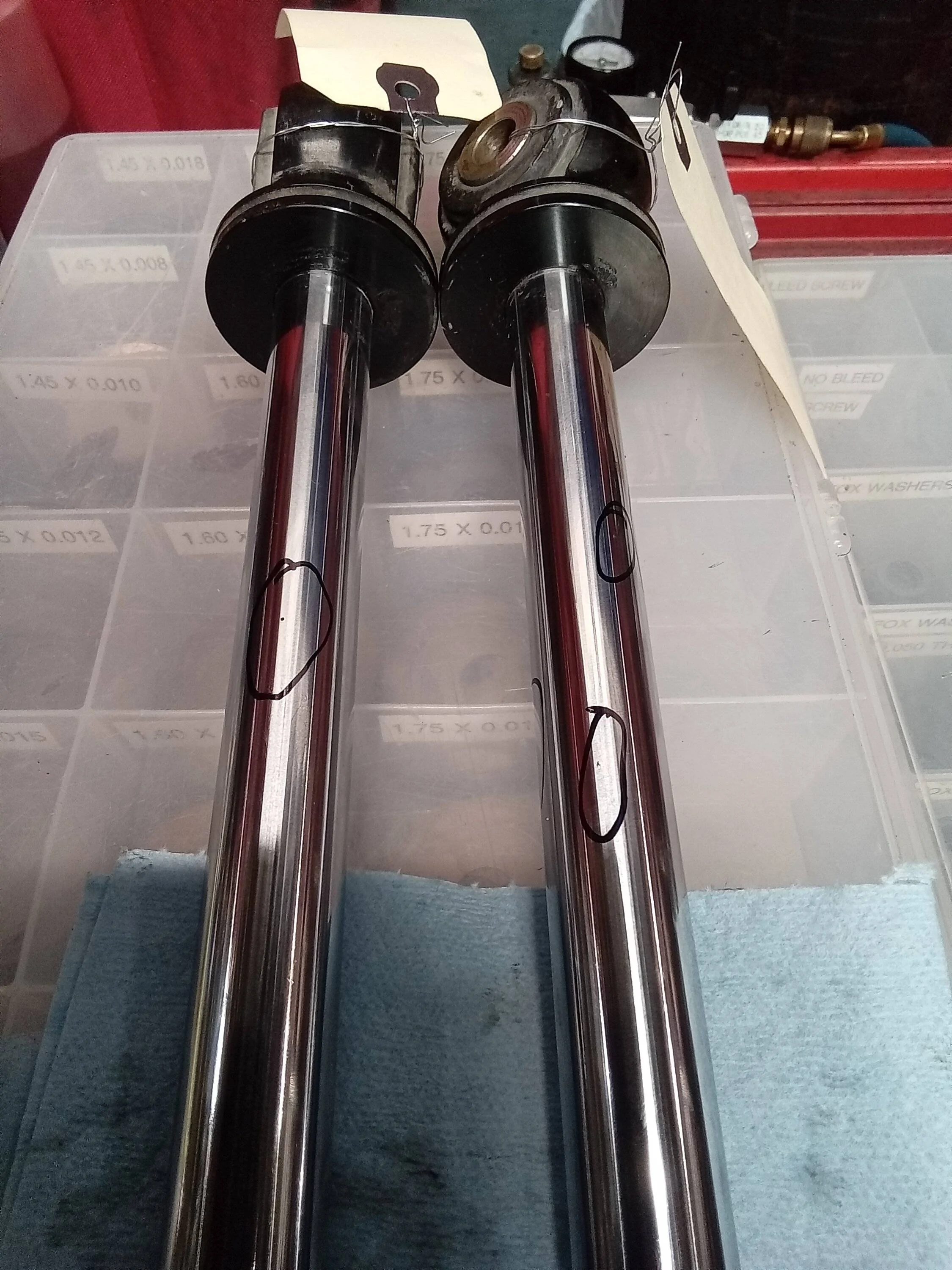

04/06/23 Inspection Process: AccuTune reviews and assesses 3ā4 business days.
Pitting on all 4 shafts confirmed. "Whenever we see any kind of damage on shafts, we recommend replacing them. As the shock compresses, those spots will start to damage the wiper seal, which will cause the shocks to leak. The cost of the new shafts and the labor to replace them is $306. I have the rear shafts in stock, but we would need to order the front shafts, which could take about 2-4 weeks."

Take pictures of them installed, so you know which way to put them in. Mark them to know which is left vs right. Seems simple but you will second guess.
Expect problems, have anti seize ready, and take your time with the reinstall.
Front shocks are side specific and cannot be installed on the wrong side. The reservoir fittings should point towards the front of the Jeep to locate the reservoir up by the front bumper. The rears are also side specific and the correct orientation will have the reservoirs angled out slightly towards the outside of the Jeep.
The shocks ship out fully open aka the softest setting. This gives you full use of the adjusters to stiffen the shock as needed. Start by adding more low speed compression in by turning the low speed adjuster clockwise. This will help reduce any body sway. 3+ clicks on the low speed adjuster should start to dial it out a fair amount. They are fairly stiff to adjust and over time they may break in a bit. Range Industries actually makes a helper knob for the high speed compression adjuster because it is notoriously stiff.
Test the DSC adjusters before install, mine are still hard to move or not moving at all. I have one LSC and one HSC that will not move so working thru that.
Overall, I am happy they are serviced and not leaking. Still working on adjusting and tuning to decide if the value was worth the pesos. As you notice I did not cover cost since it might vary but mine specifically with the shafts, tune, rebuild, shipping, insurance was $1,355.87
