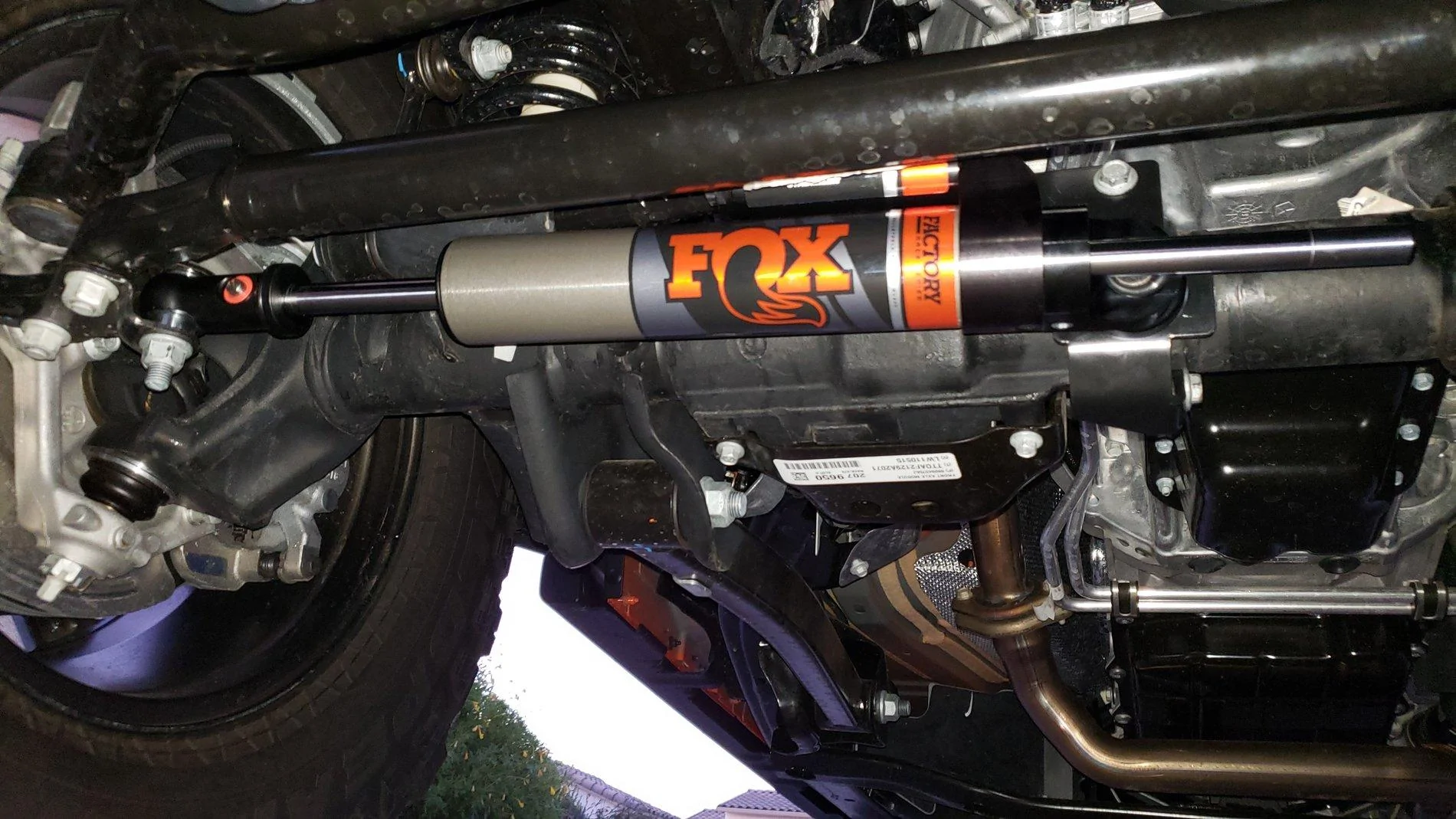

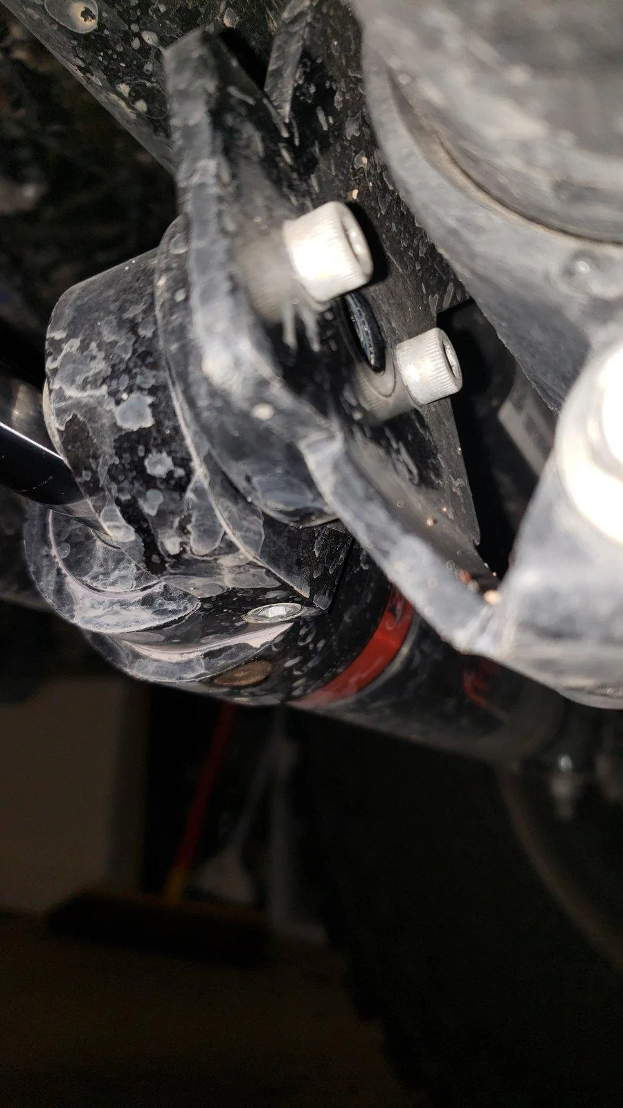

Did the circle on the circular mount fit inside the circle on the bracket? In the instructions it looks like it is supposed to but mine doesn't. You can see what I'm talking about in one of the pictures.
I don't remember exactly how the bracket fit on, i just remember it was not an unbox and bolt on process. I had to loosen the set screws to twist it to make it line up with the way the bracket needed to be installed to fit on the jeep.
@Carlton i went ahead and crawled under the jeep. It looks like it did go in there.
Thanks for the info and the pictures. You really went above and beyond. This is very helpful.
Seeing that mine does not fit, I think I may call @Northridge4x4 prior to grinding it out as should not be necessary. I don't mind grinding it out but if it doesn't work I don't want it to look like I damaged it then complained.
I think mine would not fit one way, but then turned around or over it did. I remember thinking the same thing about the hole being small, but it is a perfect fit once the bracket was on the way it goes. At first when I had it backwards it did not fit. May want to play with a bit to see about flipping it over etc. and see if there is any way it goes on. Then if all else fails replace it. I would not drill out, it is such a tight fit it may never be quite the same.
and you are welcome, glad to help.

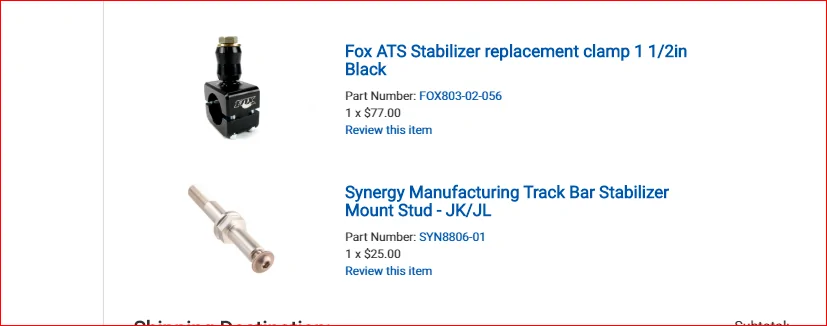

Has anyone found the bracket required form switching it from a JL axle mount to the JK style tierod end mount? I bought the JL version and did not realize it was so difficult to find the parts to convert the stabilizer.
Yes, here are the part numbers:
(Synergy tie rod)(803-02-056) 1 1/2 inch Fox Aluminum Tie Rod Mount
(Factory tie rod and Yeti) (803-02-039) 1 5/8 inch Fox Aluminum Tie Rod Mount
then you just need the Synergy track bar bolt for the other end.
Thank you so much, I just switched the bracket over and have my stabilizer back on. Fox likes red loctite almost as much as FCA does for body mount bolts.
