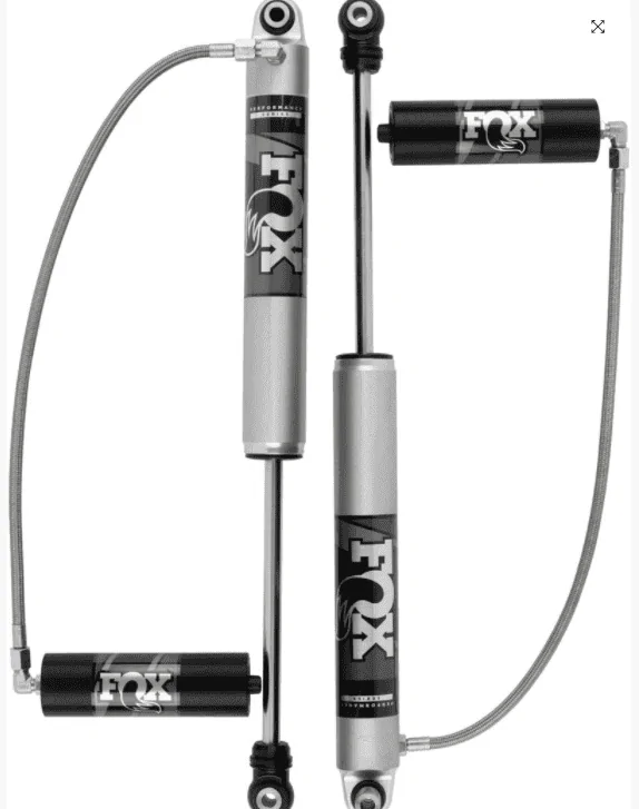

Anyone running these? I gave my Metalcloak inhouse brand shocks a couple thousand miles and it is time to move on. They are too floaty for me if that makes sense. Anyway, I havent heard much about these but the guys over at Accutune suggested these based on my budget and needs. I have Falcon 3.3's on my other Jeep and they are way too stiff for my liking. Thoughts? Fox 885-24-183 and 184

The folks at Accutune are a very safe bet for putting your trust in their hands. If you haven't already, talk to them about getting a set of those shocks custom tuned to your specific Jeeps setup.

I was considering the 2.0 RRs but ended up going with the Fox 2.5s and I cannot recommend them enough. The adjusters are very responsive and they handle everything including high speed offroading, rock crawling and daily driver duty.

The 2.5s are a great option for a more active off-roader looking for a high end shock option. For the budget conscious and someone looking for the smoothest street ride... the Fox 2.0 PS is a great option.
