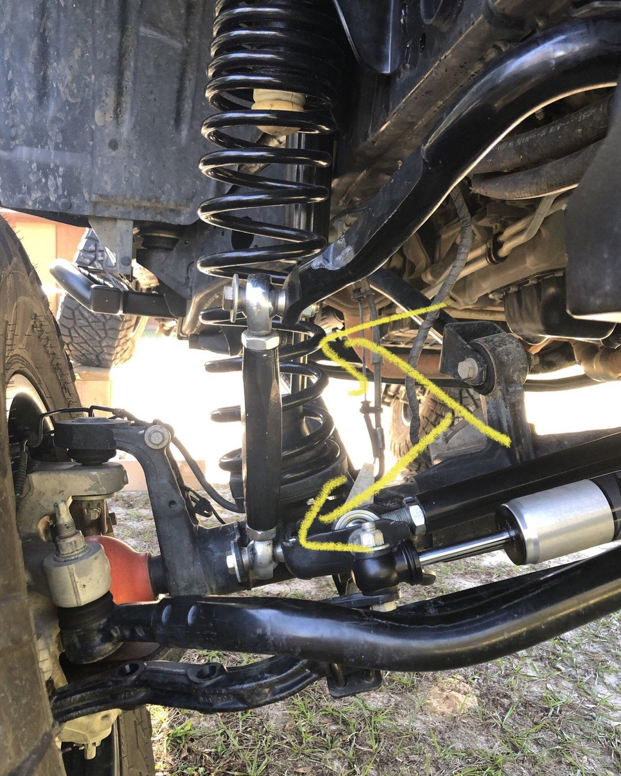

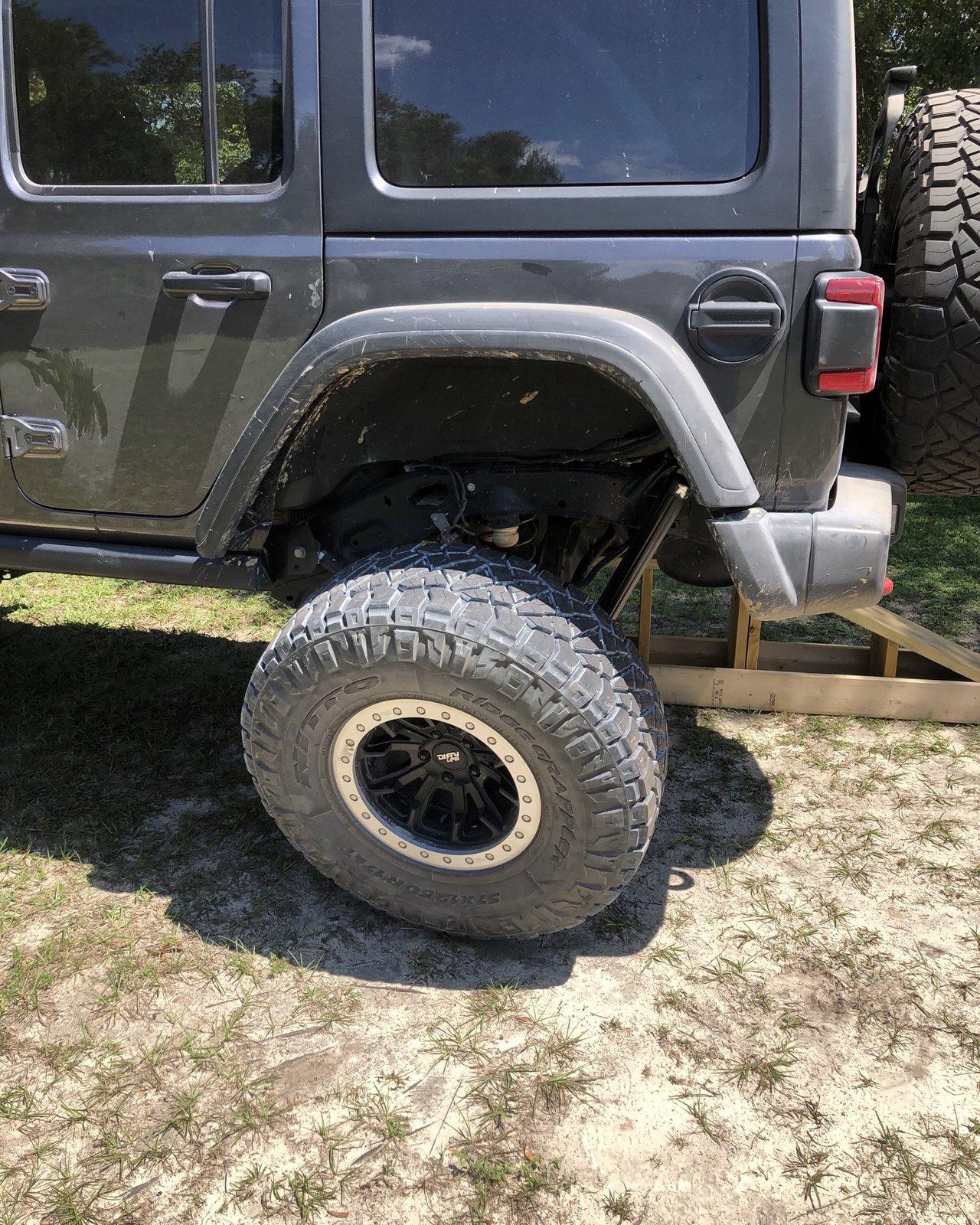

I’m sorry I didn’t know you were looking to lift your Jeep, I would have definitely let you drive mine. Maybe if y’all come back to wheel you can check out what I’ve done and drive my rig and I can explain anything you may have questions about. Here’s a couple of pics of the articulation of the rk. The metal cloak would give the same.
