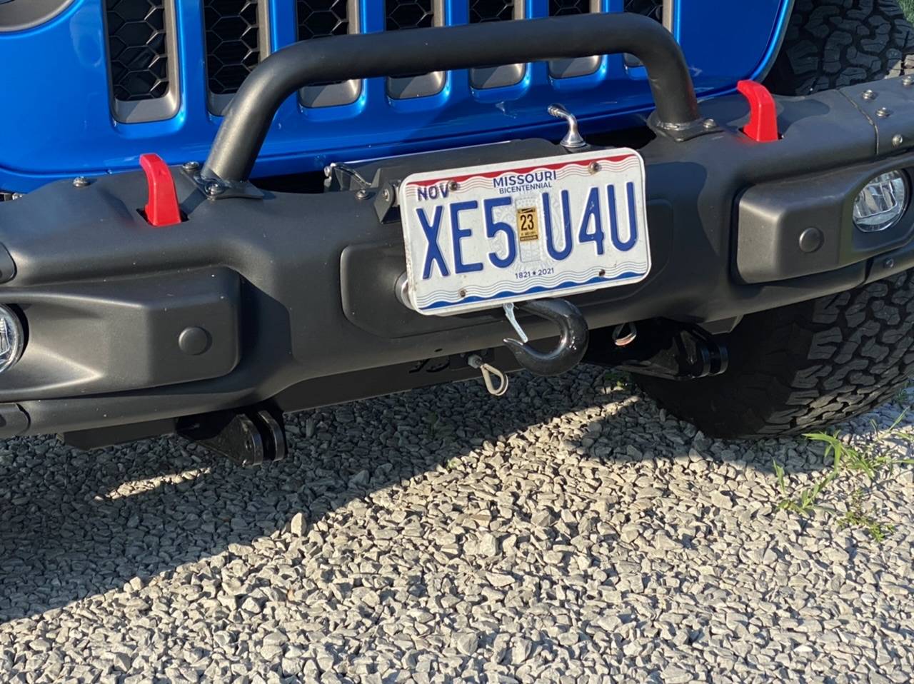

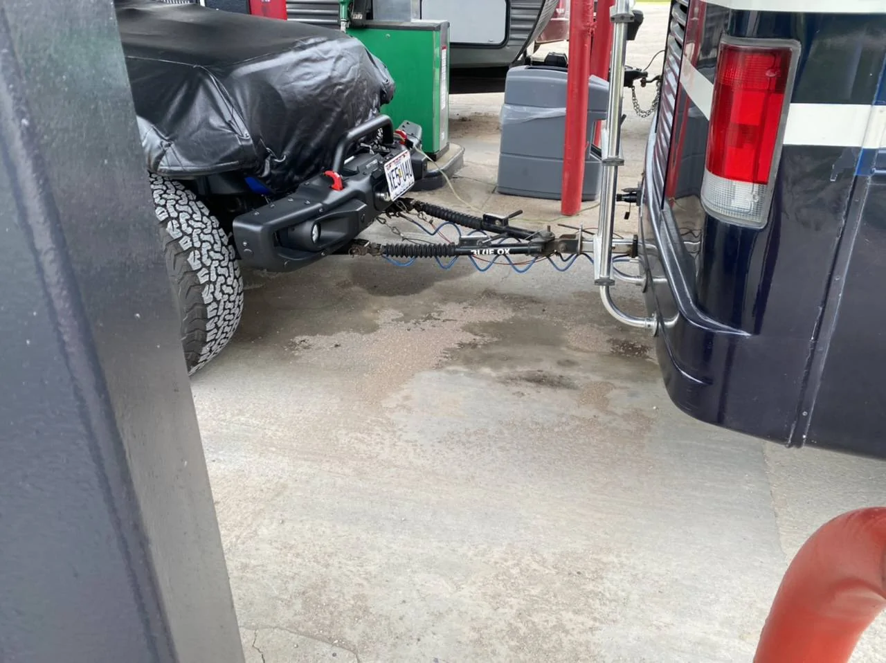

From your response, I gather it works fine. I just really want to be sure it can overcome the “non assisted” braking.
Here it is....
I have the older style autostop setup. The cable pulls straight into the bar. No arm sticking up like the newer models. Not sure how much pull length it really has.
I went out the other night to see about the jeep brakes. Pushed the pedal down several times and got all the “assist” out of the system. Of course, the pedal went way lower than normal.
When I went to start the jeep the next time, I really had to push hard to get it to accept the brake so it would start.
I guess my question would be:
To make it work correctly, would I need to leave slack in the cable (at the front bumper) to accommodate the shorter pedal travel?
Also, do I need to “bleed out” the assist before travel?
Thanks!
