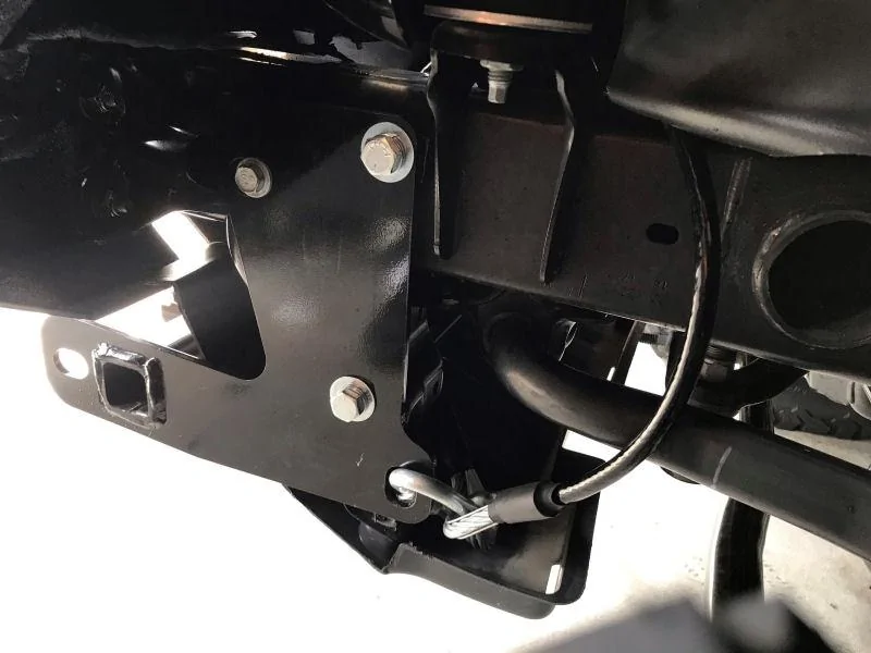

So I recently went through the same search and after serious consideration here is what I discovered and did. You are right the Rock Hard and LOD bumpers are the only ones, meaning they are the only ones willing to take on the liability risk. Mopar says DO NOT TOW FROM a bumper reason being the frame bumper connections are not designed for towing. If you remove your bumper you will see that the bumper connects to a thin (not as heavy steel as the frame) Plate that is welded to the end of the frame, while it is designed to take impacts and protect you it is not robust enough to pull the nearly 5000lb jeep (according to Mopar). In fact there is a thread here where LOD actually acknowledge's Mopar's position.
Below is the picture of the bumper attachment, as you can clearly see that plate is not very robust, Because Mopar warned me not to bumper tow I decided safety was the best policy so I installed the official Blue OX tow plate and as you can see is is only 5 inches below the lower bumper bolt. With that said the Rock Hard Bumper I ordered and then canceled after I talked to Mopar was actually slightly lower, so in reality I did not lose ANY clearance however gained peace of mind with safety and reliability which is paramount to me.
The other issue I had with the Rock Hard is the tow connection on attached to two of the 4 bumper bolts making it an even weaker unbalanced connection (pictured below
Now LOD Welds on there connection tow connection so the tow point is NOT directly connected to the frame since the tow point is independent of the bumper-frame connection.
Kook there will be several on here that say they have been towing with bumpers for a long time with no issues, however that does not negate the fact Mopar does not recommend it with the current JL frame-bumper connection method.
I wold have much rather used bumper connections however I was not willing to risk it towing a 5000lb $50K jeep behind a $180K RV, especially from the remote chance something did happen the liability would likely negate any insurance coverage since Mopar says NO.
However if Mopars position changes I will be the 1st to abandon the tow plate. Additionally I went with an Aluminum bumper to keep the front end weight down even then with winch I have about a 1" drop on the front and that is after the 3.5" lift that is supposed to eliminate the front rake.
Here is the final installation on mine as you can see I was able to re use with some cutting the stock under bumper plastic skid and have the tow connection protrude.
Note I will not be rock crawling as there is no good option for that, if you use a bumper connection you also stand to damage the any bumper.
If you plan to use the Mopar Steel bumper with winch here is the best tow connection option.
So any way you slice it, be it Bumper connection or tow plate overall the approach Clearance is about the same since the claimed towable bumpers drop so low below the frame connection.

The issue for Mopar as I understood it is not the quality of any aftermarket bumper but the connection point of the bumper to the frame which it the lightweight frame plate. that the bumper bolt to, The are designed for impacts pushing back through the bumper not the constant stress of pulling and side to side turning.
The bumper I used is the Barricade Aluminum a bargain at $499 at Extreme Terrain https://www.extremeterrain.com/barricadeoy-series-aluminum-front-bumper-2018-jl.html
The risk is great for those manufactures however they will also tell you they have not had any issues, however the simple fact Mopar does not recommend it is a HUGE liability issue. They are all small fabricators which likely do not have significant exposure.
As for the clearance if you look at how high those bumpers sit once installed compared to the tow plate there is no clearance advantage as they (LOD and Rock Hard) both hang many inches below the lower frame plate bolts the Tow plate is only 4" (ish) below the bottom frame bolt. So the clearance is about the same
