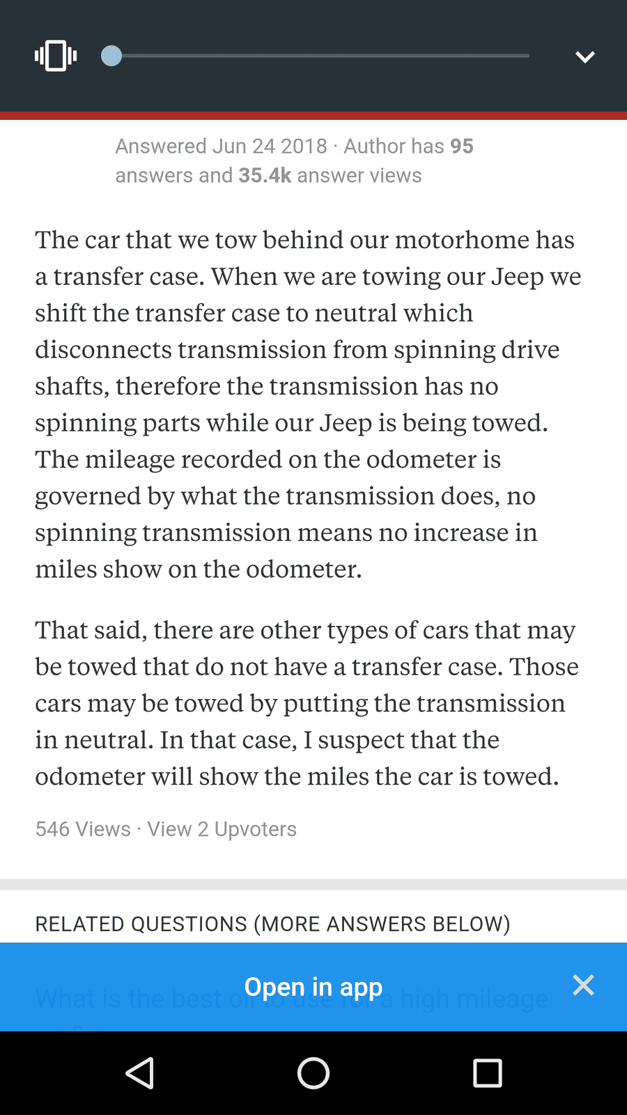

I am getting a 50/50 split on the answer to my question. I can't test this myself because I am only part way through my set up. Tow bar has arrived, e-brake has arrived. Wiring harness will be installed this week and still trying to finalize my selection for tow bar set up (3-dueces, RH Patriot, or blue ox tow plate).
Once I can tow it, I will know in about 10 miles whether or not I am having an odometer event. I guess I could find a long hill, set the emergency brake, put the 4 wheel dirve selector in neutral, the shift in park, turn off the vehicle, and then release the emergency brake.
It would be easier if I could find someone who has towed the jl 2.0 who could break the current opinion tie.
thanks in advance v/r rch

No, towed miles do not increase your odometer reading.

We flat tow ours. No mileage recorded during flat tow.
