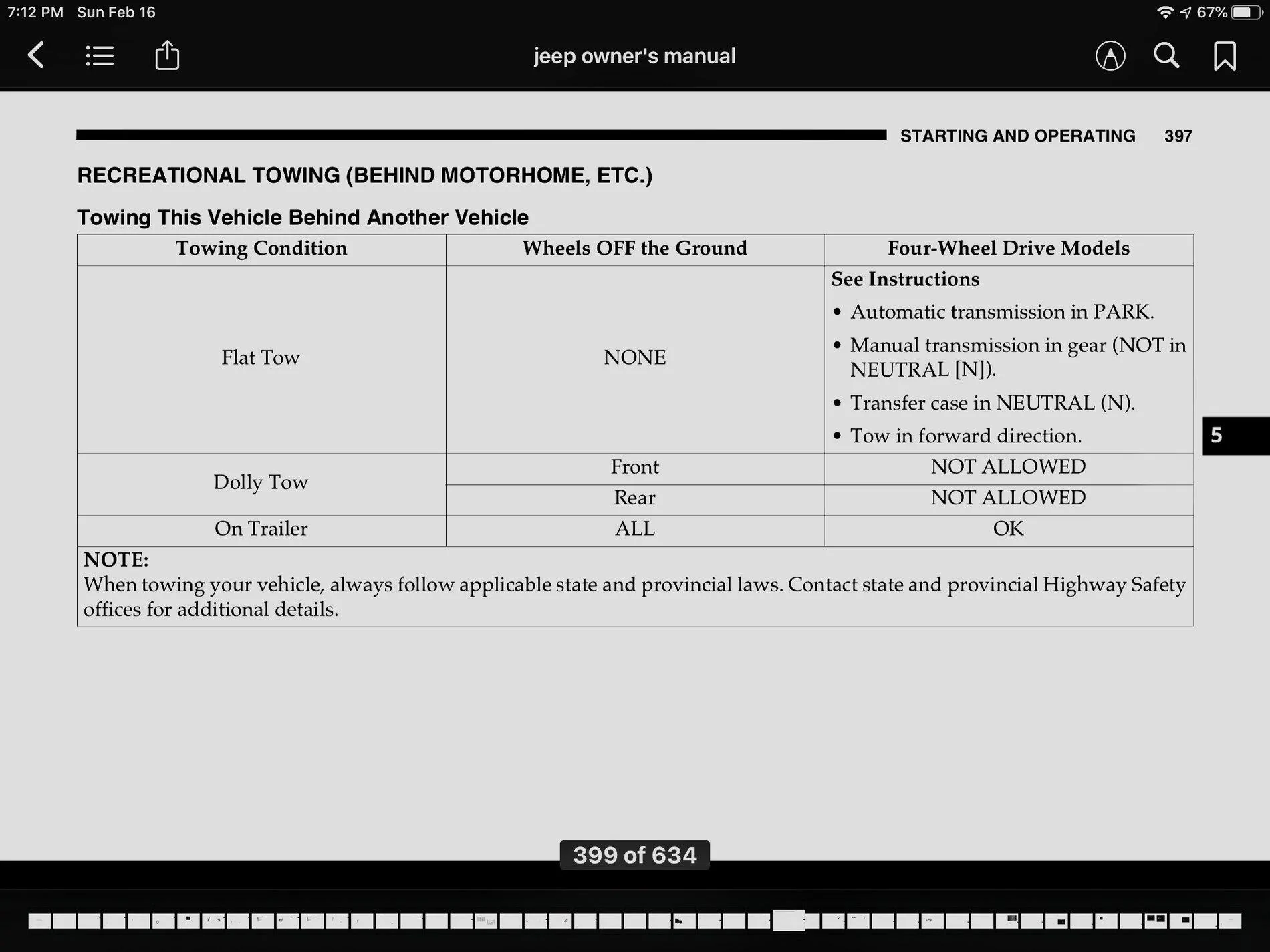

Below is FCA’s recommendation for flat towing. The problem may be how to get the transfer case into neutral. I’m not sure you can do so while the transmission is in park. If you can, then you’re golden.
