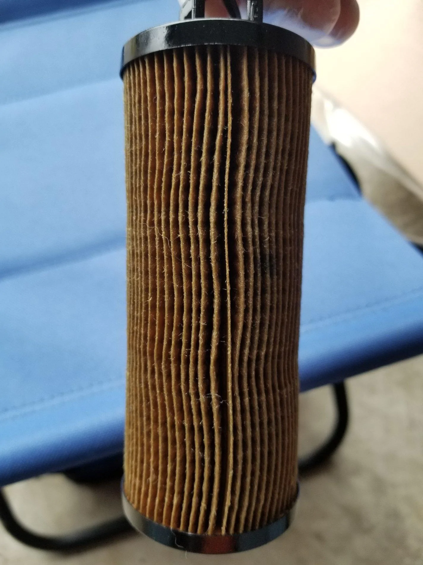

I have never seen a filter system like this. What a great looking idea! No hot oil dripping all over the place, including up my sleeve? Sign me up!
